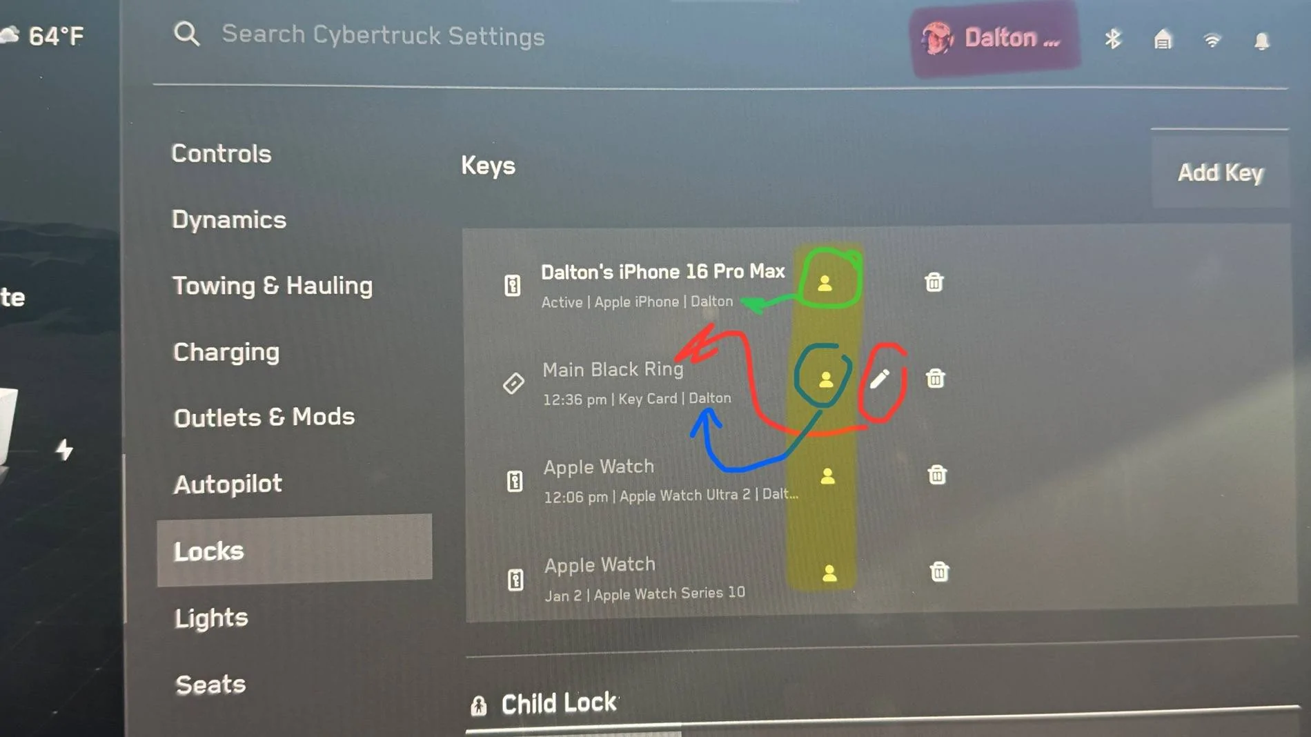

Let me see if I can try to make this a little bit simpler. What I have highlighted in pink at the top of the screen does two things: (1) it tells you which profile is active in the vehicle and (2) allows you to select between profiles (you’ll get a drop-down menu if you tap on it). [I think you already know this much.]
Then, for every key, phone or fob you have connected to your vehicle they will be listed under the ā€œLocksā€ menu and each one has a small silhouette of a human next to it. I have highlighted all of those in yellow. [This is the step I believe you’re missing.]
While the profile that you want to bind is active at the top of the screen you need to push the silhouette icon next to the key or phone or fob that you want bound to that profile. That can only be done from the locks menu not the profile select button at the top of the screen.
Is this making sense?
Dalton, makes perfect sense and it worked. Thank you so much for your patience with me. I love the truck, but at my age "change" is sometimes difficult to accommodate. Again, much thanks and safe travels. PS: Your knowledge of the truck makes me think you had something to do with its design :)
