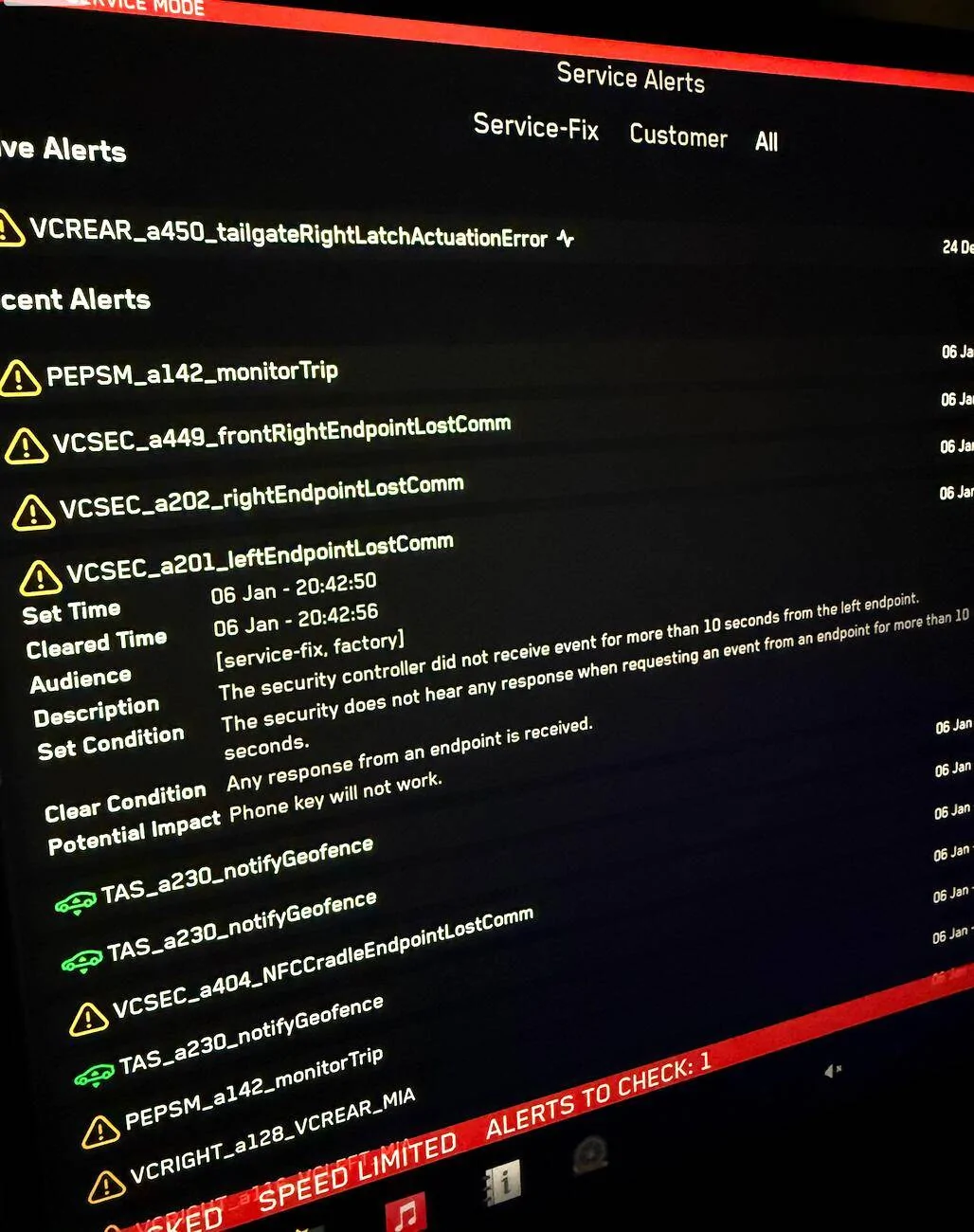

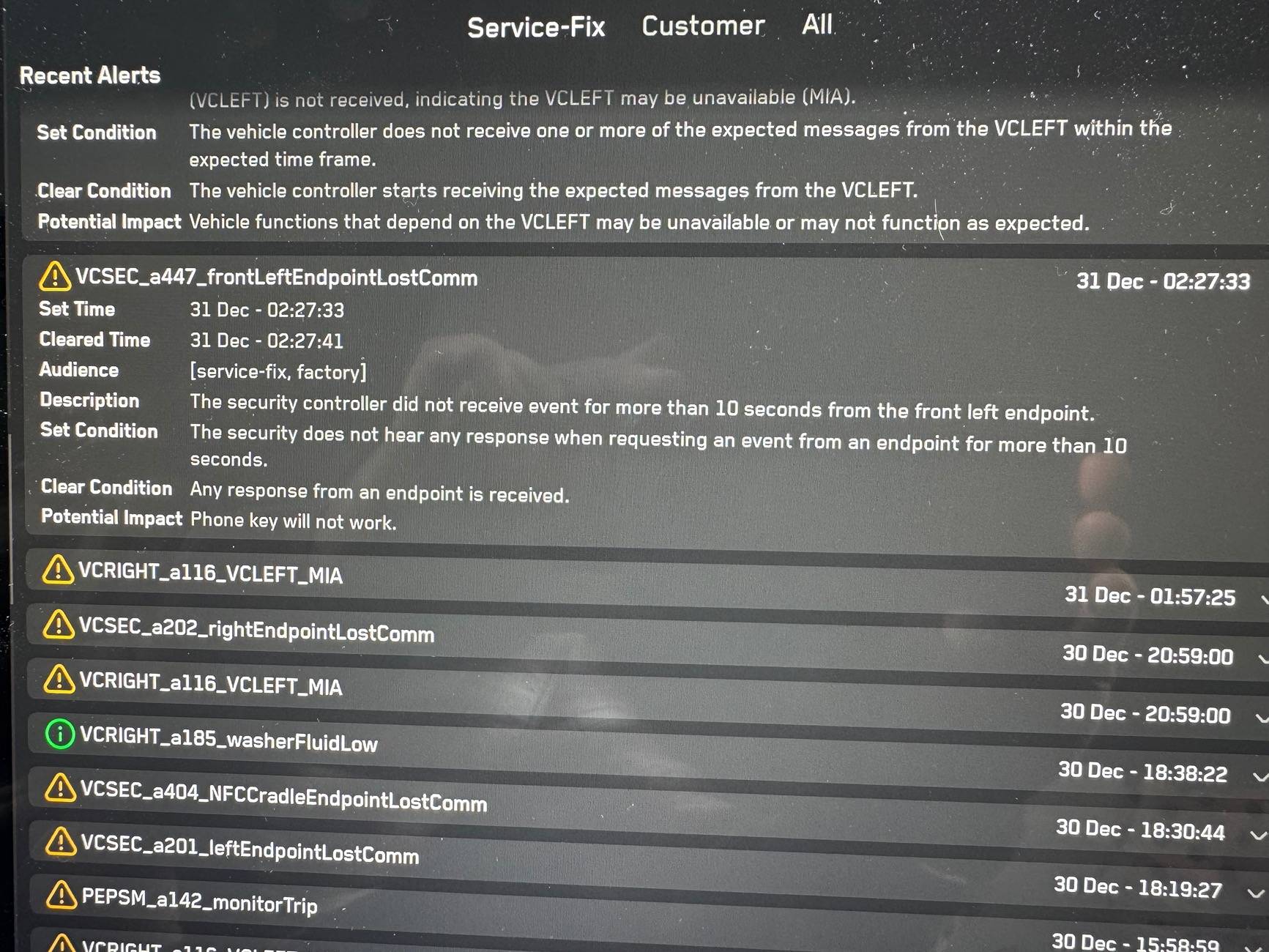

Well, I thought this was interesting. Apparently we might have an explanation for the phone not unlocking my truck:
VCSEC_a447_frontLeftEndpointLostComm
Potential Impact Phone key will not work.
Interesting. Same error here. An update: My Cybertruck is very close to my bedroom (8-10ft) and the problem started when I updarted from Iphone14->16. I think it has to do with weak BLE "long distance" connections. I think it can be fixed with software -- the Cybertruck BLE receivers are too sensitive.
Is your vehicle also in close proximity to your Iphone?

I have iPhone 15 and no issues for the 3 months before the Xmas update. And just that one time I had an issue. But, I have a large parking area and the truck gets parked in various spots. But, I have to admit the spot closest to my house is the one in which I had the issue, not seen the issue before or after in that spot. Certainly in the 10ft range of my bedroom.
When I read the error code I’m reading it as the truck’s left endpoint is not responding to the truck’s central unit. If I’m right a new software change likely caused a timing issue, and it’ll get fixed at some point. Timing issue would randomly disable the phone detection, causing it to ignore the phone sometimes for short periods. Could be a previous issue too, and I just got lucky with the timing
if my phone ever fails to be detected, I’ll wait a little before reaching for my keycard next time. That’ll prove/disprove my theory I suppose.
