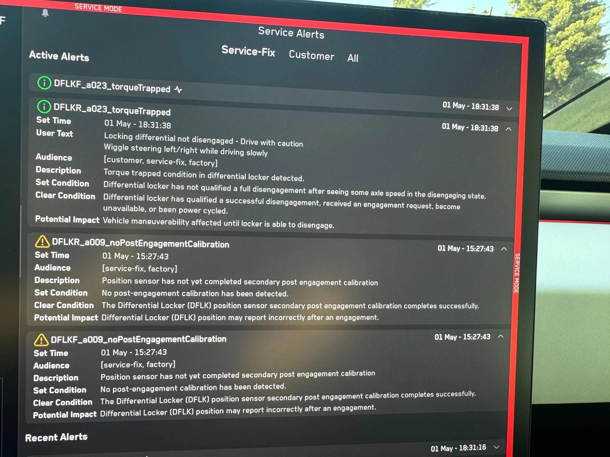

Just so ur aware, the diff were not calibrated. That is y they would not disengage. It would have been nice if they didn’t engage in the 1st place, instead of getting stuck engaged.
Pic of the errors.
Tesla Cybertruck Locking Diff stuck after 24.14.3 update IMG_8121
Speedr
Dec 17, 2023
653
1,367
Dual Motor Cybertruck
Pic of the errors.
@Tony stank , what do you do for this? Do you need to take it into service to get calibrated?

I didn't have any problems engaging. They did stay engaged longer than I thought they would but I was on sand and not asphalt. A few minutes of going back and forth and they disengaged for me. Having spent a long time off-roading in a variety of vehicles and having many vehicles stuck in 4 low I figured there was a process for disengaging the lockers and that seems to have been correct. I am not sure exactly what it was but I spent some time switching between park, forward, and reverse several times and they eventually disengaged. Don't engage them on any solid surfaces as a test, make sure you are on dirt, sand, or gravel.

I'm getting this issue too but I wonder if its just the sensor and the diffs aren't actually engaged. It goes on and off intermittently and I haven't seen any evidence of the lockers actually being engaged despite driving exclusively on hard surfaces since I picked up the CT on Tuesday. No skid marks, no sound of tires skidding on sharp turns etc.
