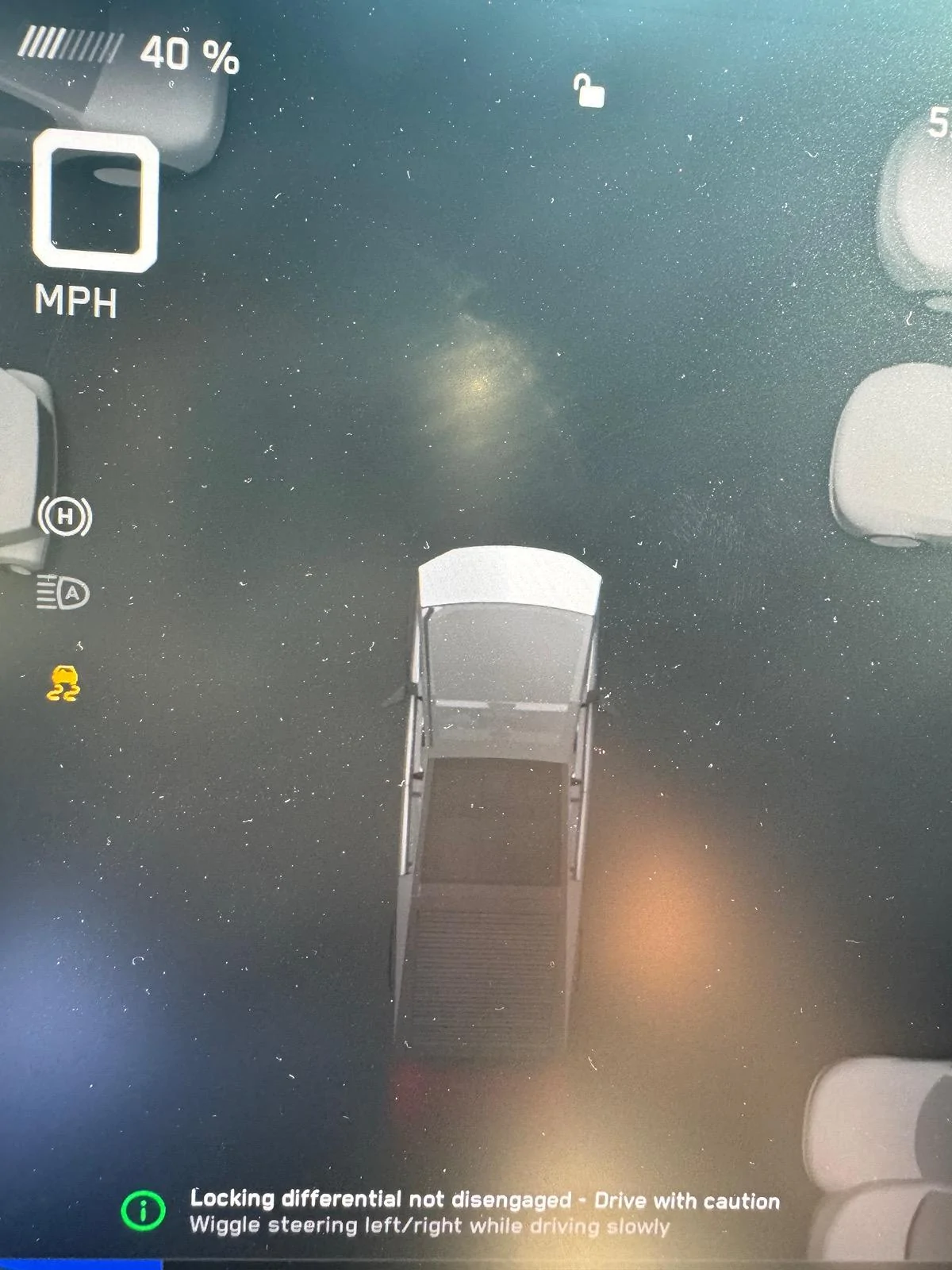

S,3,Y,CT,CT(holding pattern) Slate is back on
If one thinks it is not locked and it is throwing errors try driving in full circles not like crazy, but if possible on dirt about 5 or 6 times. Should make it see that it is unlocked. From experience. I do dirty tesla things, yet someone else has the name.

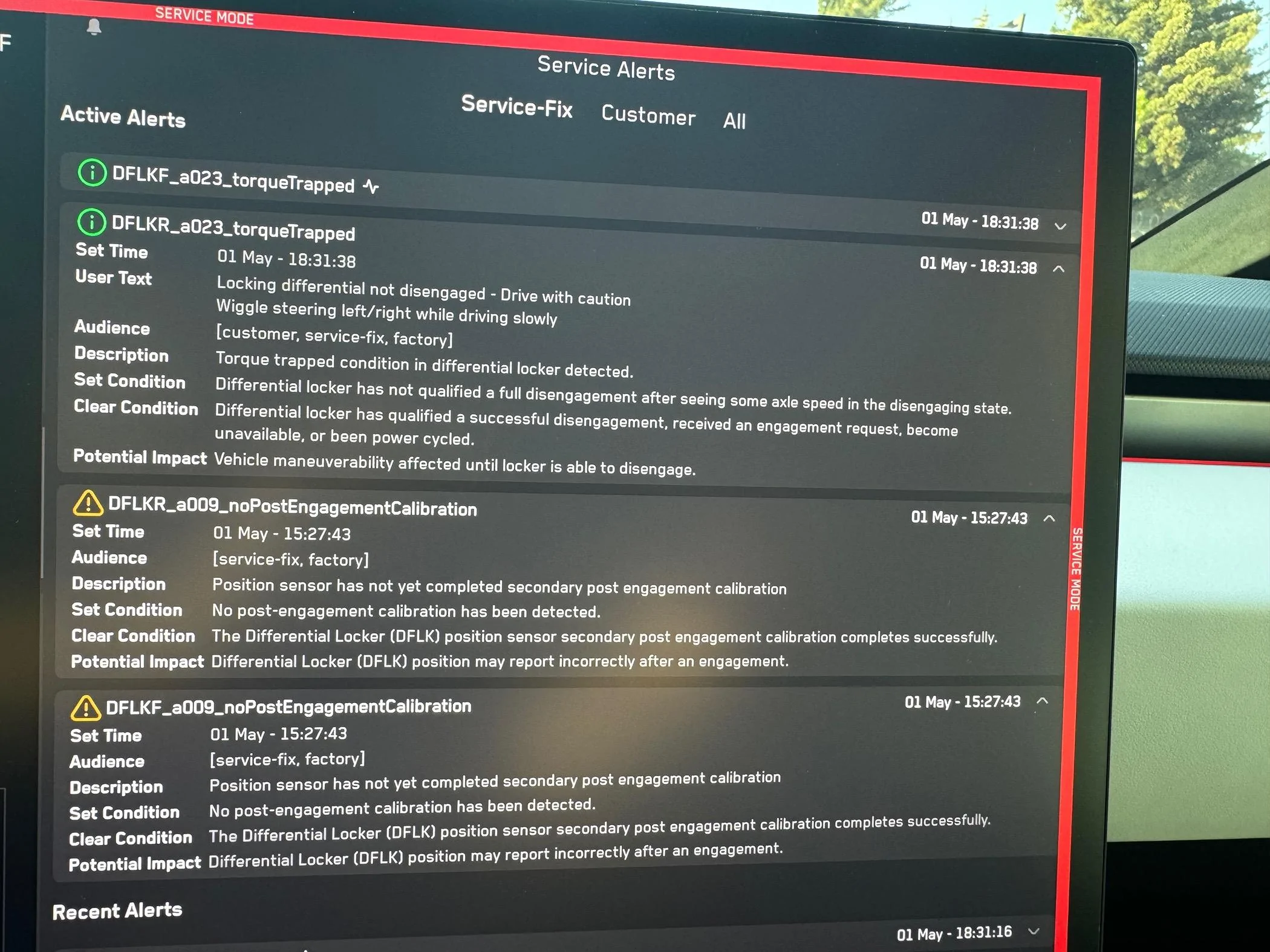

yea it’s dropped off over at service. They will take a look today and let me know.
Just got my truck back. Air suspension hose wasn't installed in Voss fittings securely.
But I went into service mode and see that I do have the no post engagement calibration alerts. Does everyone have them initially? Does it calibrate under normal driving, or do the diffs need to be locked and unlocked for the calibration to occur?

It will calibrate on its own over time. Mine cleared up on its own after about 3000 miles
I have these alerts for no post engagement calibration. Does everyone? Are you saying they calibrate during normal driving, or with several diff unlocking?

Hello- I have had it in service twice for this. The first time they said it’s a calibration issue, they kept a few days and it happened to just stop giving the error after the software update while it was in service. We had it a couple days and it started again (with a new graphic showing how to wiggle to disengage). It has been in service over a week now-it hasn’t moved from its parking spot after they advised it was on hold waiting to get direction of what to do until yesterday they messaged and said they are replacing the drive unit. I am going to ask they give me a call to discuss versus the chat-can you all give some advice on if I should question their decision or if you found resolution that wasn’t mechanical? I assume they have indication that it is a mechanical issue however the truck drives fine during the error, it goes away shortly after we start driving after a stop and we never locked the differential in the first place but have used extract. I am apprehensive about it being worked on at that level, especially since every time it’s in they mention how they aren’t experienced or trained in CT they are learning as they come in. Thanks!
Man, I feel you ur pain. Mine was in the shop about 50% of the time for so many issues. The worse is when it just sat outside for days with no one working on it.
I got fed up with it and just sold it for cost a few weeks ago.
