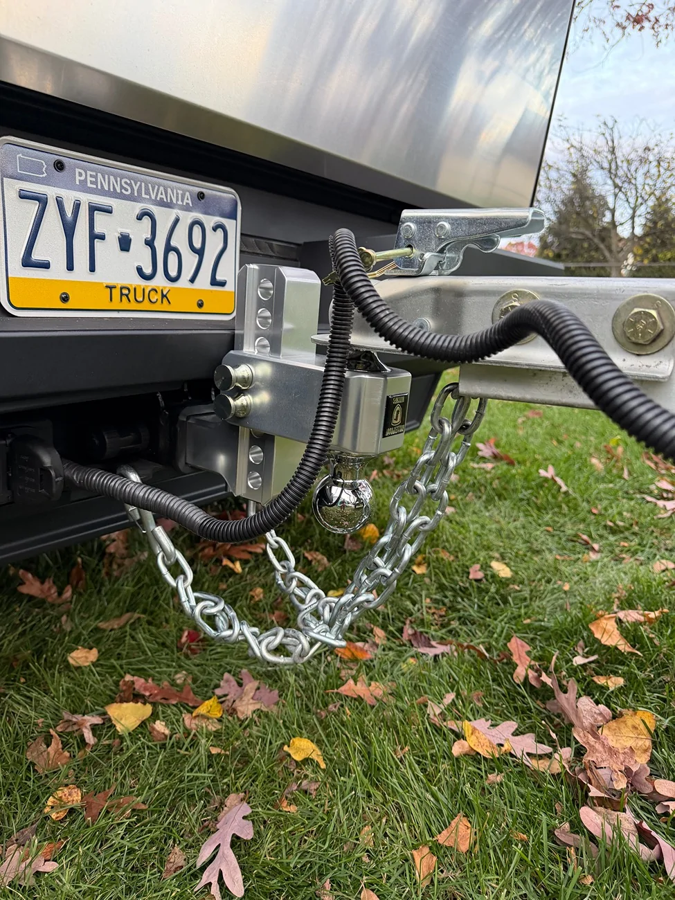

RonSol
Ron
Feb 19, 2020
196
592
Archbald PA
MY LR / CT / 3P
Systems Engineer
Needed a new adjustable for different trailers.
Very happy with this one from Bulletproof Hitches.

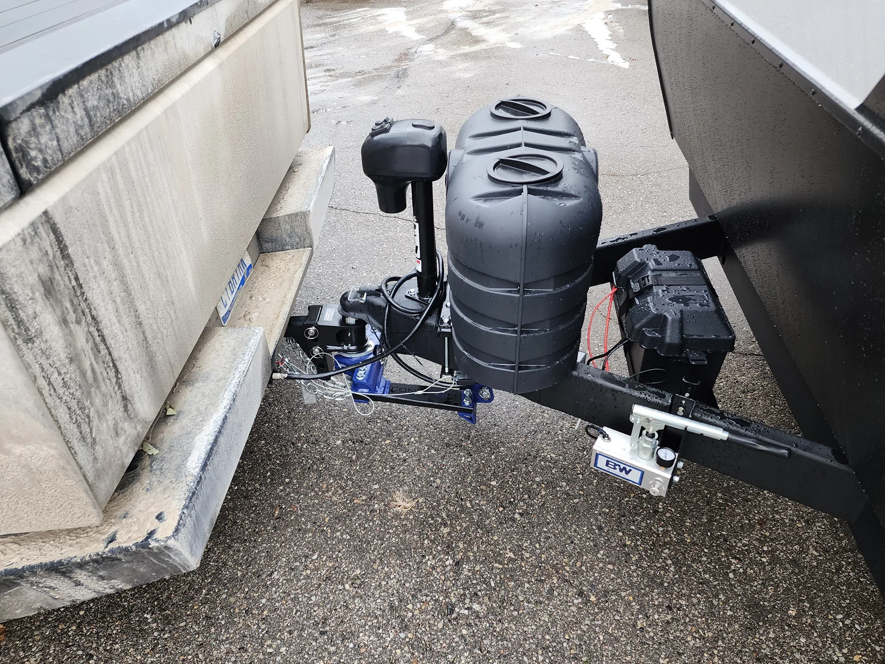

May 27, 2024
4,549
5,537
Trailer came with Blue Ox, but I switched to B&W Continuum for easier connecting/ disconnecting and adjustability. It works well, but does bottom out slightly on our steep driveway approach... and I just realized I could raise the suspension before turning in...

Truck only

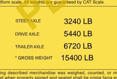

Tesla Cybertruck Looking for trailer hitch for CT... Share pics of your TH AISelect_20251226_120718_Adobe Acrobat
With trailer 274RKW, no WD
Tesla Cybertruck Looking for trailer hitch for CT... Share pics of your TH AISelect_20251226_120550_Gallery
With weight distributing

aadams1278
Andy
Dec 11, 2023
80
76
Wilson, NC
Model 3, Model Y
Pilot
Is that hitch able to be raised to any of the higher positions than shown here? It looks like the bumper would be in the way, or is there more clearance than there appears to be in the photo?
