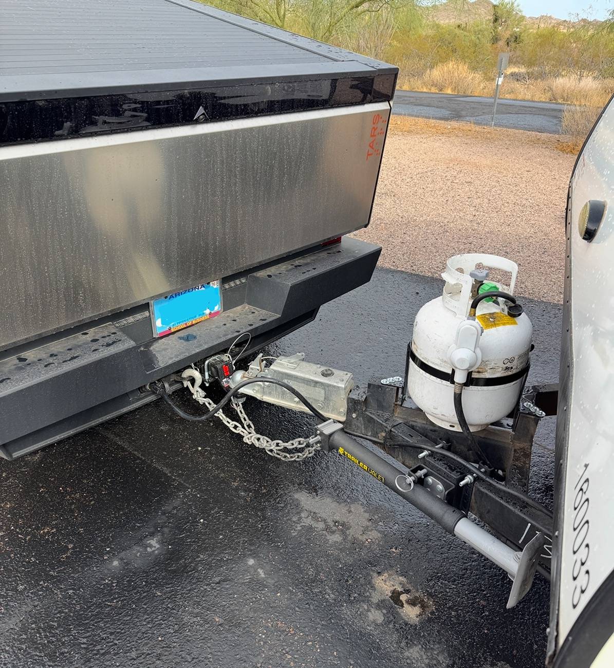

Had to help a buddy tow a 34 foot travel trailer this past weekend. He had a specific brand of weight distribution hitch since the trailer weighs 9k lbs. We had to order a 2 inch shank so it would fit the 2 inch receiver on the cybertruck. We flipped it upside down to meet the appropriate trailer hitch height with the cybertruck at medium suspension height. Worked great to tow 250 miles on the interstate. You'll want to size it to your trailer's weight and make sure the ball fits (some trailers use a 2in ball, larger trailers are 2-5/16" hitch balls). Here's what that hitch system looks like if you wanted to buy on its own, but most travel trailers will already come with one: https://www.equalizerhitch.com/products/equal-i-zer-hitch/

My favorite is the shocker air hitch. It has a pivot point and stops the truck from yanking backwards/forwards whenever the trailer hits a bump. It's a night and day difference to reduce stresses on the tow vehicle and make the truck ride more comfortable. You otherwise get shook quite a bit with large trailers when driving over bumpy sections of interstate. Also helps a bunch when offroad towing on bumpy trails. I've towed up dirt/gravel trails in the mountains using this hitch last year with my X. On Cybertruck I had to cut out a square section of the underside of the bumper because the airbag was coming into contact. This is the exact hitch I got - it's rated for 20k lbs. I got the options for "fits 2in hitch" and "raised and sway tabs with 2" ball" https://shockerhitch.com/product/sh..._ball-mount-options=black-combo-22-5-16-balls
