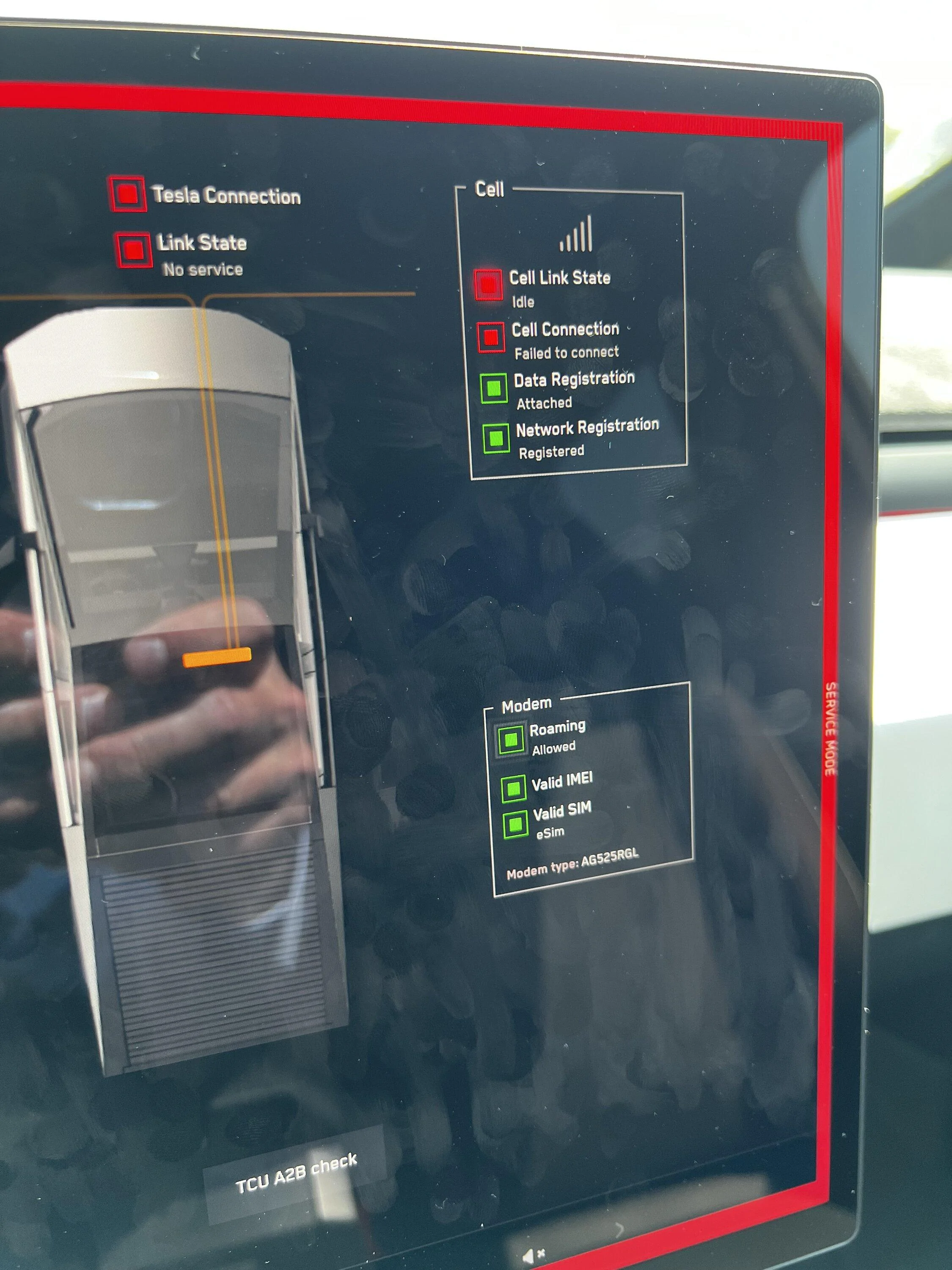

I lost cellular connectivity today while driving. Have done all sorts of reboots and power cycles to no avail. Even looked at the service menu and saw this. Any ideas on how to fix?

Connected to my WiFi hotspot on my phone and downloaded 2024.20.9 which seemed to fix it.
