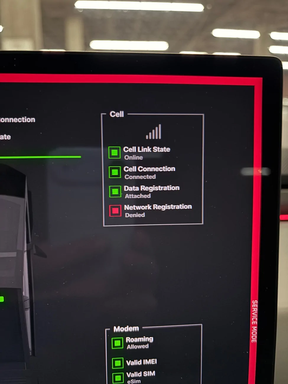

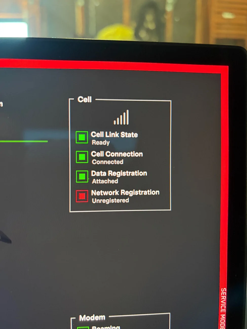

Mine was out for 3 days a month ago, i put in a service request and it started working again 24 hours later. Two days ago it did it again, still out right now. I put in a service request again, which is 2 weeks out. I have tried the scroll wheel and power off, neither fix it. I went into service menu and Network registration was red and shows denied, when I do a modem reset it goes green, but cell link state and cell connection stay red. I checked later again and the network registration went red again.

Wow. Those errors are concerning. I'm wondering if i should also go into the service center so this issue gets logged. I would venture to guess my screen looks very similar. The fact that it comes and goes is getting borderline maddening because when I need it most, it seems to cut out. The service center tends to not want to work on my issues unless they can verify themselves (as if I'm mentally deranged and making things up and want to spend my time in a service center!) so i keep waiting for it to cut out long enough to make an appt.
Thanks for sharing those screens!

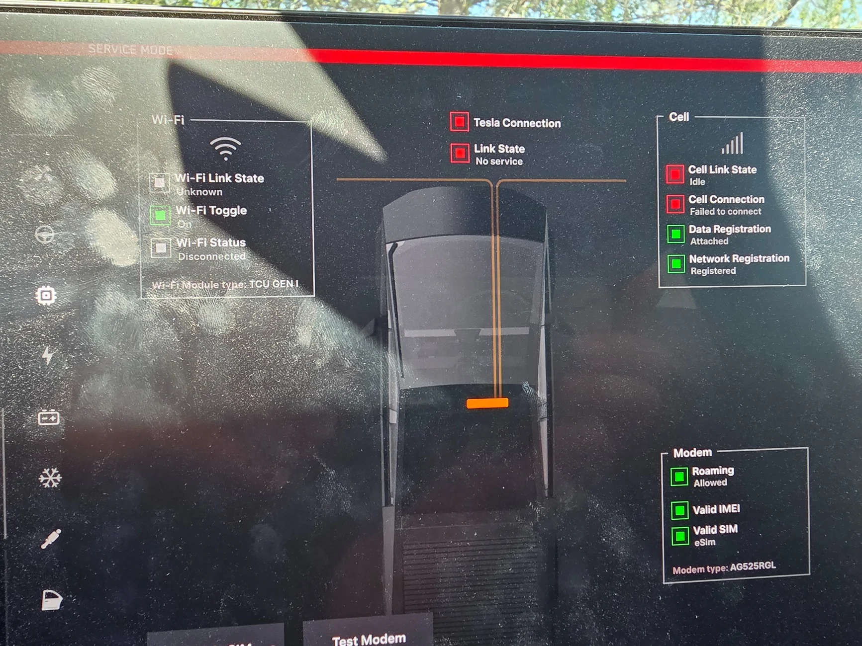

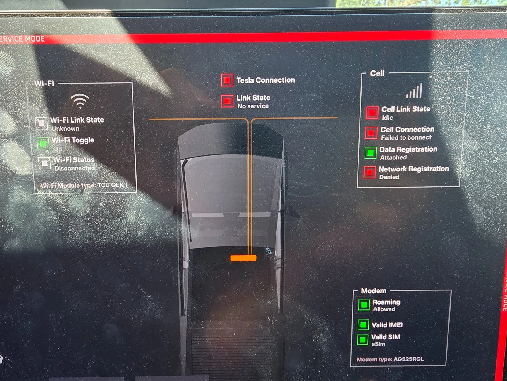

My 24 FS AWD is still losing connectivity. I’ve rebooted, powered off, and reset the modem in Service Mode.
I’ll get LTE for a bit, then back to one-bar 3G and red boxes in SM
I’ve got a service visit for Monday 06/01.
