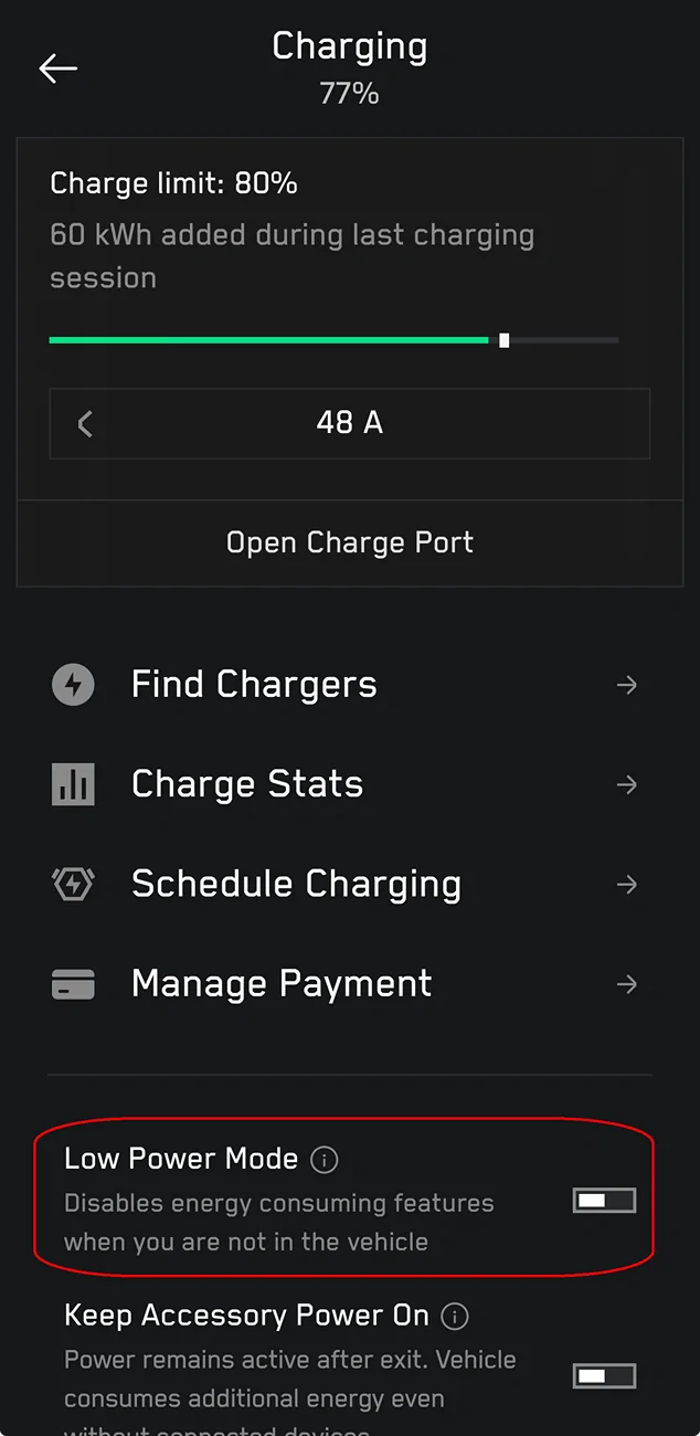

In the app, go to Charging, there is a Low Power Mode toggle.

In the app, it's under Charging:
Tesla Cybertruck Low power mode from app Screenshot 2025-12-20 at 7.10.19 PM

In my experience, low power mode is very effective, I'd be surprised if you lost more than a percent or two over several days at most.
Just make sure you don't keep checking your app for updates constantly, every time you refresh the vehicle status you wake it up and it uses energy.
It’s OK to open the app, as long as you don’t tap on the truck or mess with any of the settings.
It should show the status as “Low-Power Mode” or “Sleeping for XX Hours/Days”, if it shows “Parked” then it is awake. It should go to sleep within a few minutes.
I used Low-Power mode for a couple of weeks, and lost maybe 1% every 3 days or so.
