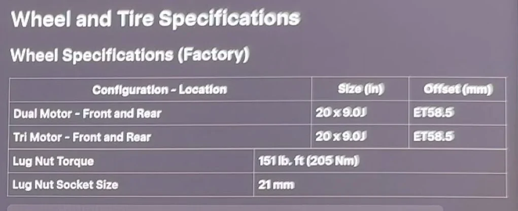

For future search reference:
Lug nut torque specs: 151 ft-lbs
Lug nut socket size: 21 mm
Tesla Cybertruck Lug Nut Torque Spec = 151 ft-lbs GD6xTy6XcAAL-gT (1)

FYI 151 ft-lbs is a LOT of torque if you are used to driving regular sedans 80 ft-lbs.
7,153
13,769
The tightening torque for the wheel lug nuts on a Lightning for ICE F150 is 150 ftâ‹…lbf, going back to the 10th Gen (1990s)
F250s are 165, F450s are 150
just putting into context that 151 is pretty standard truck spec, and also clarifying that there’s nothing BEV specific about it
My experience is with Toyota trucks, depending on the alloy of the wheel Toyotas specs range from 98-154lb if I recall correctly (Tundra and Tacoma)
I should expand on this a little further.
Aluminum rims required the bottom end of torque and steelies required the top end of torque.
My surprise is the assumption that the premium Cybertruck rims are aluminum and still require that high of torque.
OTOH if you're used to doing wheel stuff on model S/3/X/Y, it's not going to feel that much harder than 129 ft-lbs on the torque wrench.
