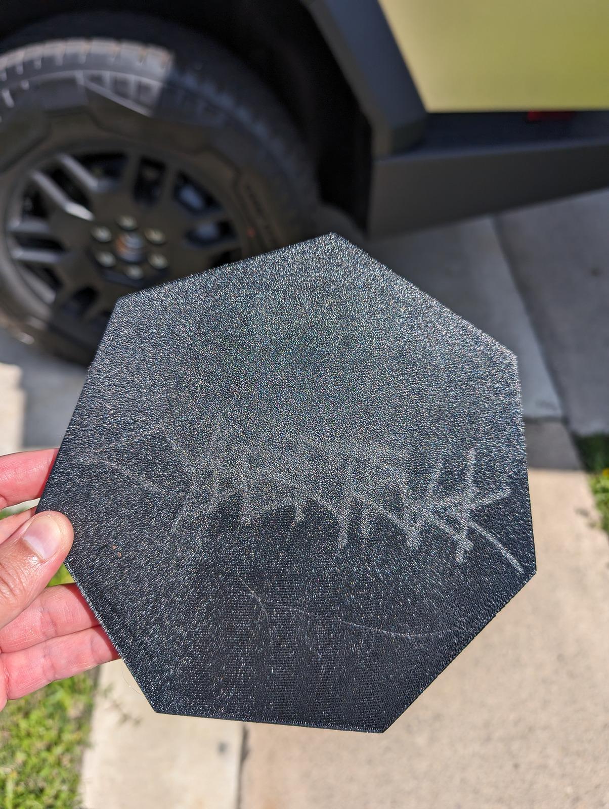

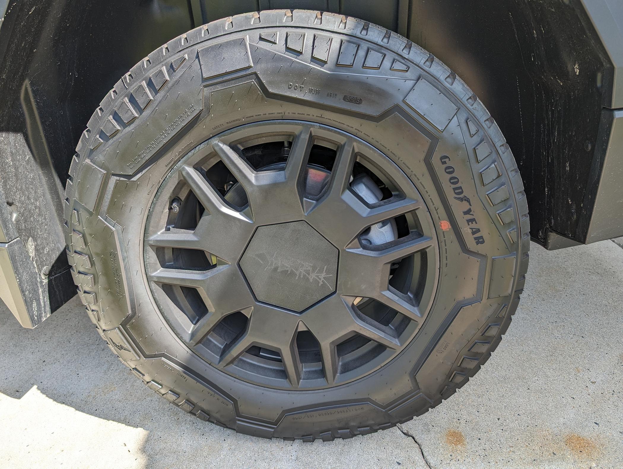

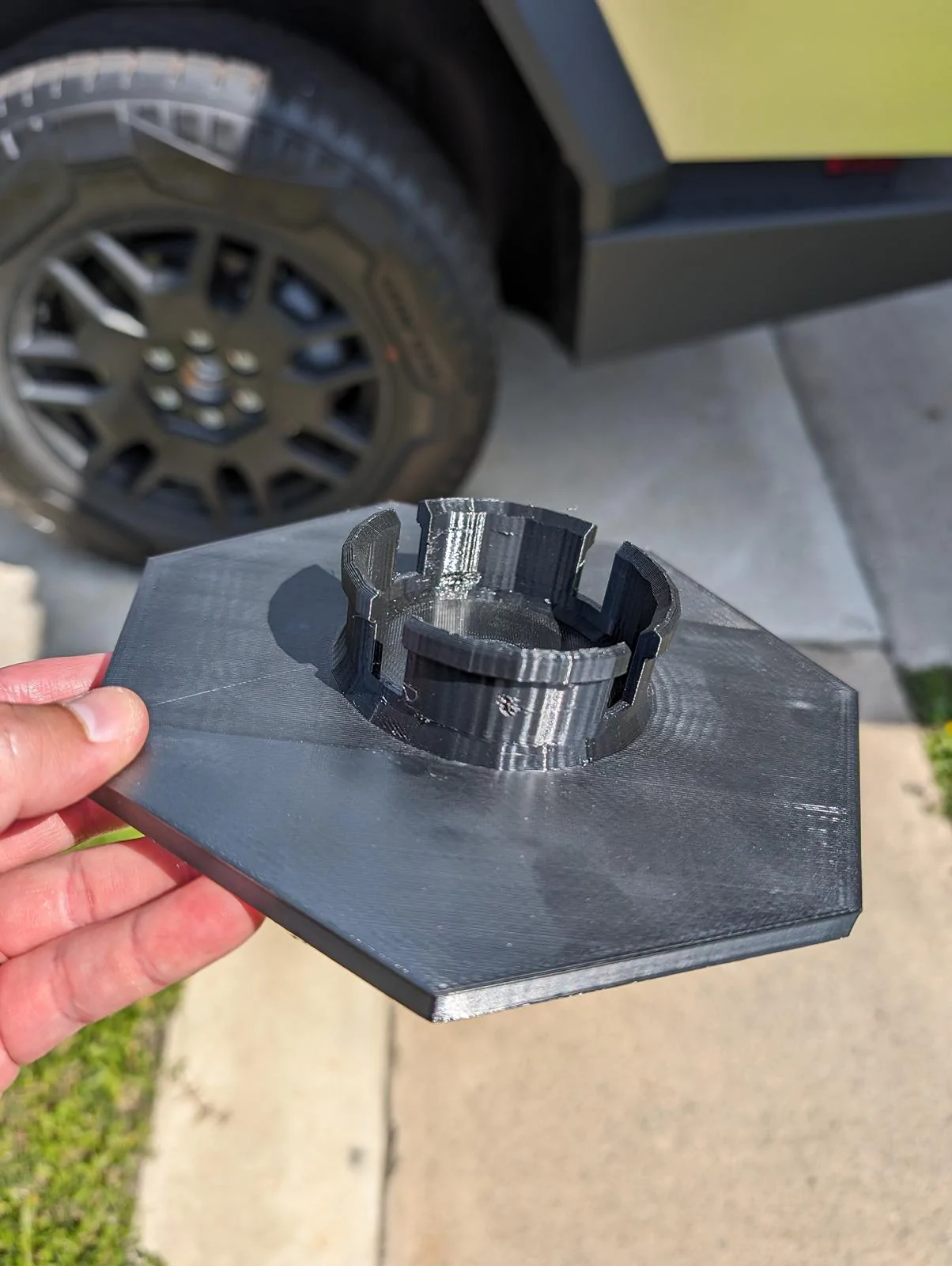

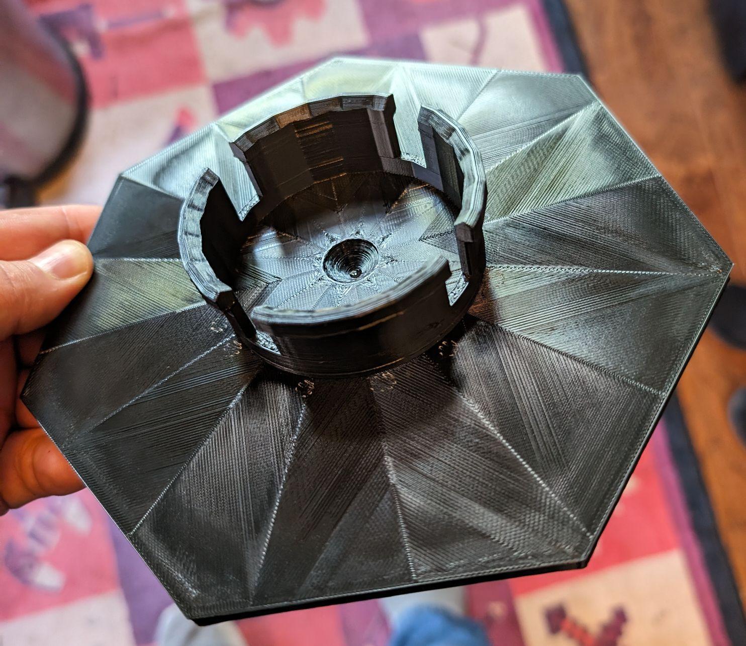

Thanks for sharing! I printed it out in PETG and seems to fit really well. Obviously I gotta clean my build plate and dial in the next ones better. Think I'll try without supports too.

That looks good! It looks like the face of the model needs to be cleaned up on my end. I've fixed it, and uploaded a v2 to the sites. PETG is not UV resistant so it could fade in the sun, but its got good heat resistance.
Let us know how it goes without supports.

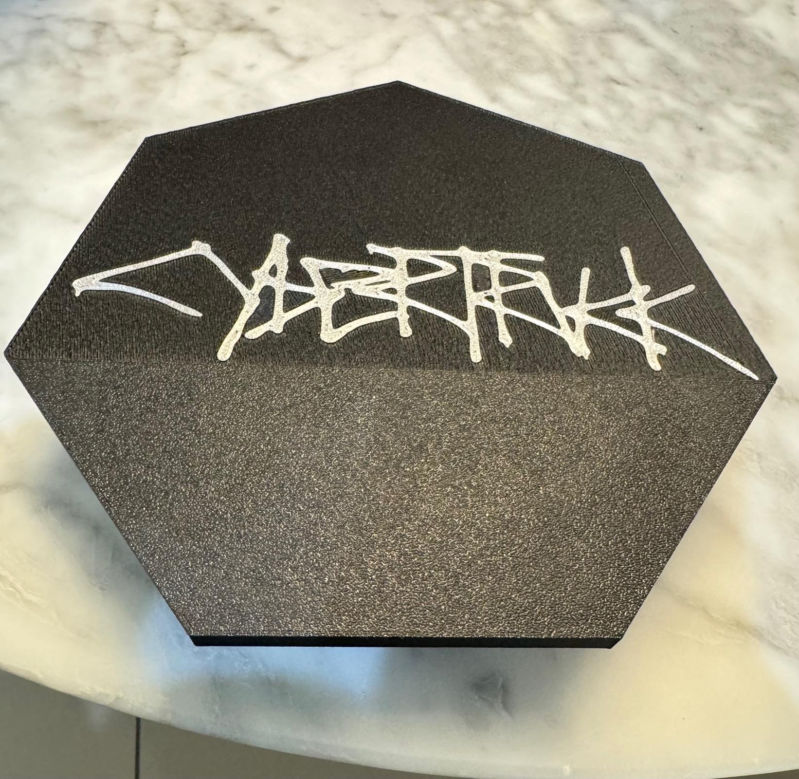

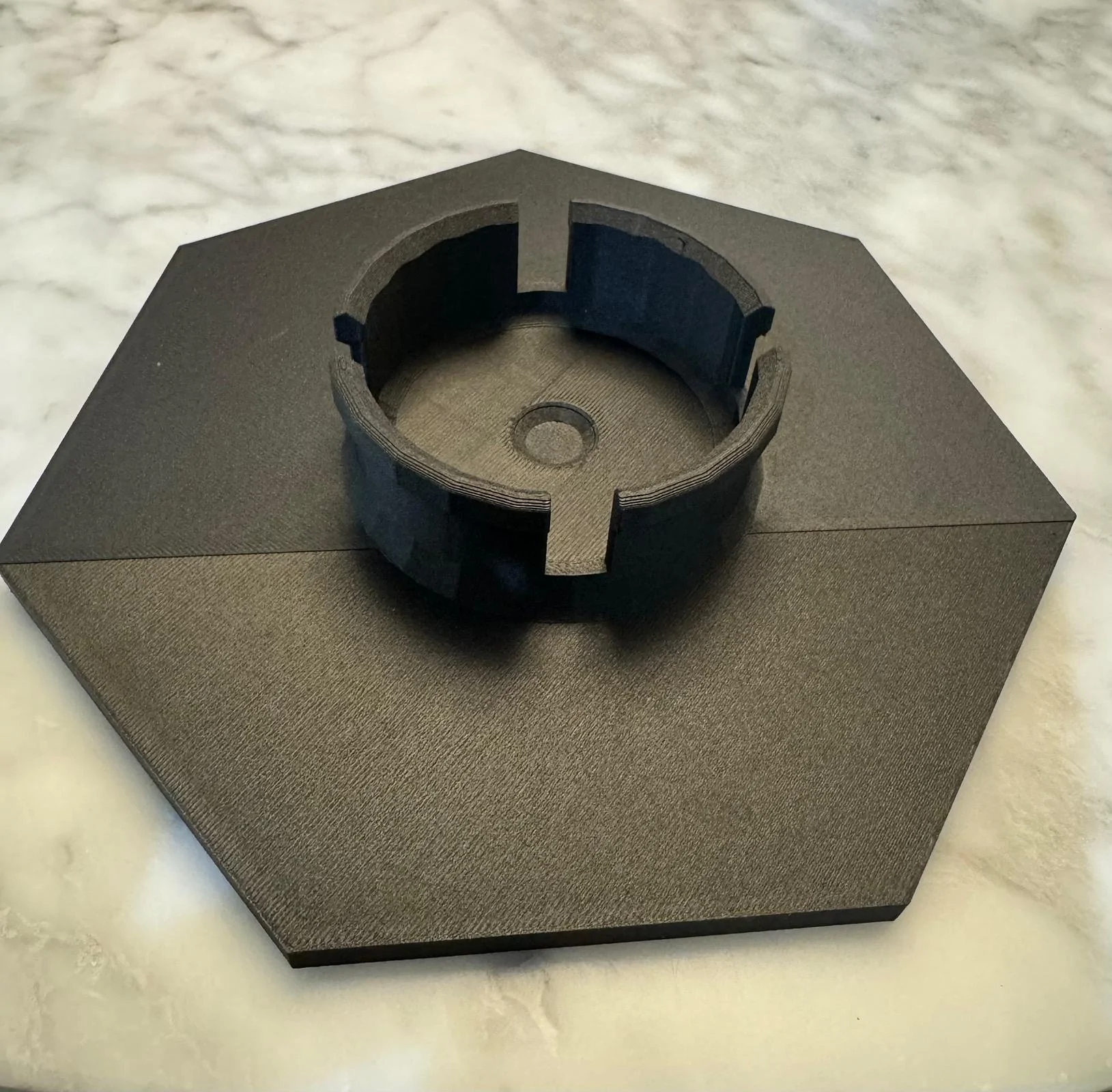

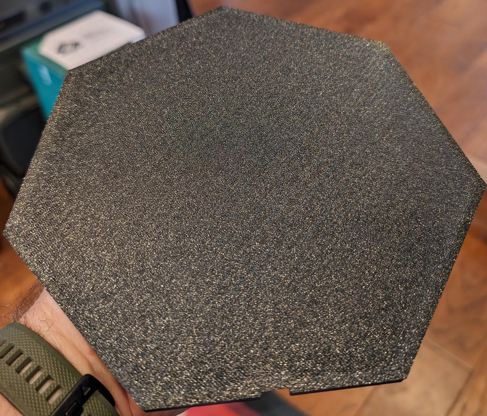

Thanks for doing this great work. You did a really nice job, I had used your V1 and I liked the cybertruck logo, i colored it silver, but this seemed to have its own layer and not embedded in the first layer, so on my print it created a canter lever.. which made the first layer offset and created this line
BTW I used PETG CF on the X1C
can you fix it?

I'm sorry, it does seem that something is off with that print. When I realized what had happened with v1, I replaced it with the v2 version quickly.
I'm providing a clean slate for people to put whatever they want on it.

Thanks I saw that, i have to figure out how to add a logo. Thanks for sharing

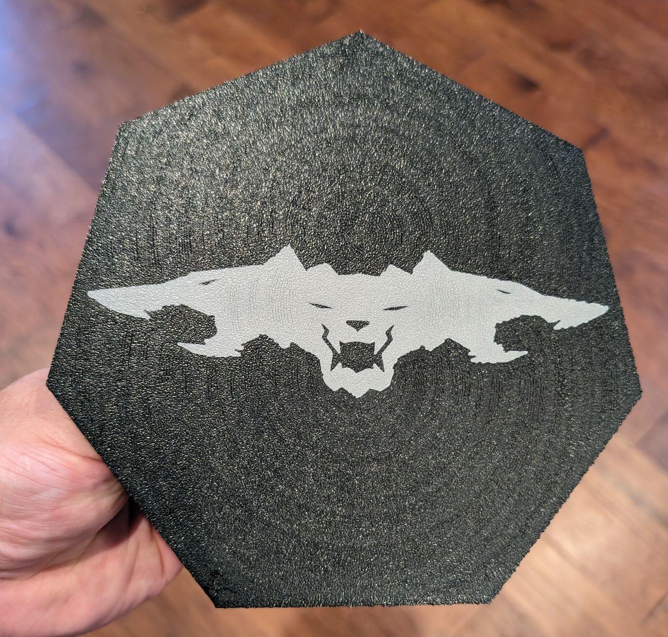

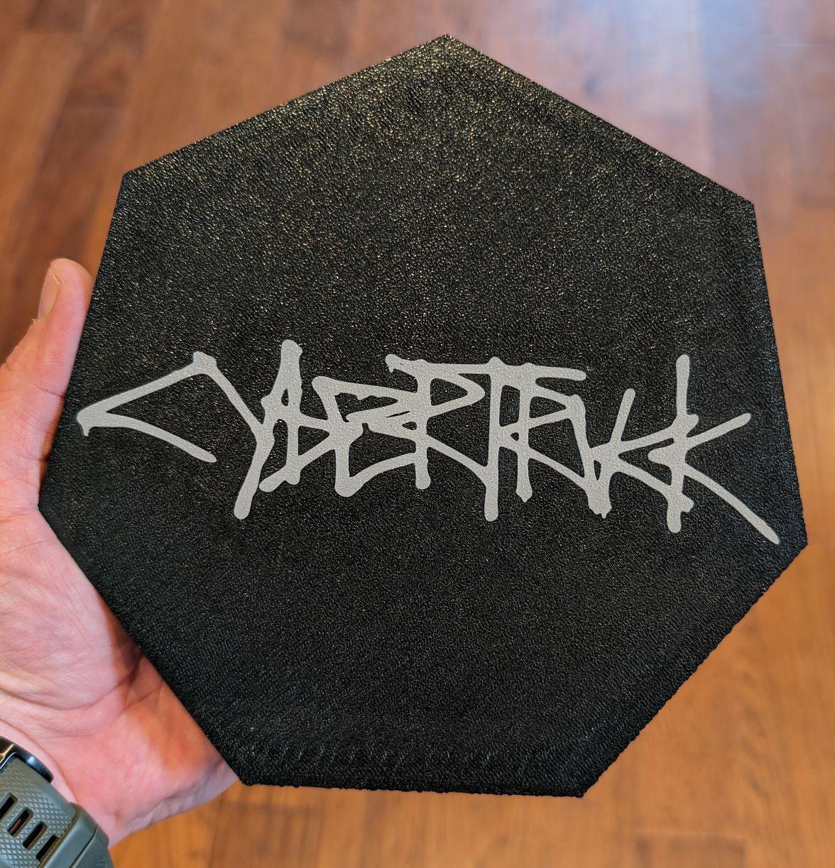

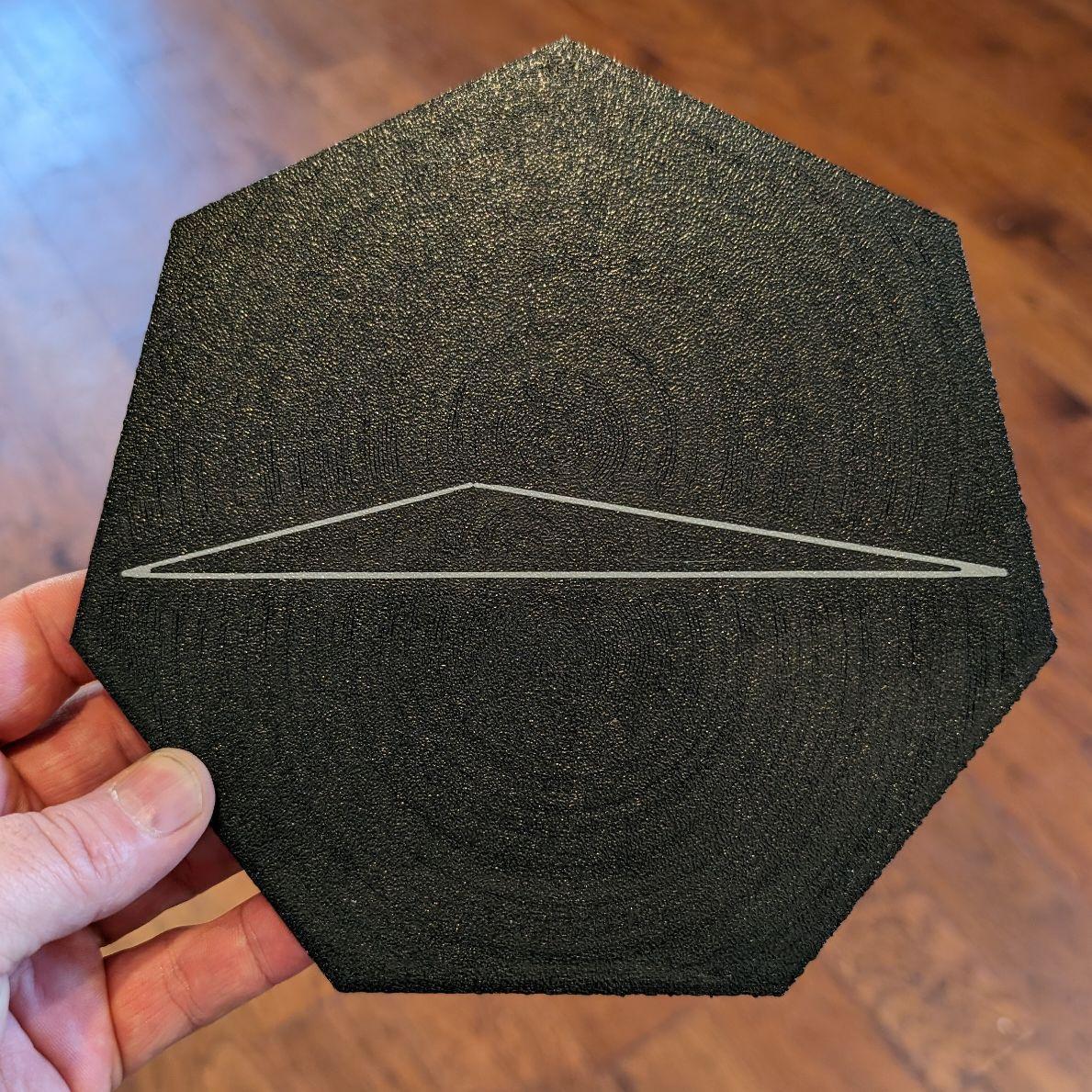

Good News Everyone!
If you have a 3D printer, the cover is now available on Printables and on Makerworld.
- https://www.printables.com/model/821988-cybertruck-wheel-cover
- https://makerworld.com/en/models/398338
If you don't have a 3D printer, I'll make one for you.
- https://www.etsy.com/listing/1703907313/cybertruck-wheel-cover

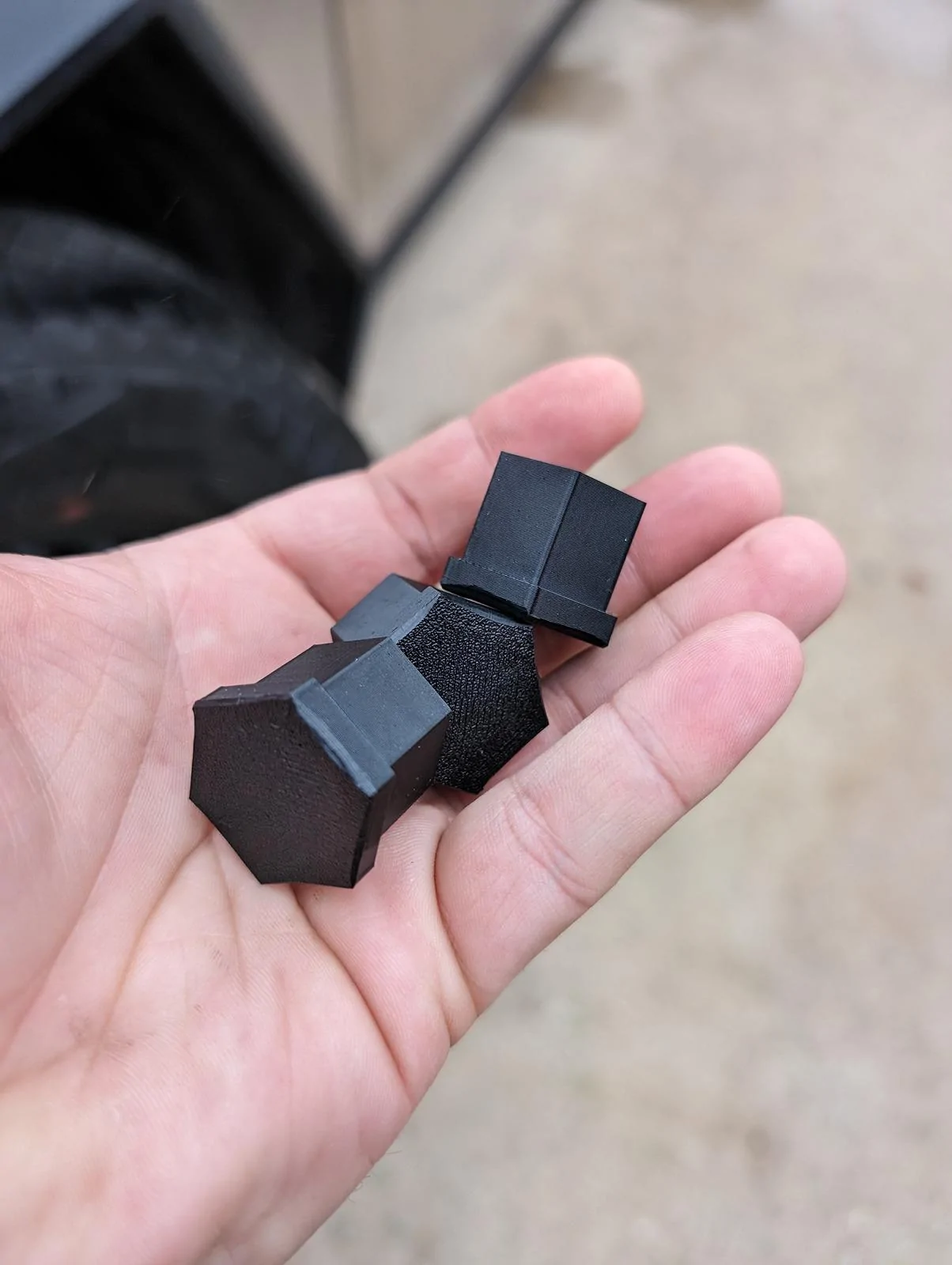

Thanks for sharing!
where can I find the small center cap for use with the individual lug nut covers?
I’m going to attempt to print today, will be my first time using ASA.
