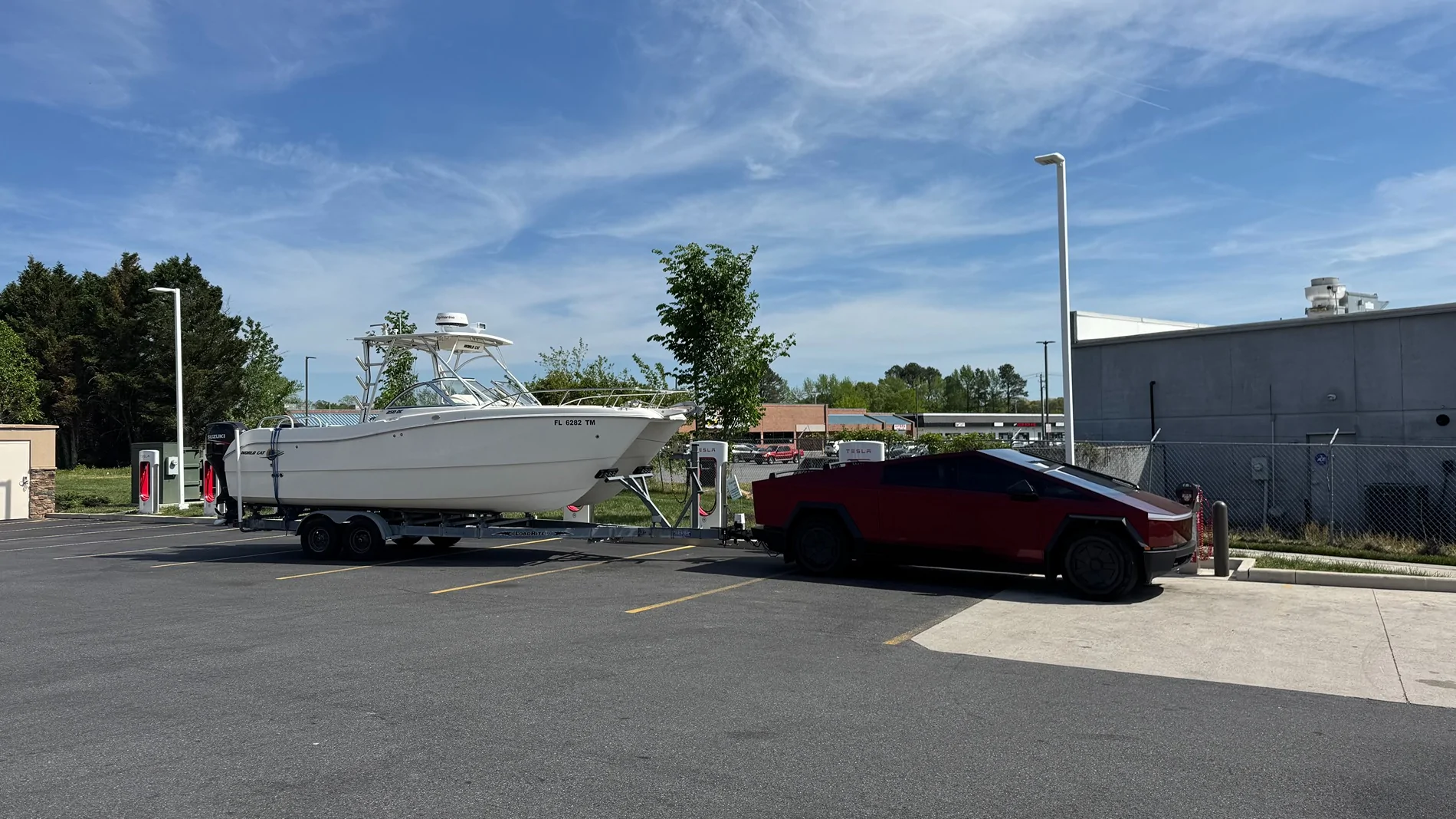

I am currently towing 9,500-pounds just fine. I am upgrading to an identical model, but 20-year newer boat (World Cat 265DCX) next month that has bigger motors so will come in at close to 11,000 pounds, even with a new aluminum trailer replacing my old galvanized unit.
A few observations:
First: My max range with this tall rig is 110 miles, so effective working range is 90 miles. I expect that may worsen with the new boat. I still plan on trying to tow it from Maryland to Florida, but it may require 10 more hours compared to my F-350 diesel, and a tight sphincter from my wife's range anxiety.
Second: Spend the money to get brakes on two trailer axles. I switched mine out to electric-over-hydraulic for several reasons, but that's expensive (a $12k conversion for two axles). The primary reason for me was switching to a weight-equalizing hitch, but i also adds more control over how the weight is handled when empty vs loaded, the amount of fuel on teh boat, etc.
Third: Weight equalizing hitch - this is nearly unheard of in the trailer boating world, but is standard for towable campers. It solves a lot of weight distirbution issues that are camouflaged by the air suspension. Mongo mentions the 7" hitch-to-ball distance limit, which this violates, but I think it adds a level of safety, and using Ford's specifications, nearly doubles the hitch weight rating (at least on every Ford pickup truck).
Lastly, you will be at max payload with 11,000 pounds of trailer - that's assuming a 200-lb driver. No other luggage or people, or you will be over. I may or may not have to exceed that myself by a few hundred pounds with the incoming boat/trailer.
