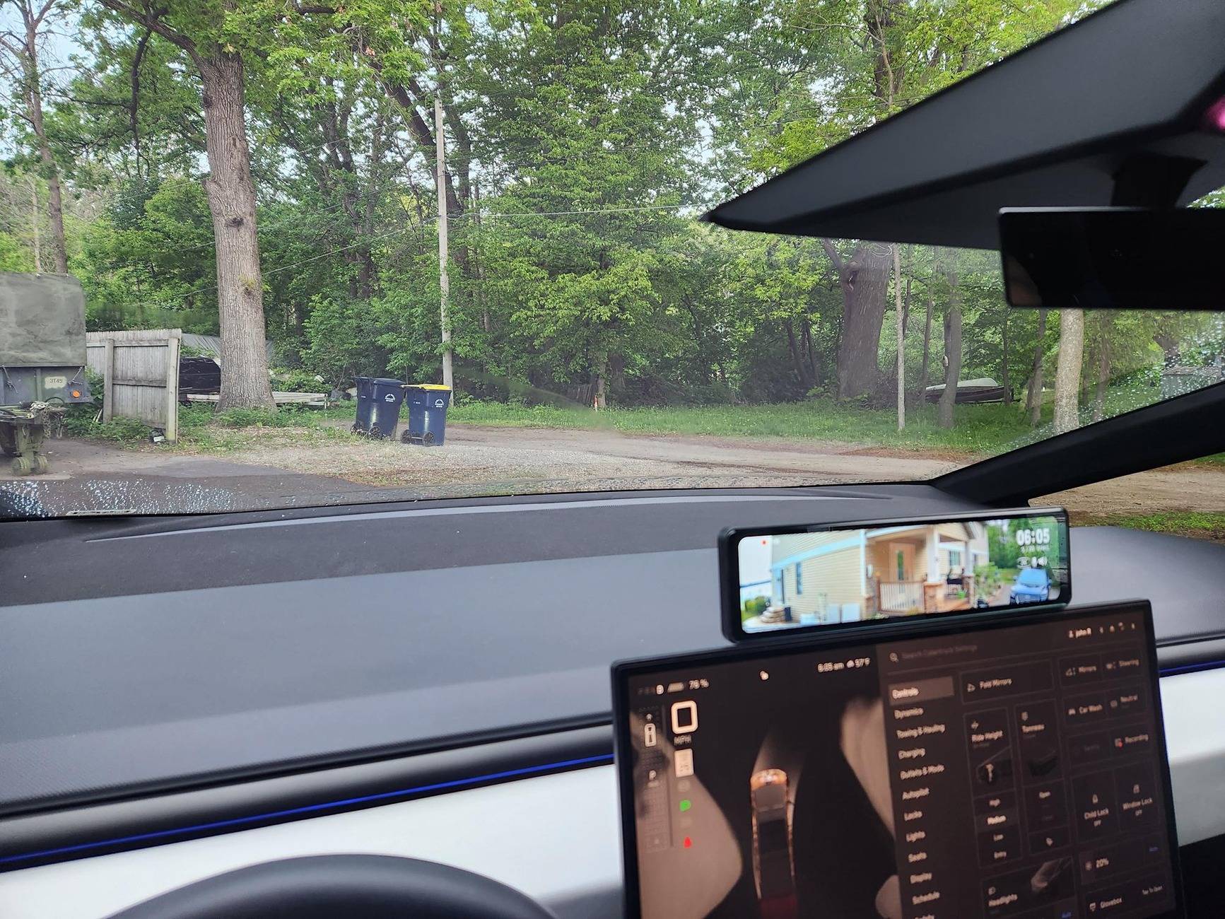

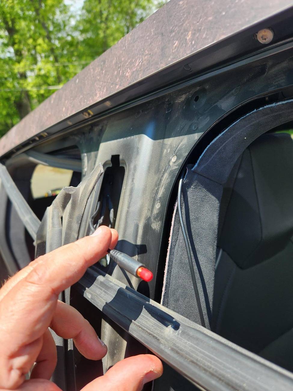

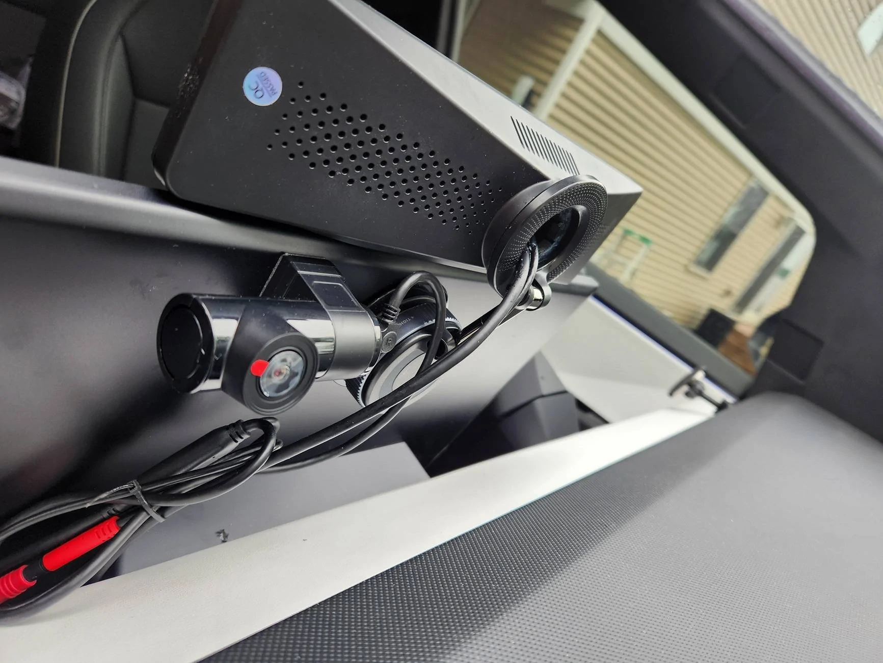

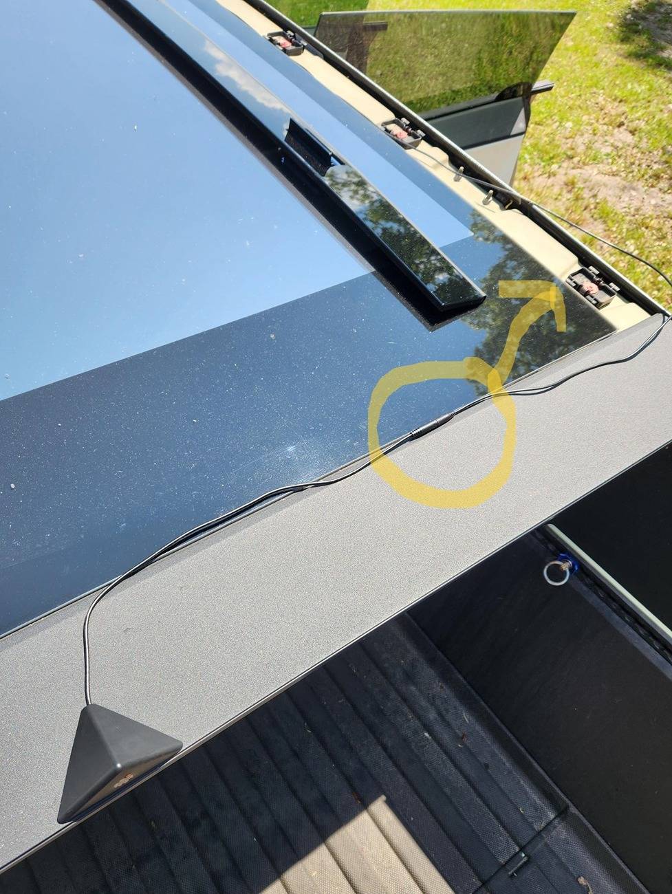

I did the latest Hannshow digital rearview mirror 2.0 like that. I prefer the location due to it not blocking the windshield at my driving eye height. I took the picture of the screen with the phone in front of my eyes to show it doesn't block your view. Install took a couple hours, I will be removing the original rear view mirror soon. The cable on the camera needs to be a foot longer to hide the connector under the roof trim piece. By the way pulling the secondary door gasket down as seen in the one pic was unnecessary.

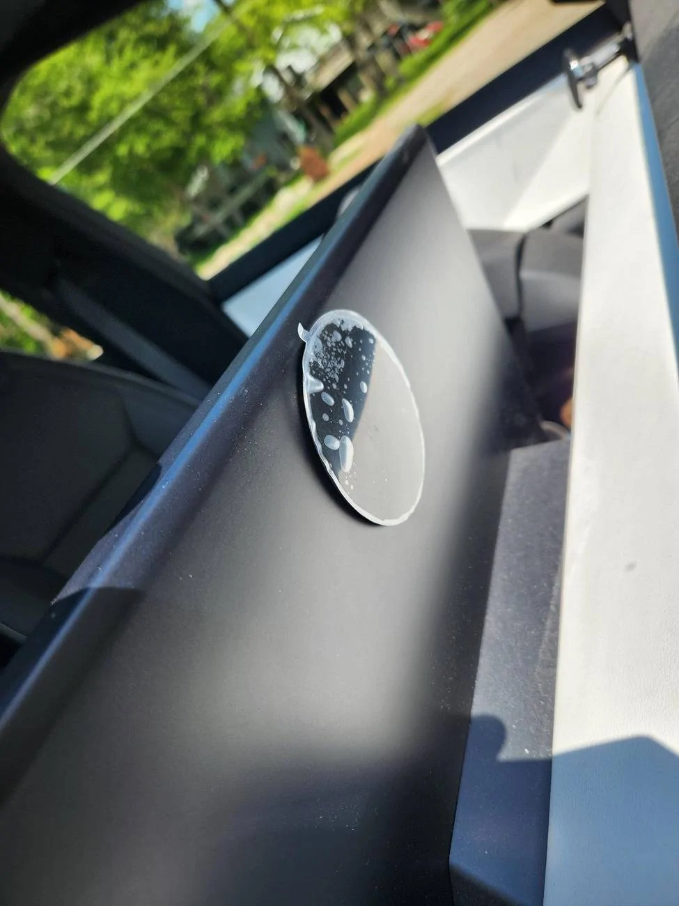

The 2.0 has a harness that is basically just piggybacking into one connector on the computer in the passenger footwell and one connector to the right of it next to the door. The mount I used as shown in the pix, comes with a magnetic ring which I just attached to the back of the mirror after popping the ceiling mount out of it. Few drops of super glue along the top and bottom of the magnetic ring held it on to the mirror, the magnetic ring then sticks to the main suction cup mount magnetically which is then attached to the disc on the back of the monitor as shown in pix. It would pop off after about 6 or 7 hours until I got the suction cup a little wet and it has now been on for more than 24 hours without issue. I like the fact it doesn't vibrate at all while driving either.
