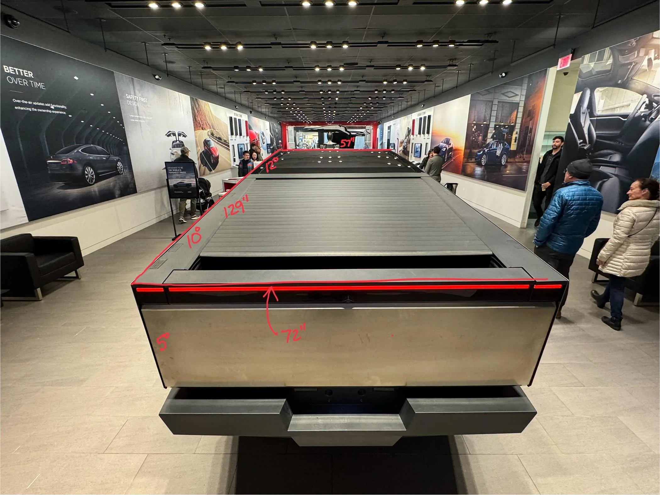

I'm in the process to convince some 3rd party companies to build/design the canopy and roof rack for the Cybertruck. They are looking for exact dimensions of the truck. If you have them, please DM me. THANK YOU!

That helps. This truck cab company is looking for dimensions/measurements etc. I'm trying to help them (to help us) so we get more roof rack/accessories options out there. So, help is always appreciated. I have the CT already but I may not be able to get them accurate measurements down to mm. That's why I asked. Cheers.

Across the top it is 57”, across the very back is 72”. From the top edge of the back to the top crest is 127” with the slope of 10 degrees in the back to about 12 degrees in the front (it’s not a straight line because it has a very slight curve to it). It’s has 4 attachment points on each side with each point having two M8 screws.
I’m planning to weld up my own rack to throw a boat on top.
Also check out cyberrack.com to look at their concept. They probably have a 3D render because they are working with Sandy Monroe.
