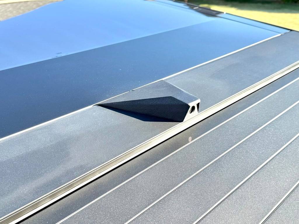

The one in the post above that is hosted on Thingverse except that one doesn't accept the V2 camera housing so I have modified it and will post the new file so you can print one that will accept the new camera.

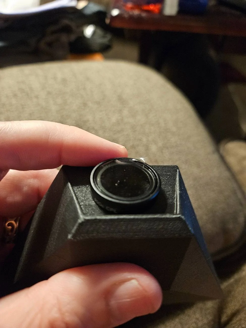

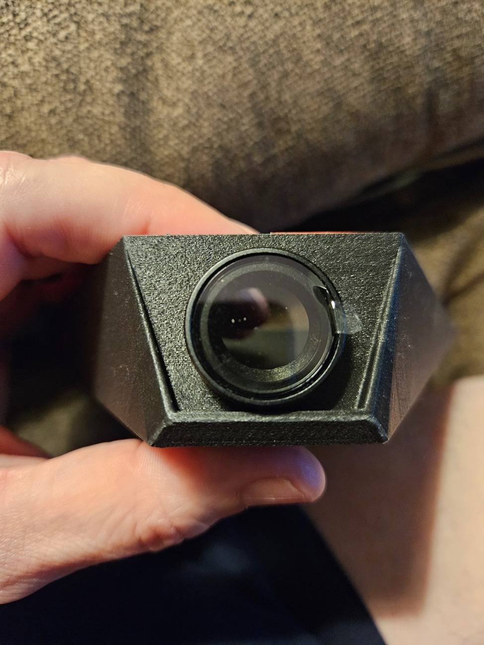

Has anyone considered adding a circular polarizer to either the front or rear camera? I know the Wolf box mirror has a cpl lens attachment. I got the one on Amazon that says it fits the wolf box, but it did not fit the Hanshow front lens. There are others I may try.
As I had the lens in hand I wondered about attaching it to the rear lens somehow. I was thinking attaching it to the front of the 3"d printed housing, but wasn't sure if it would negatively impact the lens field of view or clarity.
Has anyone tried it? Would it be worth it? I am curious as to everyone's thought on the subject.

What is the lens cover supposed to do? Just protect from impact or filter light out in a certain way to avoid glare or ? It looks like it would work to mount outside the camera housing as shown in your photos. Easy enough to remove if it doesn't work out I would imagine...

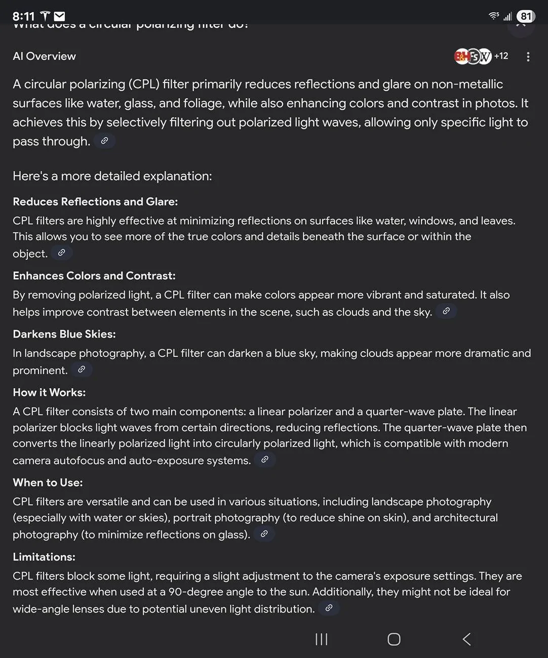

It's not just a cap. It's a circular polarizing filter. The base is stationary and the top half rotates to allow the user to dial in the filter. Below is a summary of what CPLs do. I figured it might be of use due to the windshield could create some glare. Wolfbox makes one for their front lens that is included in some packages. I have not seen one that states it fits the Hanshow or any of those other ones targeting the CT market specifically.
My quandary has 3 parts. A) Is it useful or needed B) Has anyone found one that's made for the Hanshow cameras lens, and if not, has anyone found one that will actually work with the Hanshow being it's not meant to fit, and C) Has anyone tied to put one on the rear camera?
