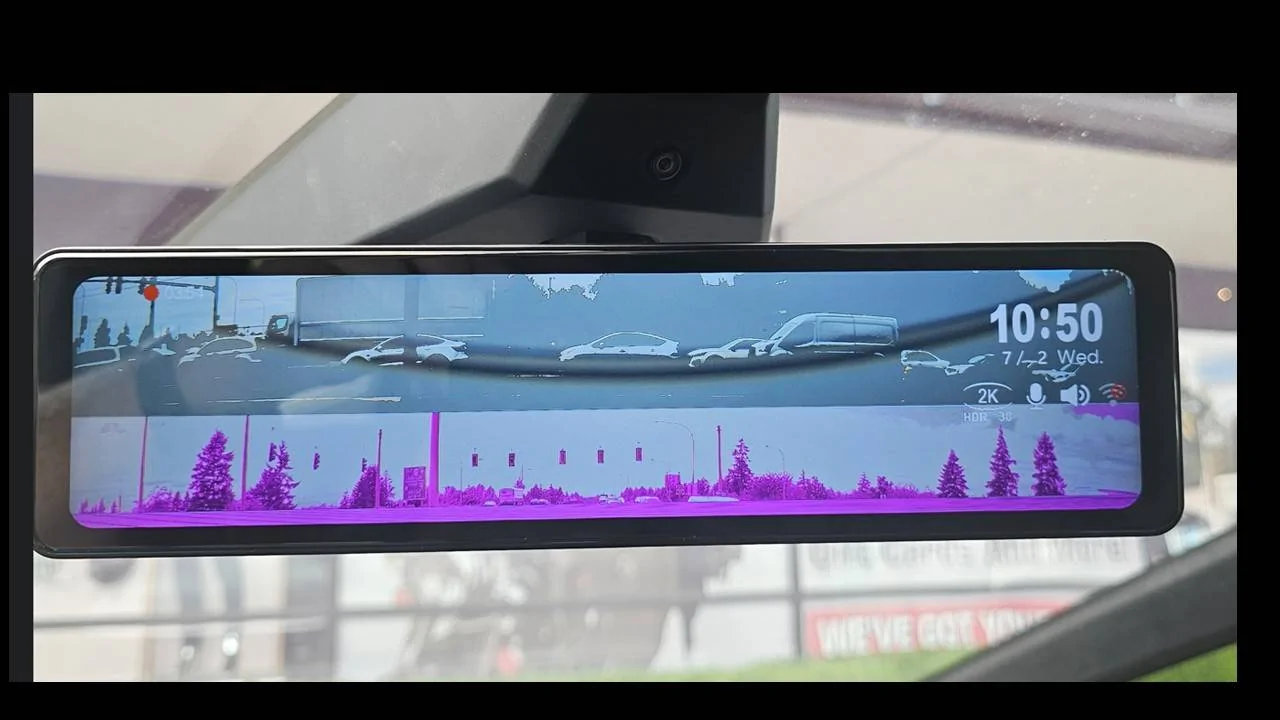

I ordered the new 2.0 version and had it installed about two weeks ago. Overall, it has worked well, with one exception. On one trip, it “froze” upon startup of the CT. I could not clear the error even after turning the mirror on/off. However, upon completion of the trip and shutting down the CT completely, the “frozen display” error cleared, and the mirror returned to service. So far, no repeats of the issue (but very limited use since the occurrence). I will continue to monitor this issue over the next several weeks to ascertain if it arises again. The 2.0 version has many nice options, and the clarity is of high quality. Overall, I am very pleased with the product, and I am cautiously optimistic as to its service. Hopefully, your issue will be resolved quickly and keep us posted on your progress. Good luck….
UPDATE: 2nd & 3rd occurrence. Today (2 Jul 2025) frozen display of rear camera view with "purple highlights displayed in lower half of mirror." Able to clear with turning mirror on/off. A few minutes later, frozen rear camera display, but no "highlights" noted. Again, able to shut mirror off/on and normal service returned.
Tesla Cybertruck NEW Cybertruck Digital MIRROR! Mirror with purple highlights
Update 3 Jul: I received a quick response from Hansshow. Their reply stated "this is a problem with the wiring harness and SD card. I will send you the wiring harness and SD card." I have now verified my address with them and I await the replacement parts. I will keep you posted. Thanks Hansshow for the quick response.
Update 20 Jul: I had a couple of more incidents, since my last post with the display freezing. My installer gave me a “heads-up” that most likely it was due to a slow SD card. He told me to purchase a faster one and it would most likely solve my problem. Hansshow was very helpful and as noted above they had already stated they would send me both a new wiring harness & SD card. They arrived this week. The faster SD card “did the trick.” The problem appears to have been solved. I will post again, if this is not the case. If you are having similar issues, I suggest you acquire a fast SD card and try it. You will most likely need the mirror to format the card and also possibly reboot the mirror with default factory settings. Good luck!
Update 29 July: Just a quick update, no more issues. The fast SD card appears to have solved all issues. No repeats. Very much enjoying this mirror.
