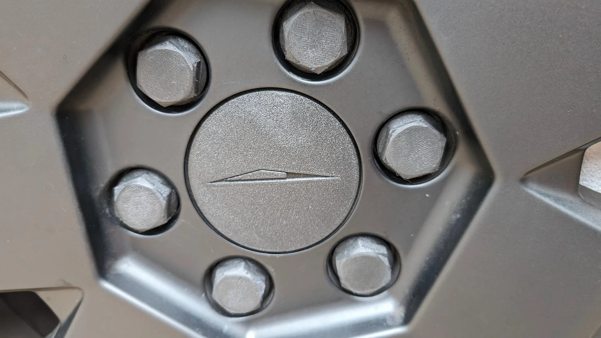

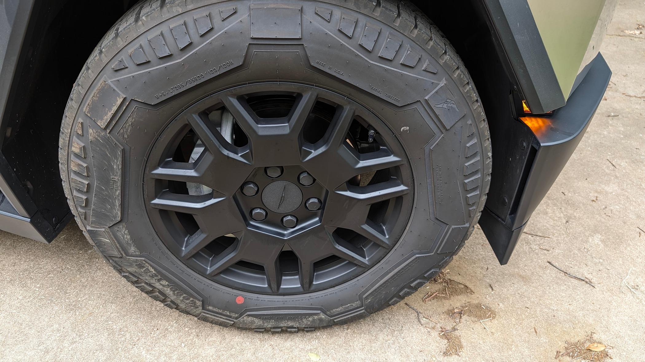

Here is my solution instead.
Steve, smart man! And looks good too.

I just realized I assumed you painted the OEM lug nuts? That looks good now, but I don't think it will hold up over time to impact wrenches.
I did not paint them. Those are 3D printers caps. They look cool, huh?
