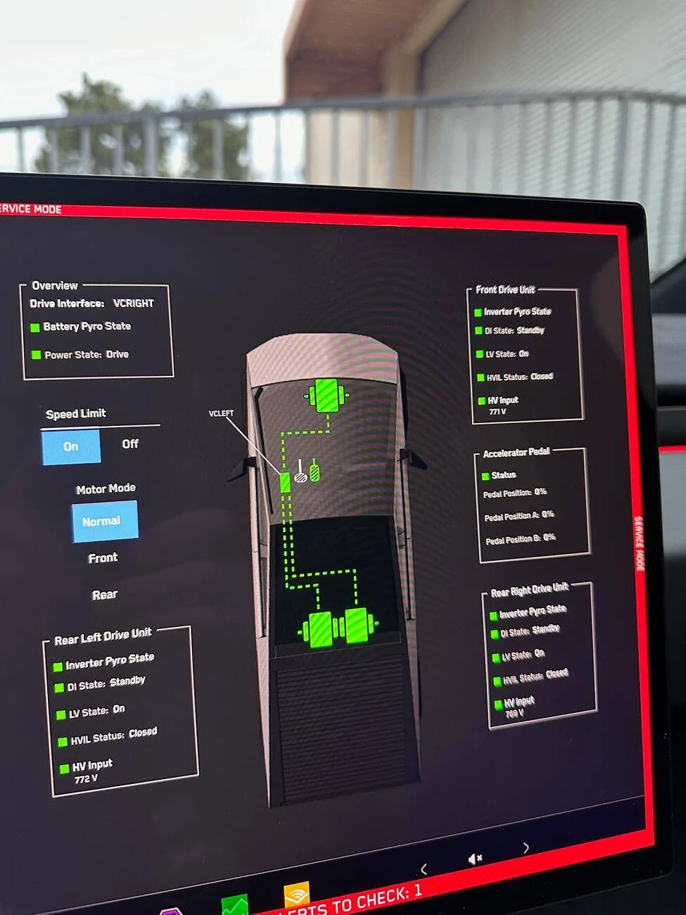

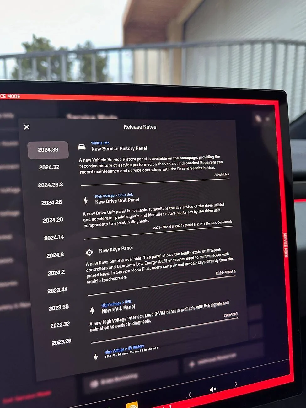

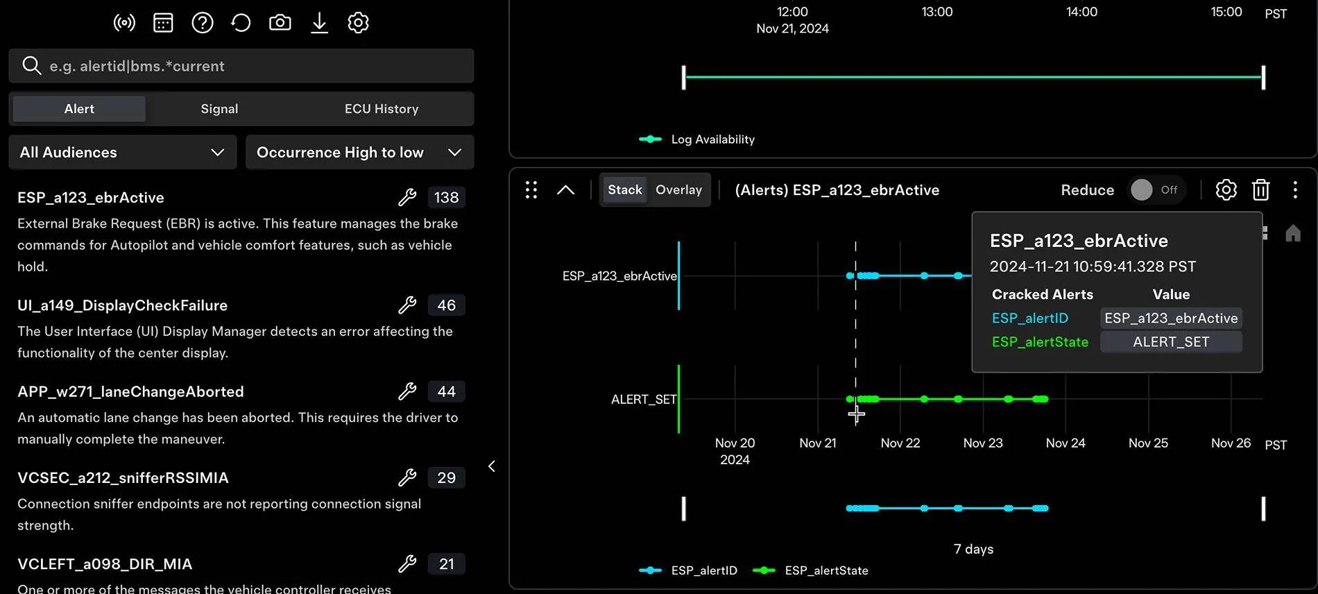

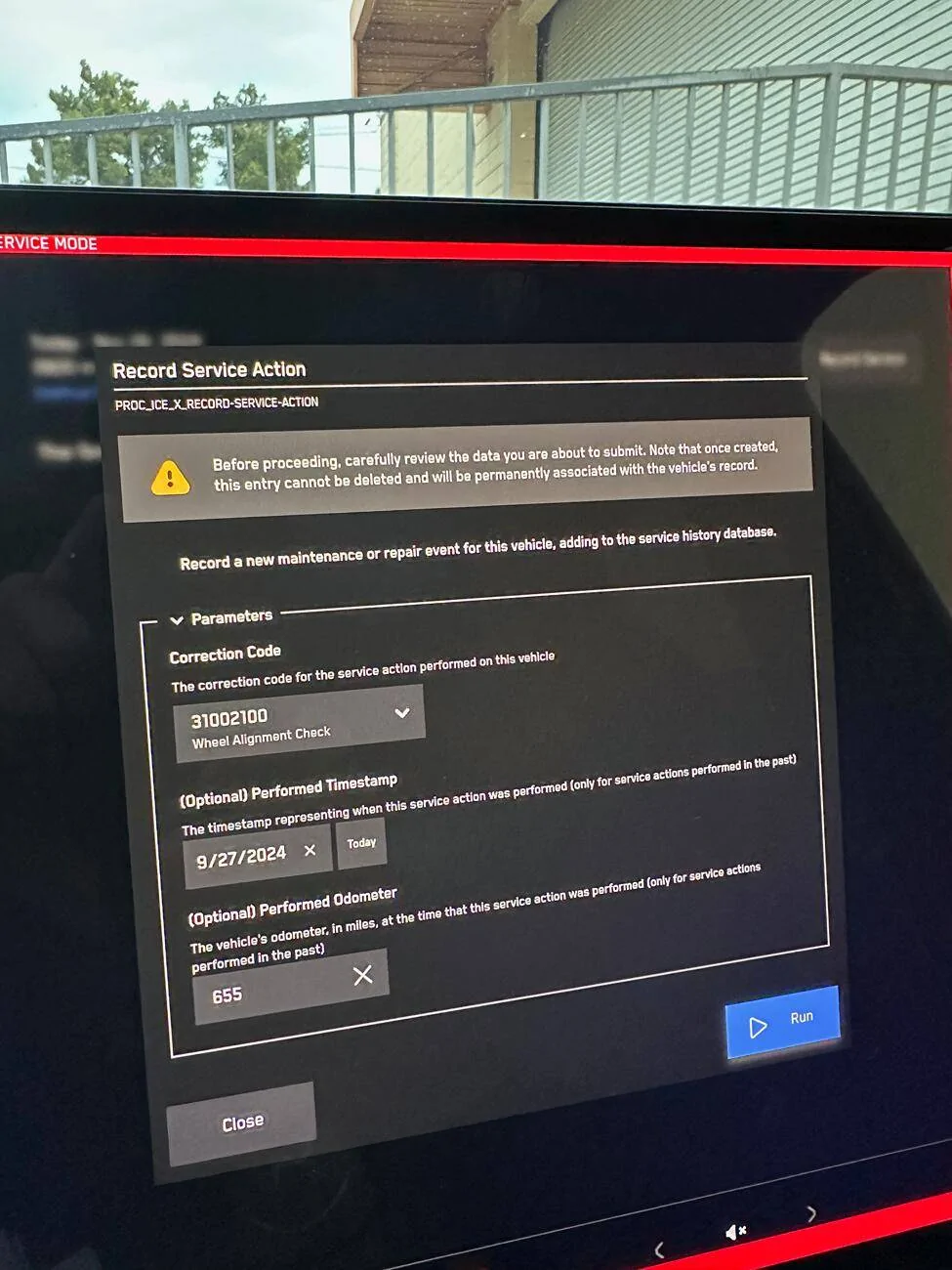

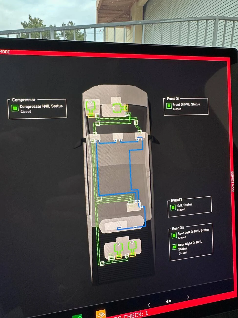

A big diagnostic related update rolled out to the Tesla Fleet recently with 2024.38 and it has positively affected the Cybertruck! New with this release: Service History Panel - allows service personnel to record service events. Drive Unit Panel - Useful for analyzing and isolating conditions and or faults. HVIL Panel - Cybertruck used HVIL over CAN and this panel provides a visualization of the system for service personnel. And finally a fix has been added which now allows Toolbox to pull cracked alert data. Prior to this release this feature was broken and would always report data not available.
