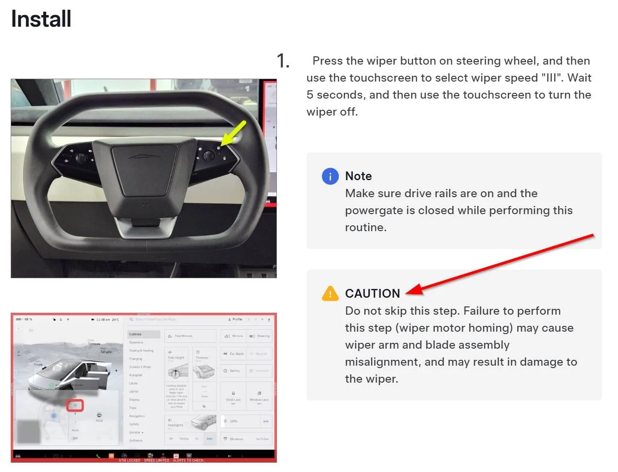

Mine did the exact same thing after the recall repair. They sent a mobile van and all he did was redo the software. He said somebody probably skipped a step at the service center. Works good now except the blade now sits just a few inches off the edge. Not enough to be annoying.

They finished a little while ago. Whole job took maybe 20 minutes. Basically, firmware was never loaded after they replaced the motor. Now works fine.
