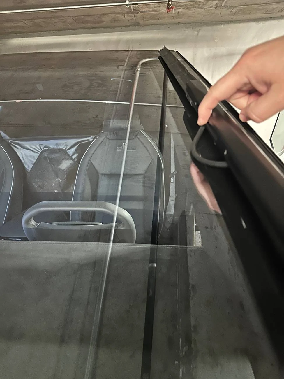

Just the small jerk 1”-2”, leaving a gap between it and the B Pillar. So annoying, as it is right in my line of sight.
When they did my wiper motor recall I had this same issue. I asked them to fix it twice but they never got it right. I ended up fixing myself. Super easy. Undo cap. Pull up at base (it won’t come all the way off). At some point it will swing freely. Align top to the 2 arrows at the top of the windshield. Tighten back up. You don’t need to pull the water line at the top just the connection at the base to loosen the nut
