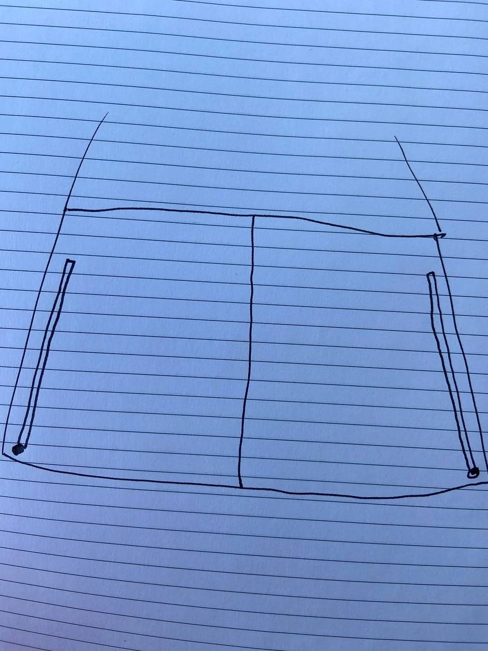

I had a hunch that the unibrow wiper system would prove to be problematic with owners.
I always felt that the Cybertruck windshield should have been designed with two separate smaller windshields that would meet at the center via a thin metal vertical section built into the unibody design.
Of course this all goes against Tesla's mantra that the best part is no part. 2 windshields, two wiper blades, 2 wiper motors, another piece of interior trim, etc.
