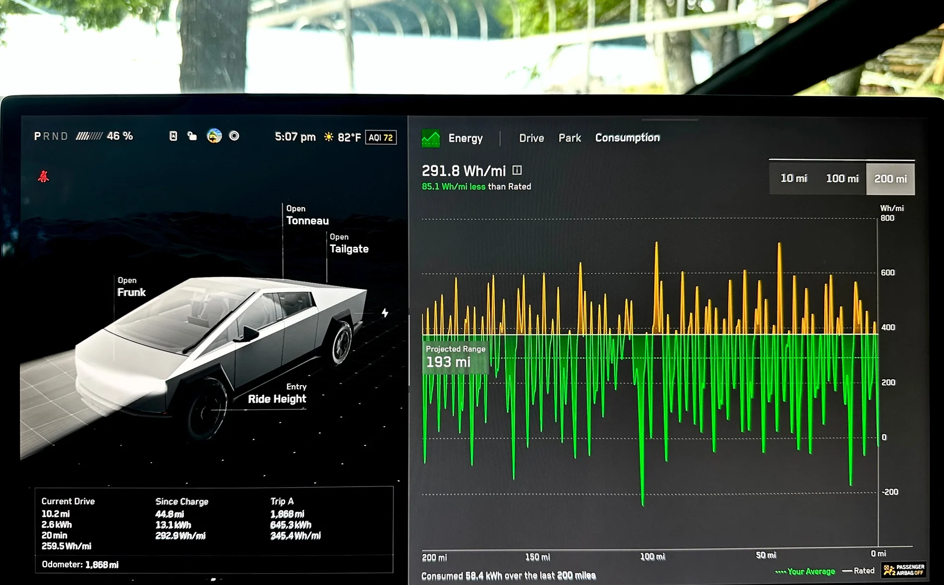

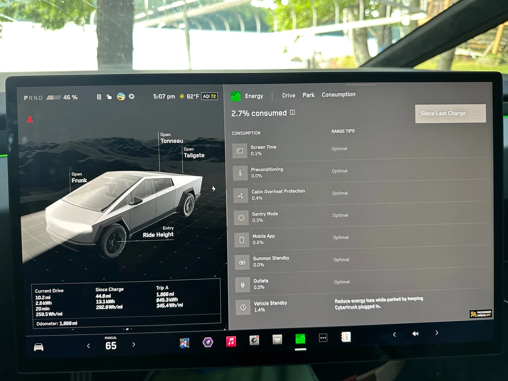

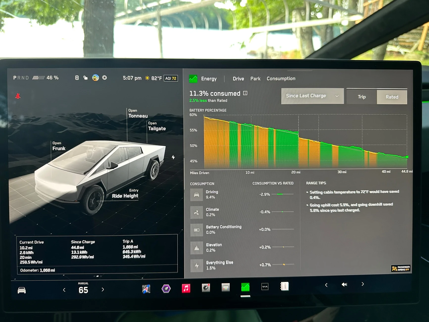

So, speed kills. If you drive on city streets or country roads, you'll get better than EPA-rating. If you drive 75mph or faster on the interstate, you'll get much worse than EPA-rated range.
Having said that, a lot depends upon your driving goals. If i'm roadtripping, I like to get there as fast as possible. The fastest roadtrips are to drive as fast as you are comfortable, and charge at low SOCs. I don't care what my range is. I'm just trying to get where I'm going in as short a time as possible.
To get the best answers you have to give as much background as possible. Show us these 3 screens, so we can see where you are losing range.
Tesla Cybertruck Newbie Range Question IMG_1541
Tesla Cybertruck Newbie Range Question IMG_1540
Tesla Cybertruck Newbie Range Question IMG_1542
If you want to run simulations to understand the best strategy, I'd get ABRP, A Better Route Planner, and test out ideas. ABRP. Put in your common trips, and test out how to get the answer you want. Drive fast, drive slow, etc. For me, open-ended questions with little actual background info, just makes people write long answers that may not be relevant. Do the community a favor by providing as much context as possible. Then you'll get better answers.

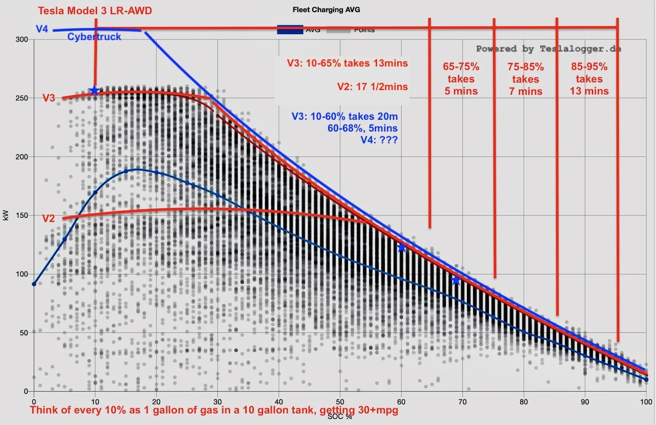

To be honest, I typically stop every couple hours for a bathroom break, a coffee, and maybe a snack. That takes about 10-15mins. So, 150mi or so, is usually the maximum I'll go before a stop. Maybe my first leg of a trip will be further, but the rest are typically 100-150mi.
Here, I made a chart with the estimated charge curve. The lowest red line is a V2 supercharger. The middle red line is a V3 supercharger. I made those for my 2018 Model 3. So far, it seems the Cybertruck uses a very similar charge curve, blue line, so that, when the CT drops to 250kW, it matches the curve of my Model 3.
Tesla Cybertruck Newbie Range Question CTcharge curv
The takeaway is that the fastest charge speeds are at low SOCs, so the most efficient trips are when you charge at 10% SOC, so you can take advantage of the fast charge rates, and since the charge curve tapers quite rapidly, once I get past about 65%, if my Tesla is ready to make the leg to the next supercharger, I'm ready to go.
Drive fast, charge low.
Of course, if there are no superchargers for the next 200mi, you need to charge up to whatever level that gets you there. But if I have a choice, once my charge rate drops below 100kW, I feel it's a bit of a negative time-wise to just sit there.
