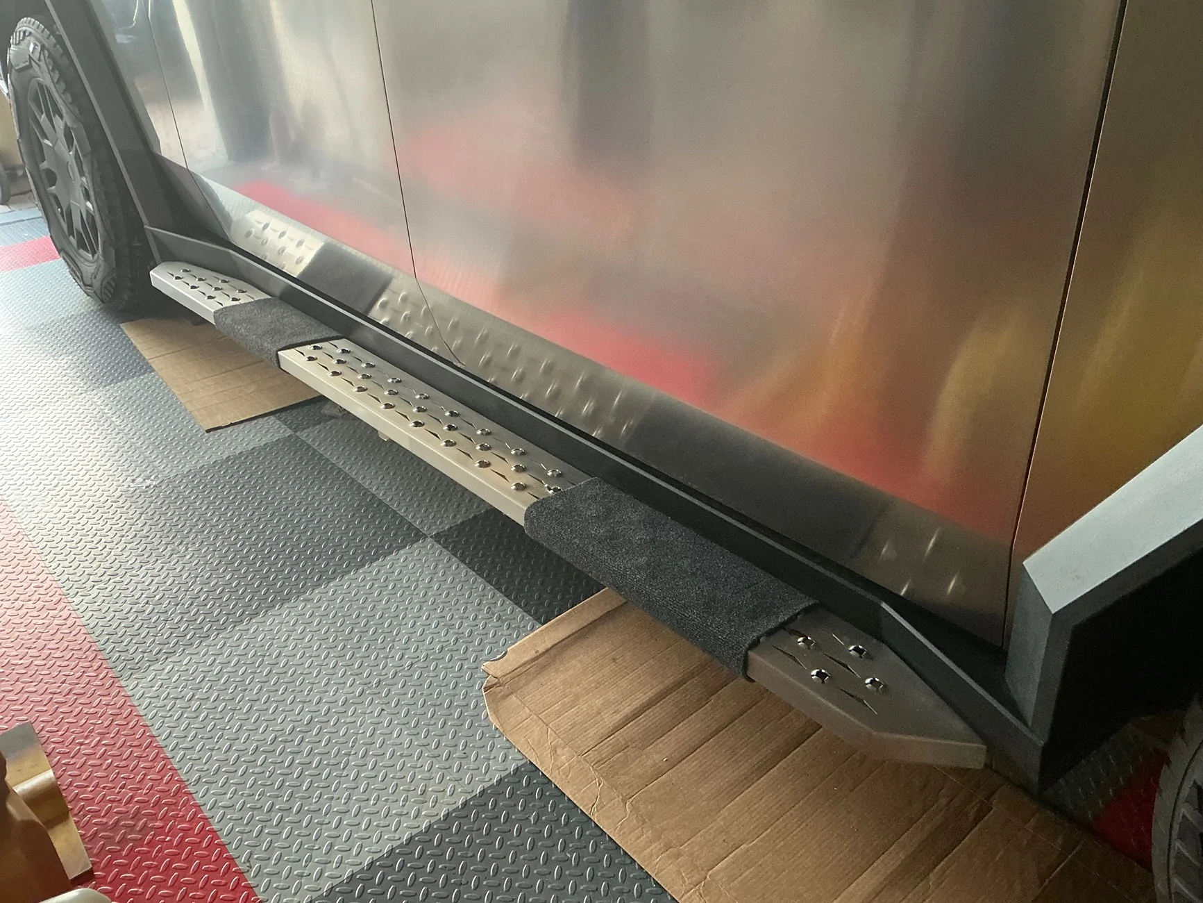

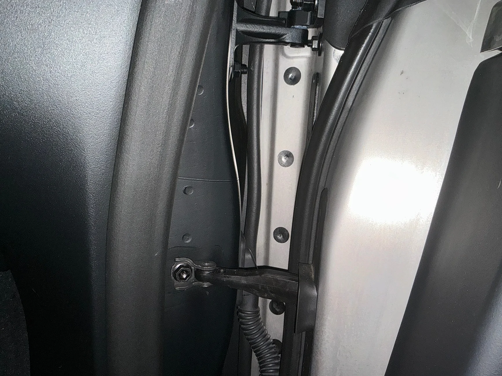

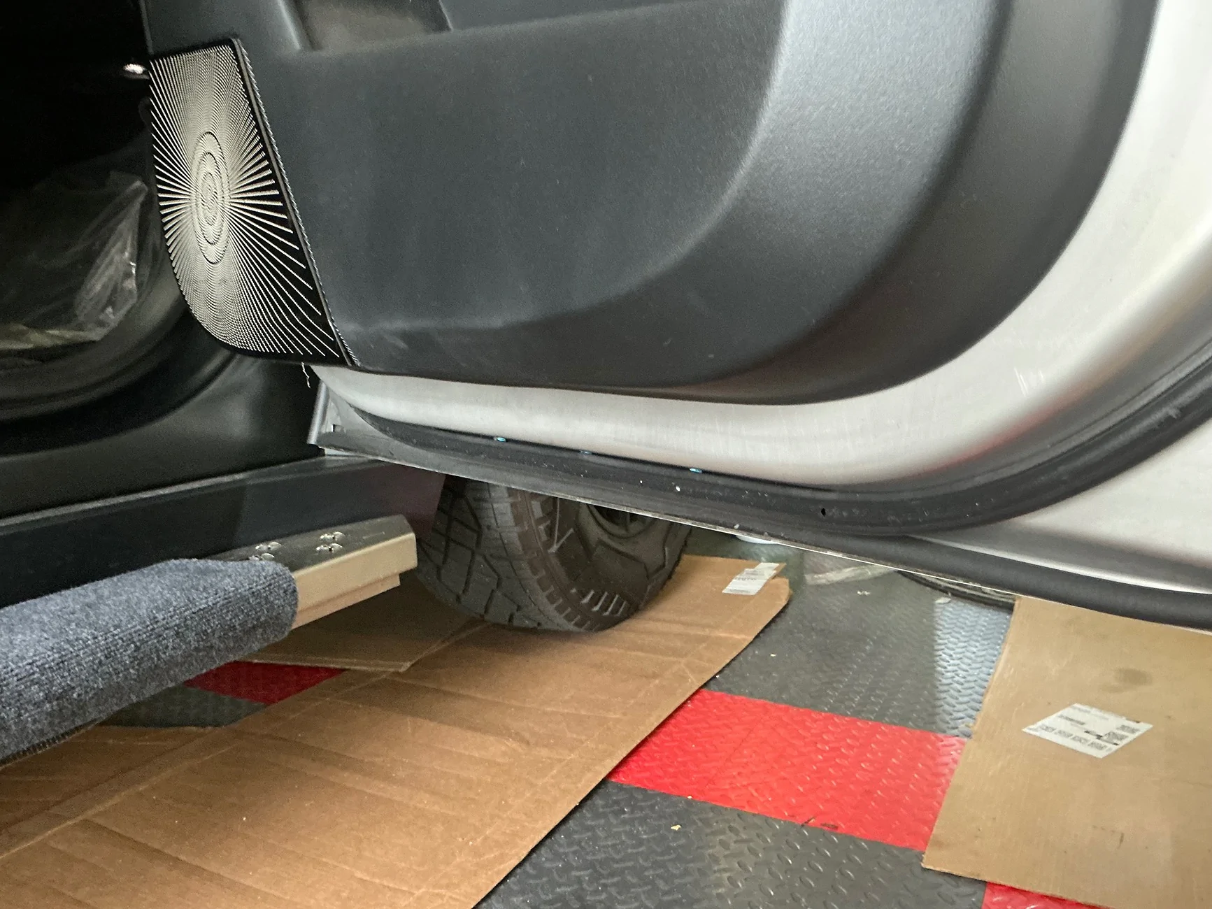

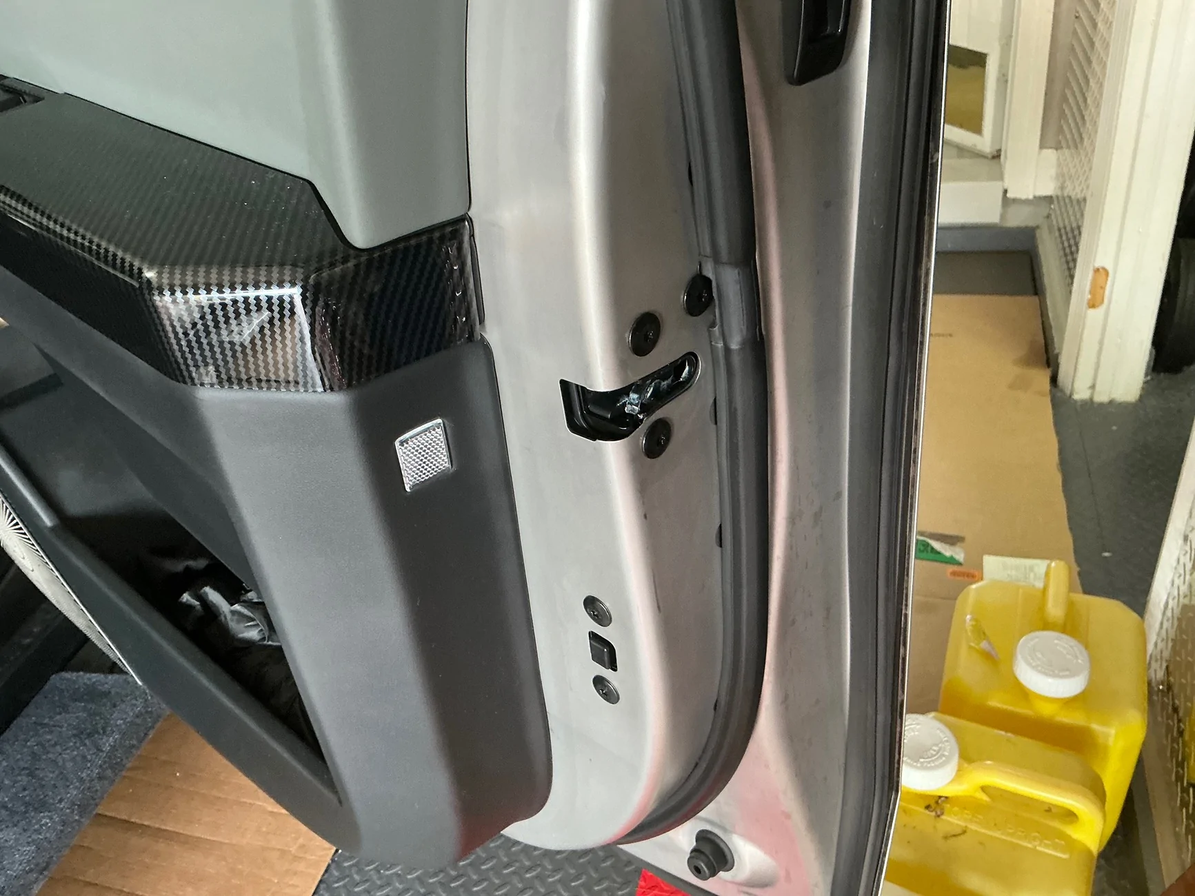

Here is mine and did this to all doors. Does minimize debris and water spots around the sills.I did the bottom door edges too. Basically a wrap around. Highly recommend. And yes does help with low speed noise in my opinion.
Tesla Cybertruck Noise Reduction & Weatherproofing Kit IMG_2591
Tesla Cybertruck Noise Reduction & Weatherproofing Kit IMG_2592
Tesla Cybertruck Noise Reduction & Weatherproofing Kit IMG_2593

I just want to see photos of those running boards? Is that marine carpet and are those stainless?

Do the added strips make contact with the sill fully around the door? The website says a 20 dB noise reduction but I'm skeptical of that claim.

I didn’t run a Db test. I know a forum member ran one at around 70mph and didn’t have any noise reduction per se. Although he did not do all the sides. The bottom seal does still leave a gap. Just ran my fingers there. I never really did have noise at high speed and there is no difference with this application. Stopped or rolling slowly it helps. I mainly applied it for debri and excessive water around the sills during rain.

Thirteen dollars at Walmart…. We have a pup lol yes stainless
Thanks. That is awesome. I didn’t realize anybody made those in stainless.
