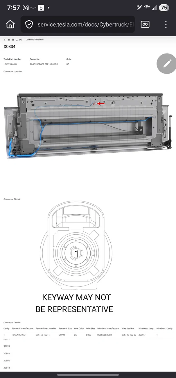

The connectors are FAKRA. They come in various keying, but Z is universal. Amazon carries a bunch of male-female extension cables.

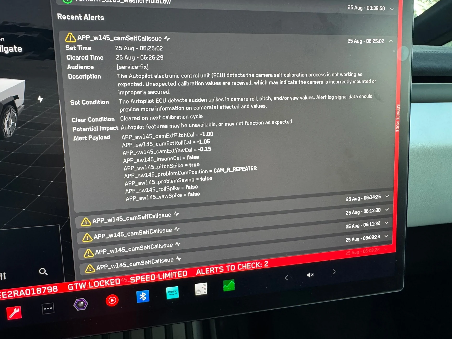

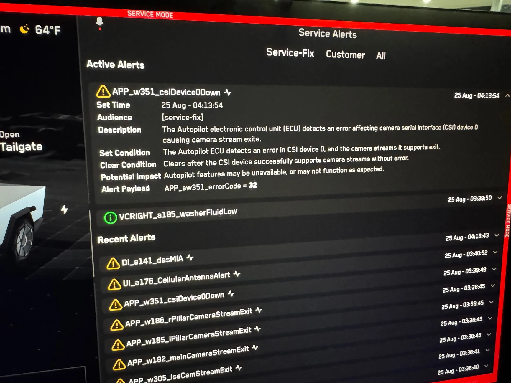

That was my posts and experience with relocating the rear camera. As mentioned in another post in this thread it was pretty easy to relocate. I used an extension antenna cable with the matching connectors to fit the Tesla camera (I found a post of a M3 using the same cable for a camera). I moved the camera to the top and back of the Urander rack. I temporarily zip tied it to the roof rack cross bar and aligned the camera to match as close as I could to the view of tailgate mounted camera. Everything seemed good and worked for almost the entire trip from Northern CA to the Colorado Pikes Peak Tesla event. My DAS shutdown about 100 miles from home. This is when I first noticed all the error messages in the alert logs about the rear camera self calibration failing. It had been posting the alerts since I relocated the camera, but I never looked at the logs in service mode. I reset DAS and drove the few miles to re-calibrate my cameras. FSD was back working again. FSD continued to work for the rest of my trip home, about 100 miles. However, the next time I drove the CT, DAS had shutdown again.
I reconnected the camera in the tailgate and removed my spare tire from the UP bumper swing arm. I am sure if I had someone 3D print a camera mount that would securely hold the camera in the exact pitch/roll/yaw position as the tailgate location it would work. However, that could easily change with FSD updates.

Alternatively, you can use the stock cable and under mount it
