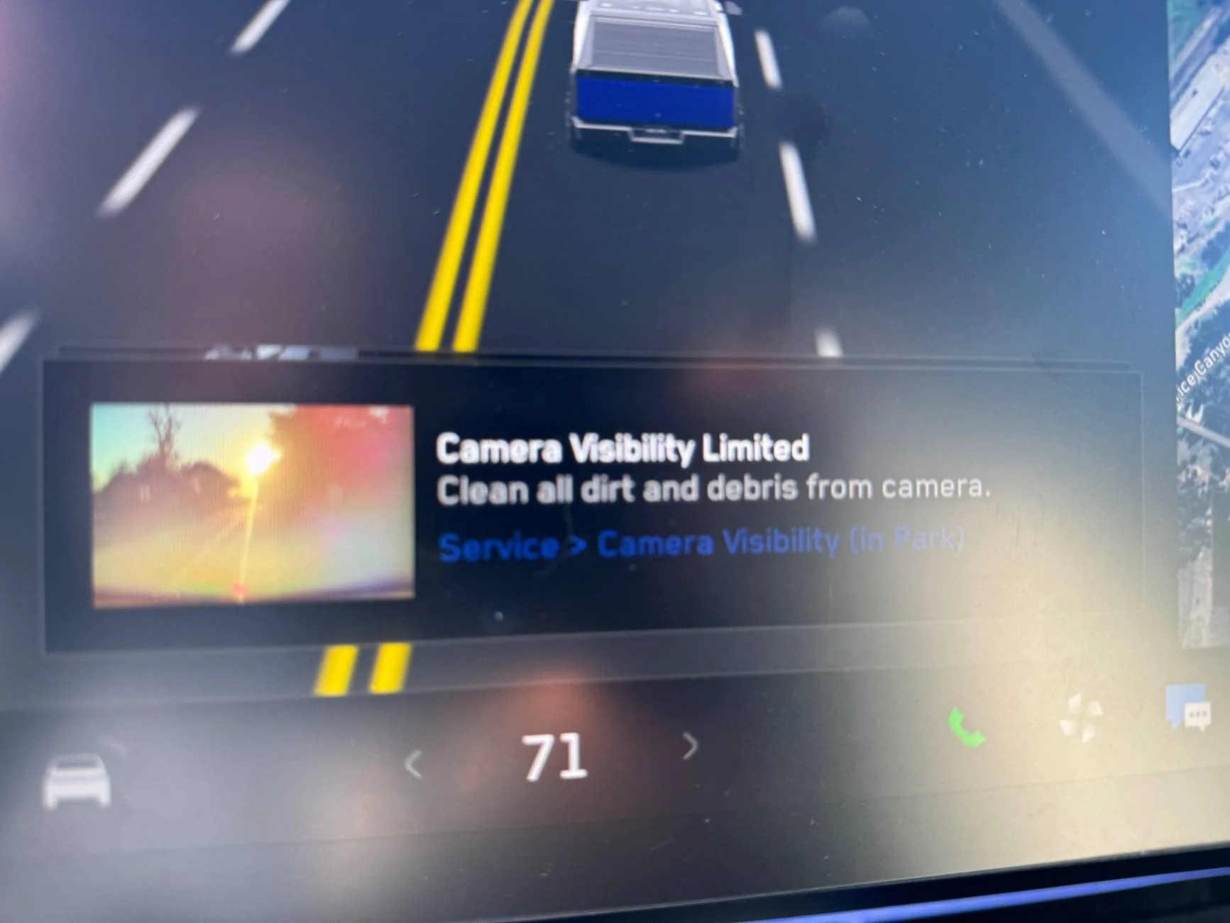

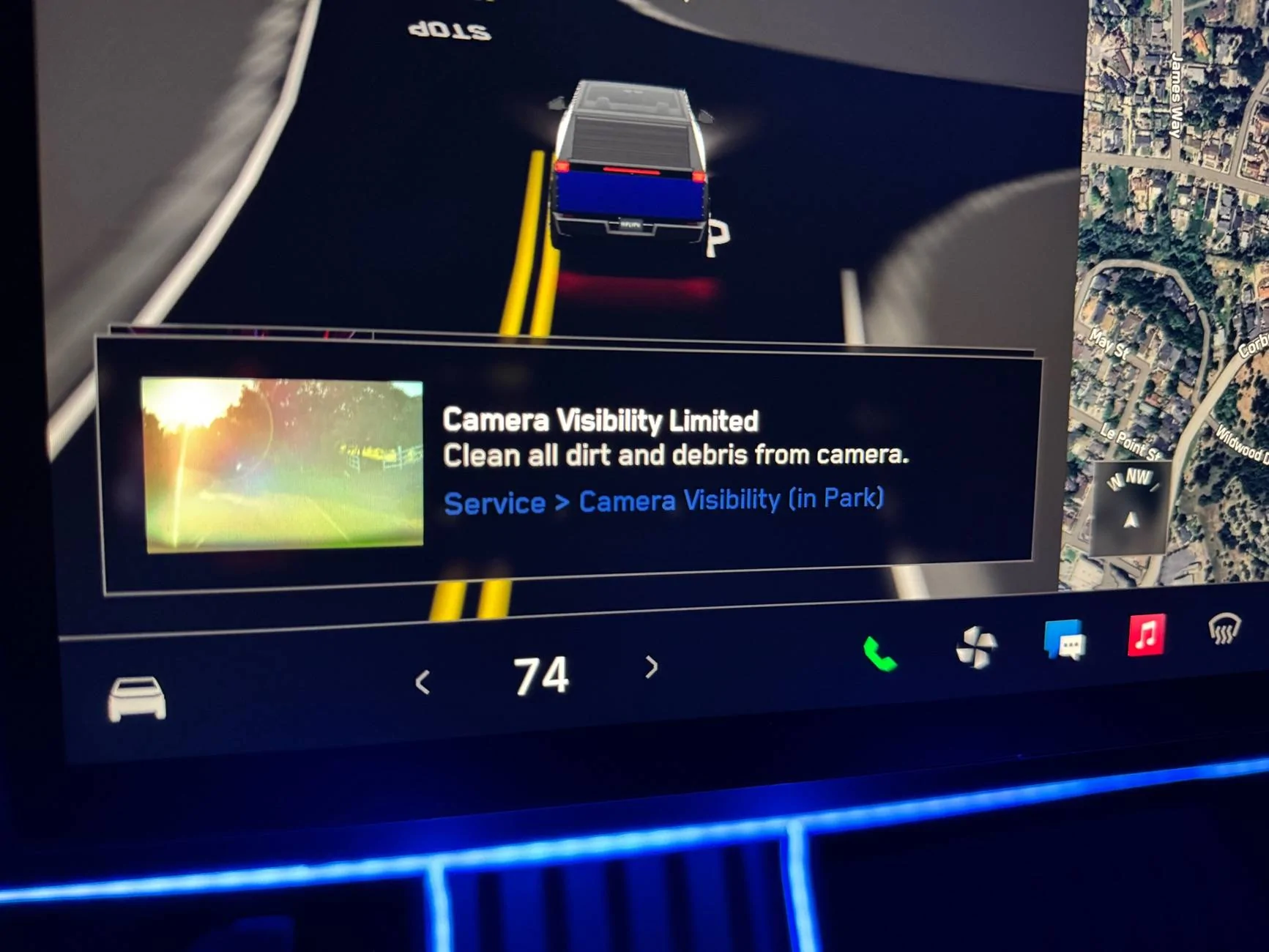

Just recently I received this message and saw that there is significant amount of fog/condensation on my “Main” forward facing camera. See the photo attached.
Tesla Cybertruck Camera Visibilty Limited Message. IMG_0033
Tesla Cybertruck Camera Visibilty Limited Message. IMG_0028
Has anyone else had this and how do you get into the main camera to clean it? Or is this something that Tesla Service needs finding.

Yeah… I have a service appointment coming up and I am going to ask them. Just didn’t know if this was common.

I get it all the time but it's from sunlight, not dirt. It goes away, at least for me, when I'm no longer in sunlight or bright lights.

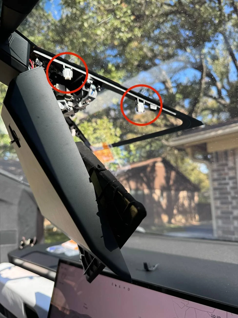

Interior outgassing fogs the inner surface of the windshield in front of the cameras. Service center cleaned mine when it went in for recalls.
Here's the procedure:
https://service.tesla.com/docs/Cybe...UID-6229D89E-739C-4ABF-BF8B-58E8FD447952.html
