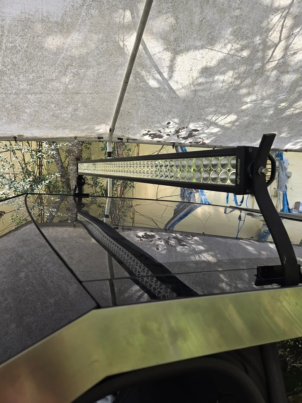

I made 2 brackets for roof mount. Bought golf cart step down transformer. Mounted it on right side.
Not pretty. But. Less than $100 total.
I got light bar off FB. Transformer off ebay. VERY BRIGHT. I did same for under front bumper. Output wires are under frunk.
All controlled off screen as power
