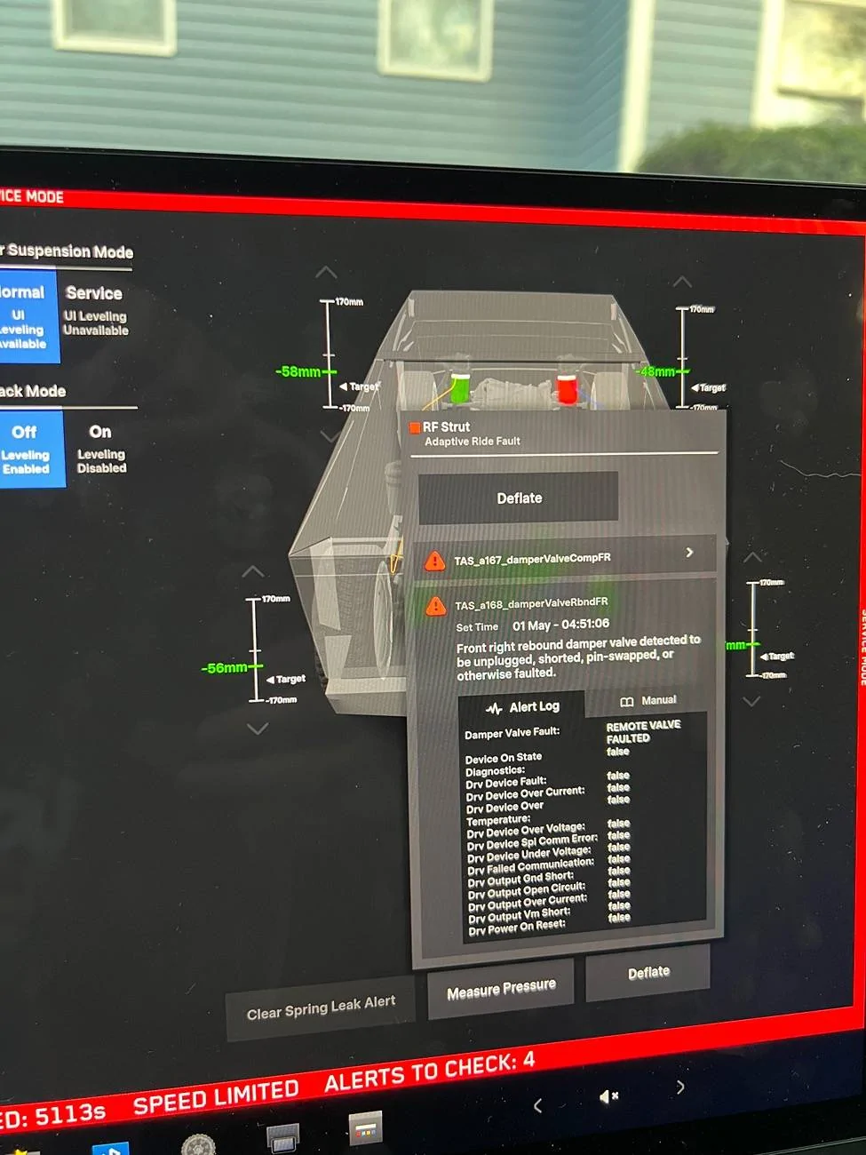

OK to drive till my service appointment?

Tesla Cybertruck OK to drive till my service appointment? IMG_6614
My appointment is in two weeks, is this safe to drive my family in?

I think you'll be OK to drive, but I would recommend doing the following:
  1. Disable Auto Lower (Controls > Dynamics > Auto Lower) to prevent use of the air suspension
  2. Remove any "auto raising locations" that may be set (if you've set them)
  3. Inspect the Right Front Strut. Check the damper valve for physical binding, damage, or debris. Inspect the wiring and connectors for corrosion or loose connections (if you're able to see it)
