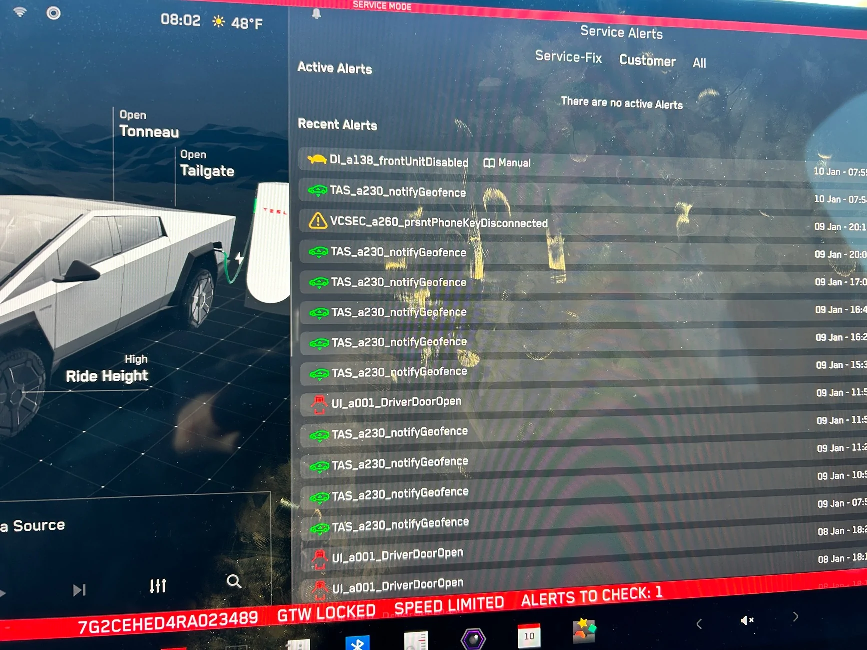

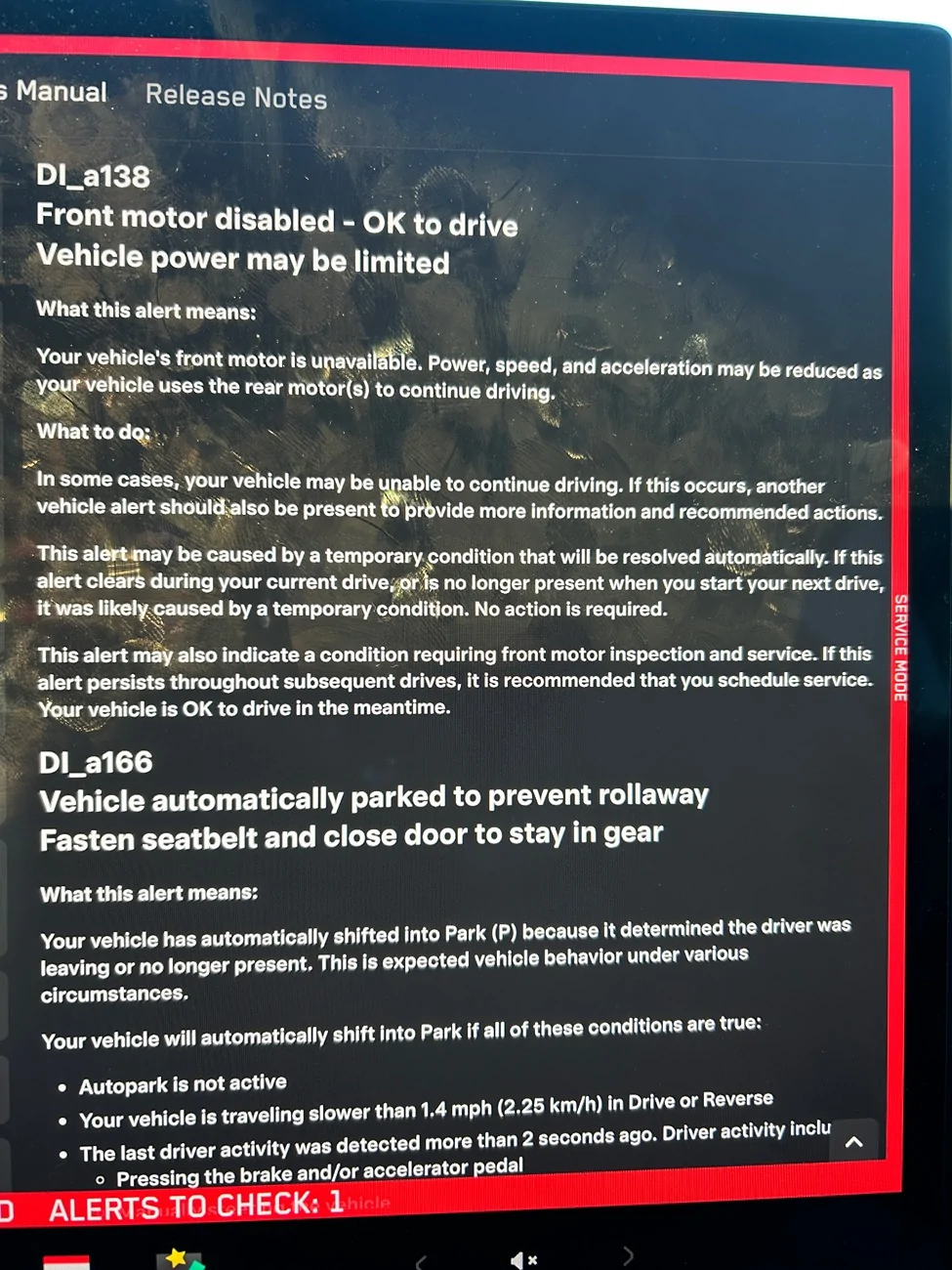

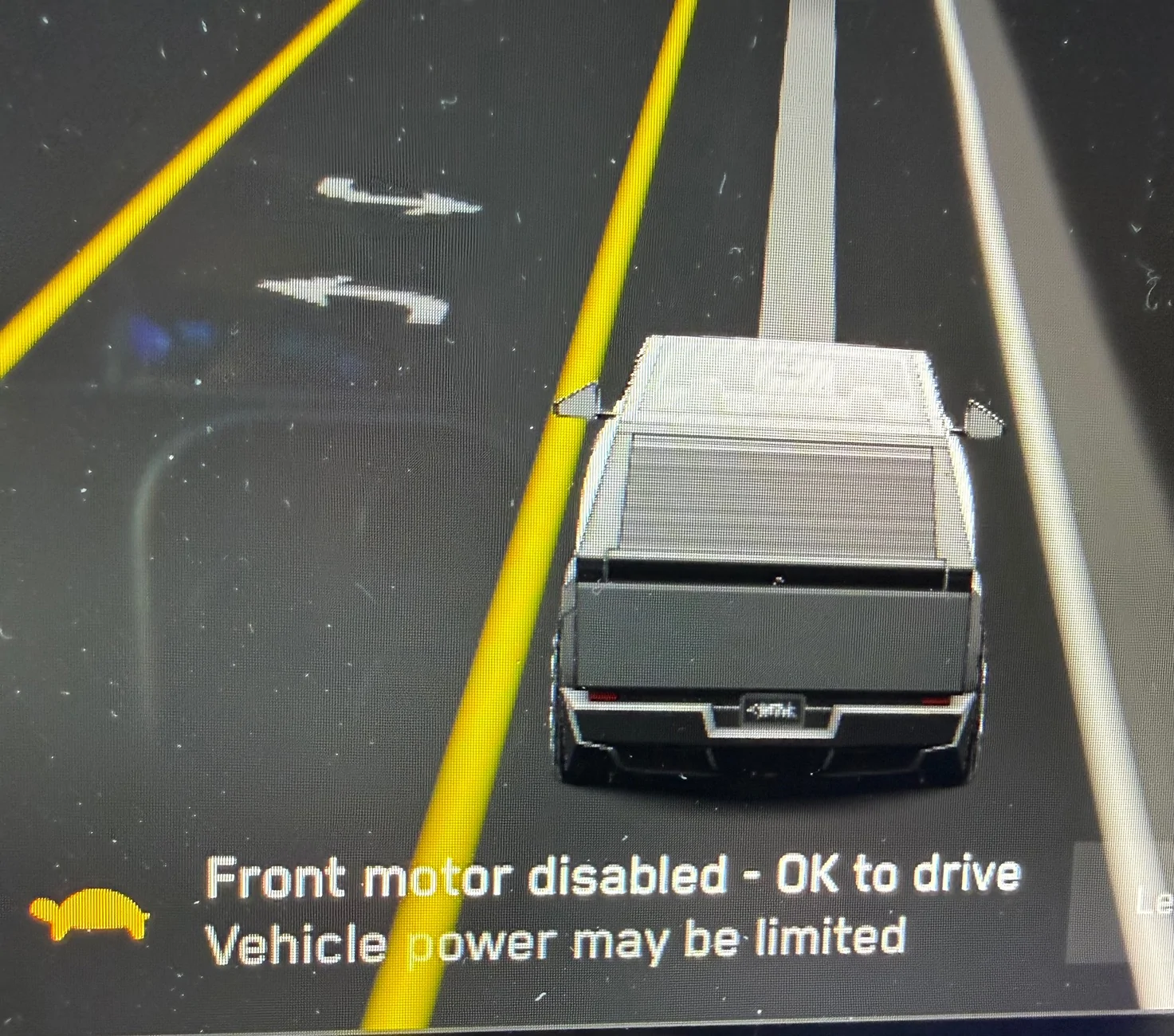

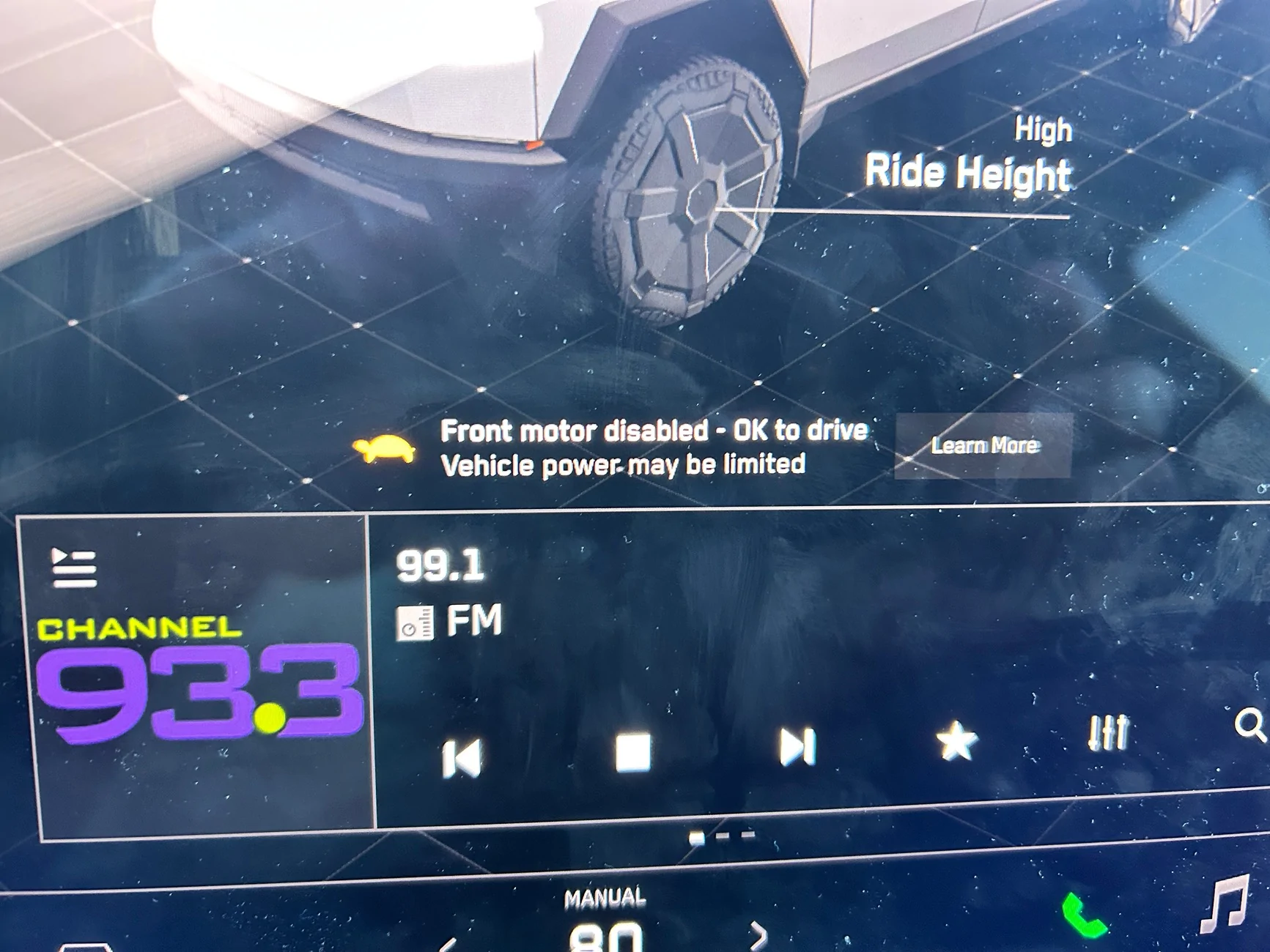

Anyone received this msg and resolution?
Tks

I had that issue. Tesla service wasn't worried in the least. Waited about 5 weeks to get a service/my schedule and theirs.

Can you look at the service menu notification? It will show more detail.

Popped up when I parked at a V4 charger and plugged in. Then went away during charging, may be went away after charging was complete, don’t remember exactly. Got a SC appointment the next week. The error was still logged but reset. The SC said errors are only visible for 30 days on the service screens and said They troubleshot it and said it was good to go and was possibly caused by the latest 14.2.x update. I haven’t seen it since. It’s been almost a month. Crossing my fingers. At least the SC has it in their system now that I reported it in case it drops from the CT memory after a month.
