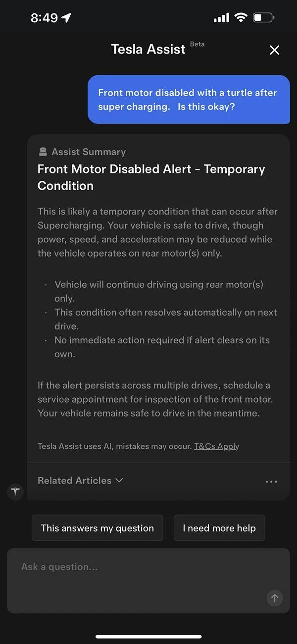

Did the message go away after a while? Apparently there’s a bug that causes that message.

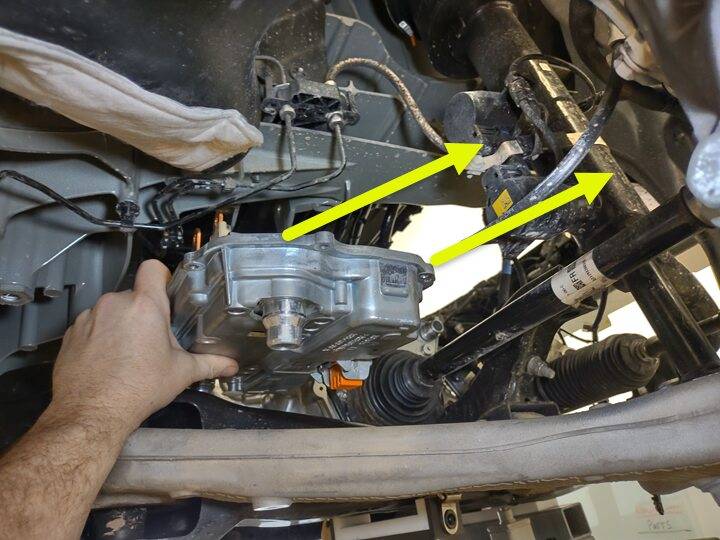

It only came on after a supercharger session and never again. I just took a screenshot of the turtle, made an appointment just to wait and see. They diagnosed it and replaced the inverter. Only left the car there for 1 day.
This is a widely reported bug. I’m surprised they replaced your inverter.

Others have experienced service telling them it’s a bug that will be fixed in the next OTA update.

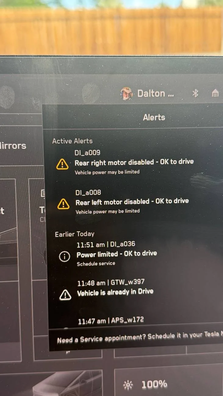

I just had this happen to my CT today i have 4000miles. It happen right after i left a supercharger. Oddly the alert went away on my next stop. But, if i go into the service menu it shows the left motor in red. I have service setup also among a bunch of other items.
