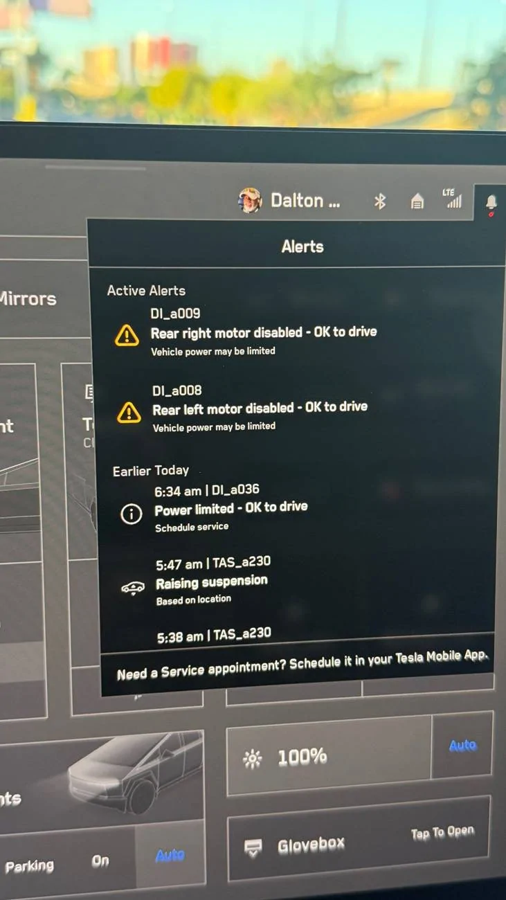

Dammit! Not this shit, again! Right after supercharging. I’m hoping it clears again like it did last time. ?
On 2025.8.7. Hopefully this is fixed in 2025.14.1?

It’s a known bug and it only happens after supercharging. I don’t think that it has (across all the examples described on the thread) ever happened with anybody charging at home. I always pre-condition. Today my session was from 43 to 85 because I’m getting ready to do some towing in town so that’s gonna burn off.
I don’t know if it’s happened to anyone charging to a lesser state of charge on the top end. But I don’t think it’s a determining factor.
The only variant on this is I’ve seen is that in some people’s case they are actually having a real fault and having to have motors or switches replaced - not just a software glitch like mine. Also we’ve seen variation in how long it’s taking some people to clear the fault - days in some cases.
Fortunately for me, just like last time a power down i.e. “power off” from the safety menu cleared the issue.
Last time it was a 15 minute shutdown, this time I did 30; same result, I’m back in business.

dalton108
Dalton
Oct 17, 2020
132
4,026
8,118
Lawyer
If it was indeed a software glitch, did it disable the front motor?
I have a tri-motor and my image clearly shows it’s the rear left and right motors that are being disabled, and yes in all cases the effected motors will be disabled.
if it’s just software that will reset; if not, it won’t. There’s extensive discussion about these symptoms above and I believe in another thread that someone linked above.

Yes, scroll wheel doesn’t work; but if you go into the safety menu and power off, I believe that this is more effective at resetting the fault and will get you going again faster. That has been my experience and someone else reported the same prior to me experiencing the issue or trying it.
