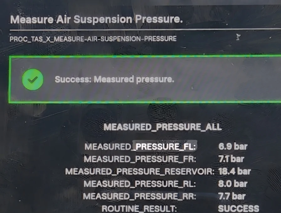

  • “Gallery Pressure” reads 1.0 bar even after raising and compressor stopped, when pressure should remain in the system if sealed (Service Mode)
  • Peak Pressure is 9 Bars
  • Service screen warning: “Front Right Spring Losing Pressure – Possible Leak”

Check all pressures from service mode. Air springs along with reservoir (and gallery?) should hold pressure overnight.
Gallery will be the pressure of the last spring filled, 9 is normal. Reservoir should be higher than that.
Front right warning seems indicative.
Front/ rear alternating is nornal.
Tank/ reservoir is just air. Nitrogen is a way to get a quick high-pressure fill.
Compressor will rest after after ~3 full lower / raise events.
Off road mode seems to get tank charged to higher pressure. On a higher bar fill, it can do most of a raise quickly without compressor. With lower starting pressure, it can take a while a while to raise.
With lower pressure it will also start compressor early due to required volume needed.
