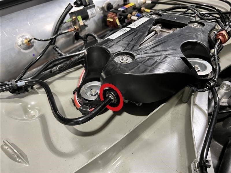

I was noticing the same problem with my rear air compressor vibrating loudly. I just got my FS CB back from the SC and this is what they found. Notes from SC below.
Concern: Customer states: hears a vibrating noise from air compressor when coming to a stop and
when first start.
Repair Notes: Found the noise is coming from the air suspension compressor carrier bracket
making contact with the vehicle body. Attempted to adjust the carrier but fout it would still contact the
body. A new carrier is required. parts are currently not in stk. Please order the compressor carrier for
next service 1250912-00-F for now i added rubber tape to the contact area until the new carrier
arrives.

Tesla Cybertruck Suspension compressor noise suppression IMG_0154
Tesla Cybertruck Suspension compressor noise suppression IMG_0210

Although it may fix an exhaust gallery error, it certainly is not the source of the Very loud banging/rattling noise that the compressor makes while it’s operating for many minutes at a time.
see attached video of loudness just sitting in my driveway and it gets louder as you drive around: it’s embarrassing, for what should an otherwise silent function as in our model S & X plaid.
Other owners have indicated that service found it to be the mounting bracket that the compressor sits & instead of the rubber grommets absorbing that vibration, the metal hits the bed frame making it sound like a rata-tat-tat-tat-tat constantly until minutes later a loud burst of compressed air then pure silence again. The longer the issue goes the louder it gets to a degree, I’ve been tracking the issue for months trying to get to the bottom of it.
