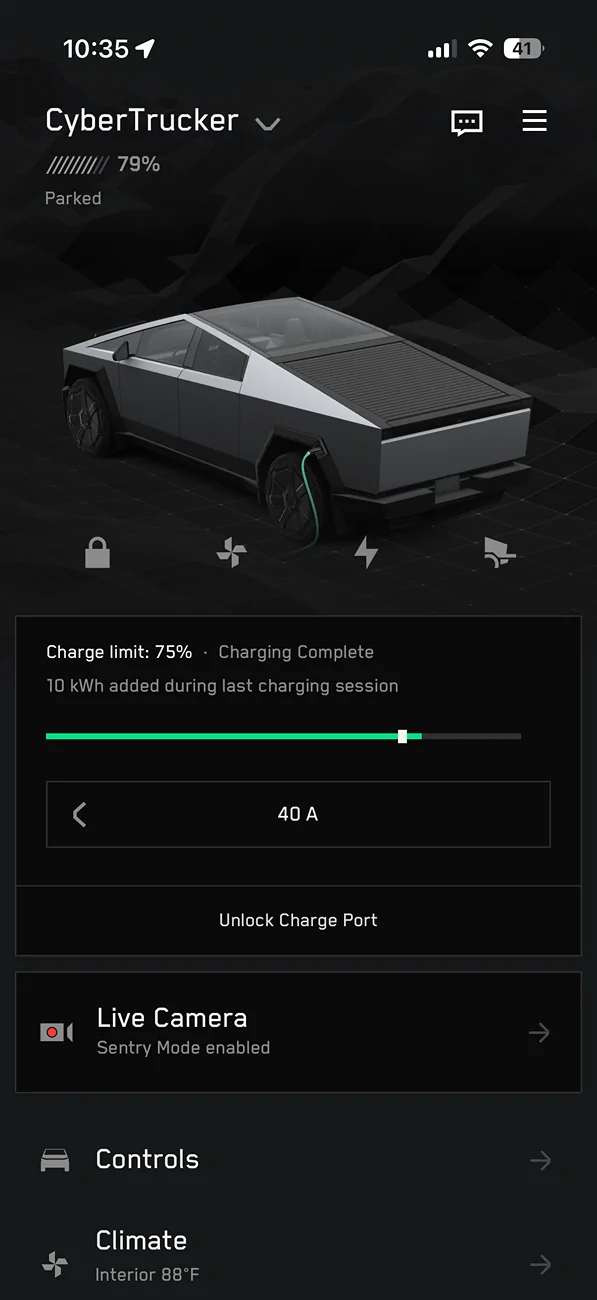

Hello - anybody as the same/similar issue ? my car keeps on overcharging since 2025.XXX , when i set a limit it keeps going beyond that limit. Anyone else has this weird issue ? PCS was already replaced march/2026 model is 2024 FS AWD with 25k miles on 2026.2.9.1

That’s odd, I don’t have this issue but curious if does it eventually stop a few % over or just keeps going to 100?

i have seen between 4 - 5 % overcharging consistenly, but also have a hard timer stop due to my electricity plan

I would put in a service request and specifically ask them to check the software. Maybe it’s a simple OTA fix.
(24AWD 35k miles)
I recall many years ago, the SC had to “factory” reset my 17MS to recalibrate different items with the software stack. Which fixed the similar issue. Just sharing additional experience.

What is the temperature? I wander if it has to do with either predicting cold, and knowing it’ll have less range, so here is 80% (but will be 75% when cold), OR it is cold, here is 75%, then warmed up, and now there is 80%.
I feel like I saw this happen to me a few times. As well. Also do you charge at more than one location?

This is it. It's getting warmer.

It will do this with mine when the temps are low at night when it is charging to my limit. In the day, when it warms up quickly and the sun is shining on it, the range increases.
