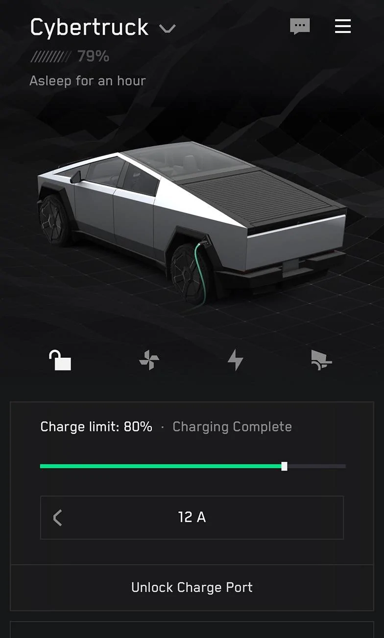

Charge limit set to 80%, truck is asleep at 79%

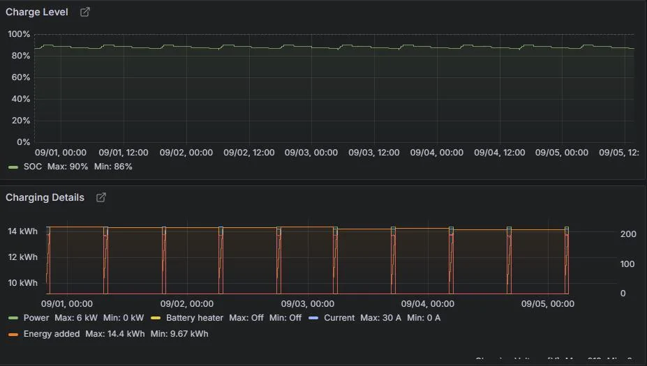

You will notice over time that the battery will charge according to projected needs/trends. For example, I can set the charge limit to 56% during the spring and summer, and it will charge to that target (and of course decrease during the day as it uses energy for various standby sytems).
During the colder months, I can keep the charge limit at 56% and when I check it first thing in the morning it can be around 62% or 63% sometimes. The algorithm knows when colder weather is coming and adjusts accordingly.
I suspect the vast majority of people have never noticed or thought about why that happens.

Just FYI. This thread isn’t about range loss as so far I don’t have any.
I was just curious why the truck wasn’t charging the last 1%.
It did, but the battery cooled. That SOC reflects an estimate based on temperature. A few percent “loss” is typical in cooler weather. If the battery heats up, it’ll show 80% or higher.
