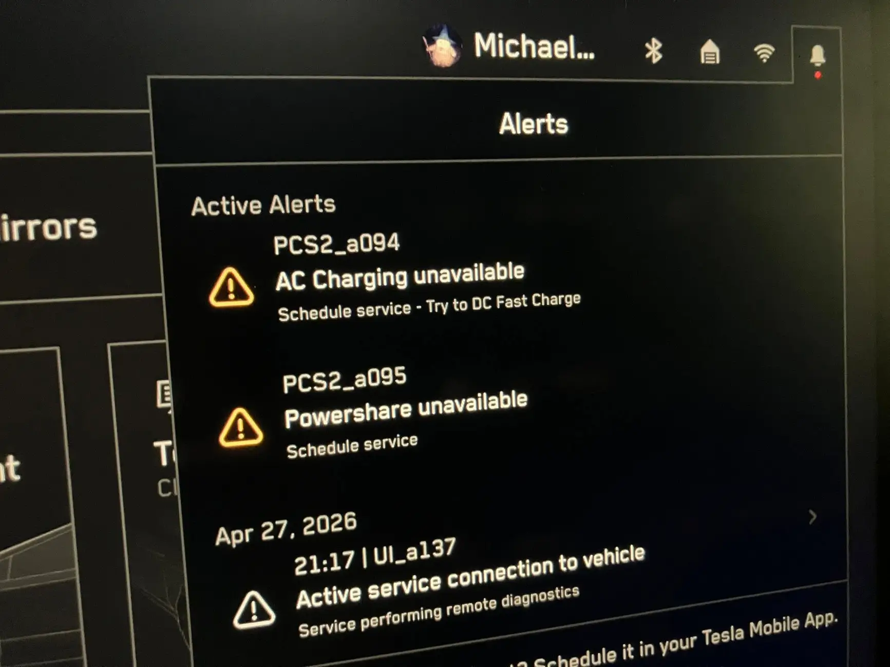

PCS failed last month - service center told me three weeks ago Tesla would reach out by vin to schedule replacement- anyone have any updates on when PCS parts are being shipped or installed?

My appointment is June 10, prolly be pushed out who knows. Failed around April 7. I still havnt gotten free supercharge update which sucks bc I have to drive 30 mins sit fo hour 15 mins and drive back about every 3-4 days.

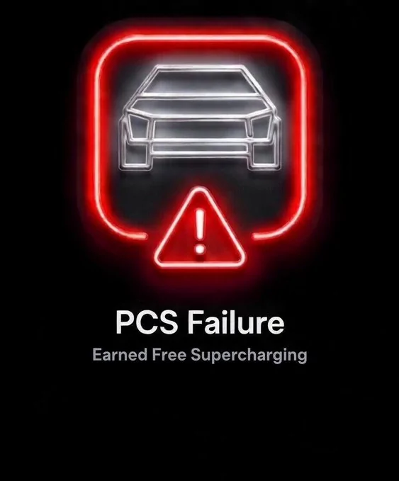

Mine failed 13 June 2026 (2024 Beast), I'm in upstate New York, checked in with my Syracuse service center, no part yet (26 June 2026). However, I got free supercharging immediately even before I noticed the fault, and have been super charging for free ever since, saves me electricity at home for sure.......

Mine failed early April. Was replaced end of the month. Now it’s failing again. And I had the G revision part. They are now pushing me into July/August saying awaiting parts. They have not replied to me if there is an even newer part to come and why my recent replacement is already failing. Probably bad news to those that had theirs replaced already.

My truck only charges at 24 amps now and my PCS was replaced last year so this will be my second failure. I had an appointment for Monday, July 6th. They just sent me a notice to reschedule to July 30th. I have no idea about parts availbility, but I am not optimistic

Prepare to have that pushed again. Enjoy free Supercharging while you wait.

They have yet to offer me or give me free supercharging
Check in your truck, it happens automatically now. I received Free Super Charging the moment mine returned a failed tests and others have as well. They no longer explicitly tell you, it just happens.

When they rescheduled my appointment, I asked about free supercharging and they said they have now added it to my account.
However, yesterday we needed to use the supercharging for the first time since that was promised and they billed me. I contacted support in the same thread they confirmed it, and they pushed me off to another department. Pffft
It takes a few days for it to show up on your app. Mine was an issue with the computer receiving the free update. Service center manager had to fill out a forum on the computer and send it up the ladder to his boss for the rubber stamp of approval. He was on vacation, took 7-10 days or so before I noticed it in the app that it was now “free expires Aug 15” or something like that.
