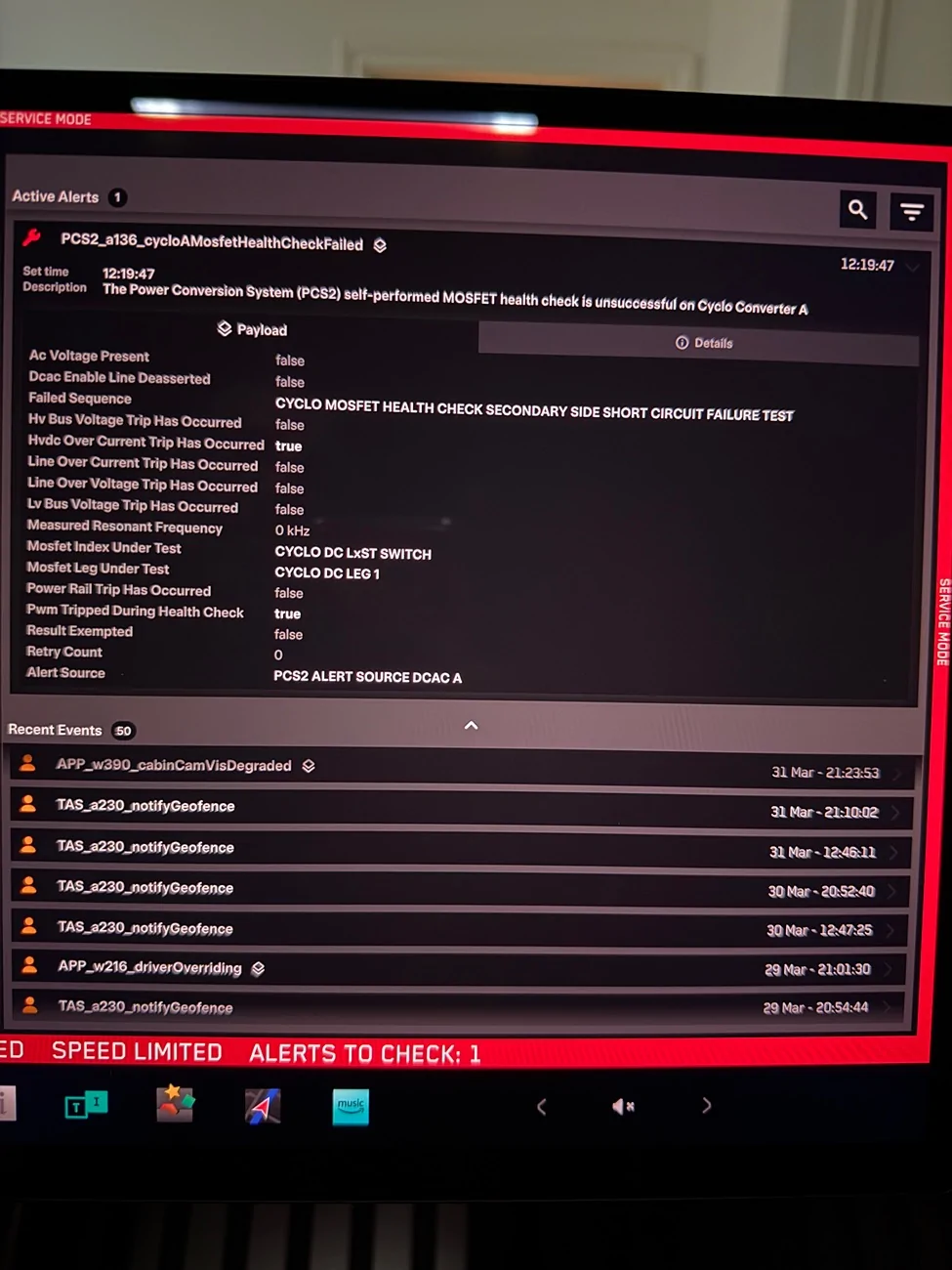

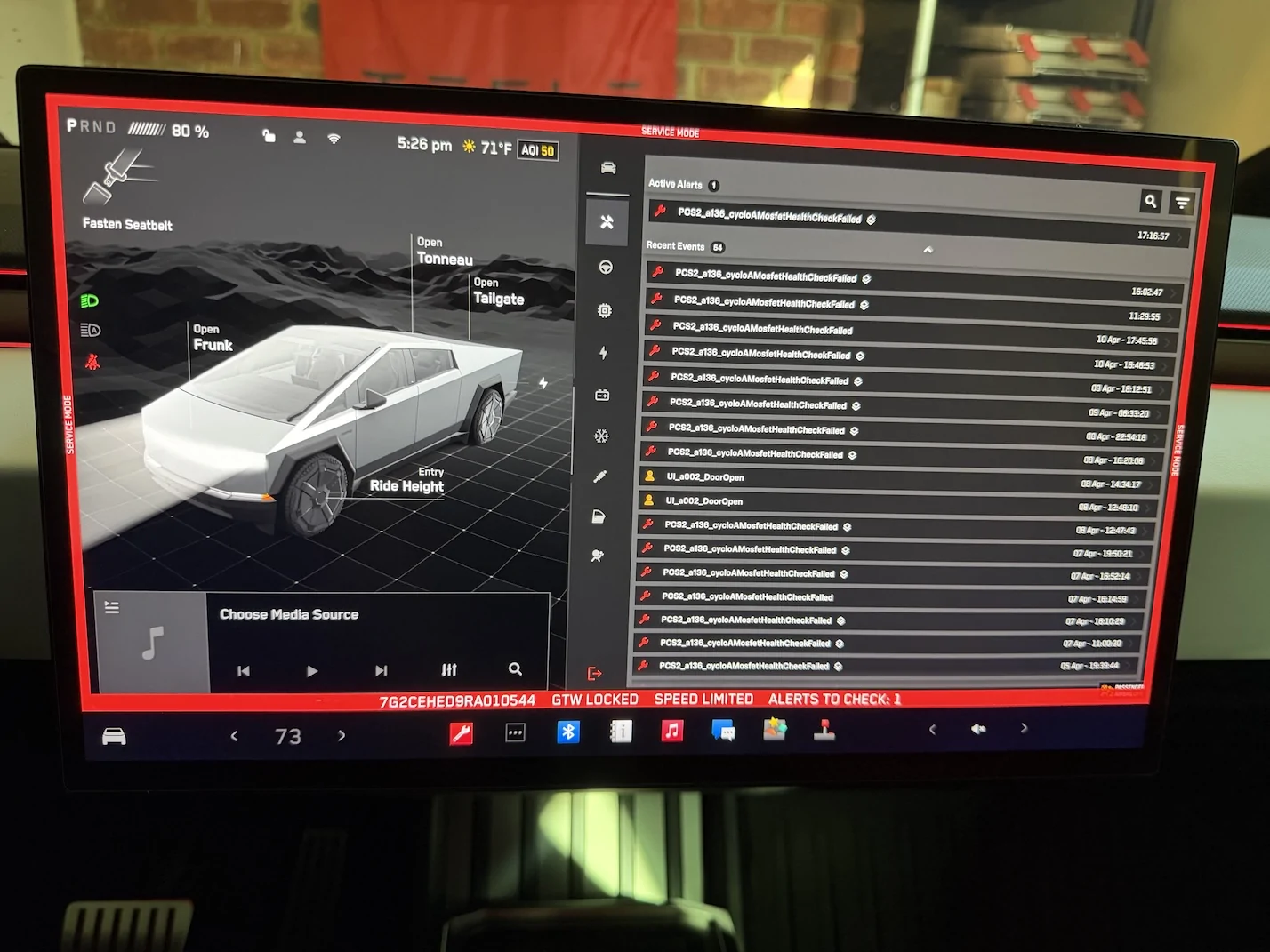

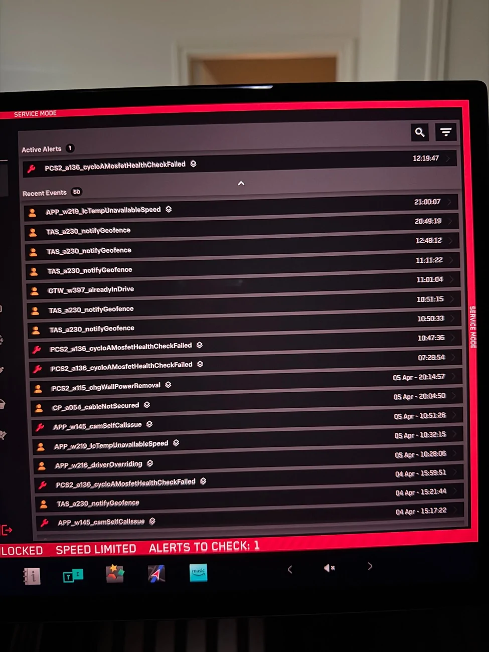

Looks like I'm joining the PCS failure club. No actual problem has manifested, but I'm seeing continuous health check failure warnings in the service menu. Charging at home is still running at 48A like always.
‘24 AWD Foundation Series
VIN 10,5xx
Delivered 5/08/24
14,456 miles
I have a road trip from Atlanta to DC coming up this Friday, I seriously doubt I can get it replaced by then (I just submitted a service request, we'll see).
I haven't experienced any actual charging issues, and it's never popped a visible warning to me, I had to go look for it in the service screen. Should I not worry about it and get it replaced when I get back? How long did some of you get warnings before an actual failure?

If you go into service mode you’ll see if you have a pcs warning.
