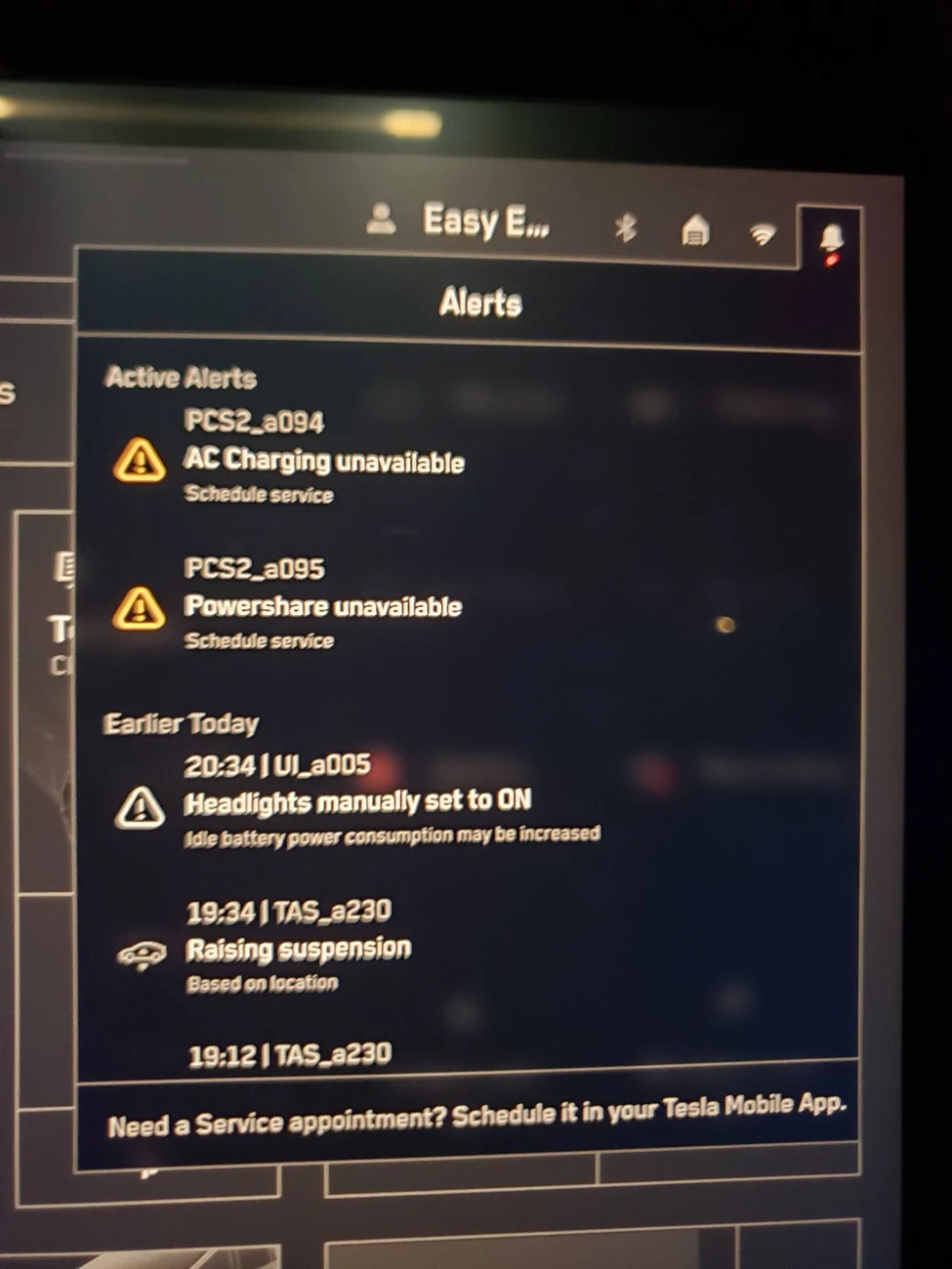

I've officially joined the PCS failure club this morning. I noticed a day earlier that my NOV 2024 AWD CT with 29,000 miles (VIN 397- -) stopped short of charging to my normal 80% setting, but didn't think anything of it until it happened again this morning and the CT the screen had the dreaded PCS2_a094 Message. I tested it at a Supercharger which worked fine, but I'm going straight into a Service Center tomorrow.

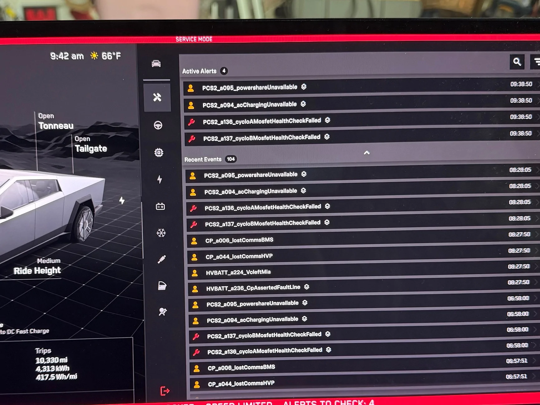

CB vin 34xxx PCS failure, AC unable to charge notice. Early sign was home charging 2% less than what was set (78% instead of 80%) 2X, then only charging about 6%, then AC charging unavailable error. Soonest Tesla SC appt scheduled in 10 days, 2-1/2 hrs away (parts in transit), Supercharger 30 mins away, with no guarantee that will work. Sitting at 73% charge, effectively unable to use now, but hoping to make it to my appt. Added the cantrail recall and the TSB to Inspect Door Assemblies For Low-Pitched Noises And LH Side Mirror Shaking SB-25-10-002 September 19, 2025. Hopefully will get a Cybertruck loaner, Also had a PCS failure on my FS Cybertruck at around the same mileage(18k), but in that case allowed me to still AC charge at 24a till the SC Appt. It’s just part of the experience of owning the best overall EV, do it all Truck out there (except of course towing long distance and in a hurry lol). Once you go Cybertruck/Cyberbeast (we have both), IMO you can never go back.

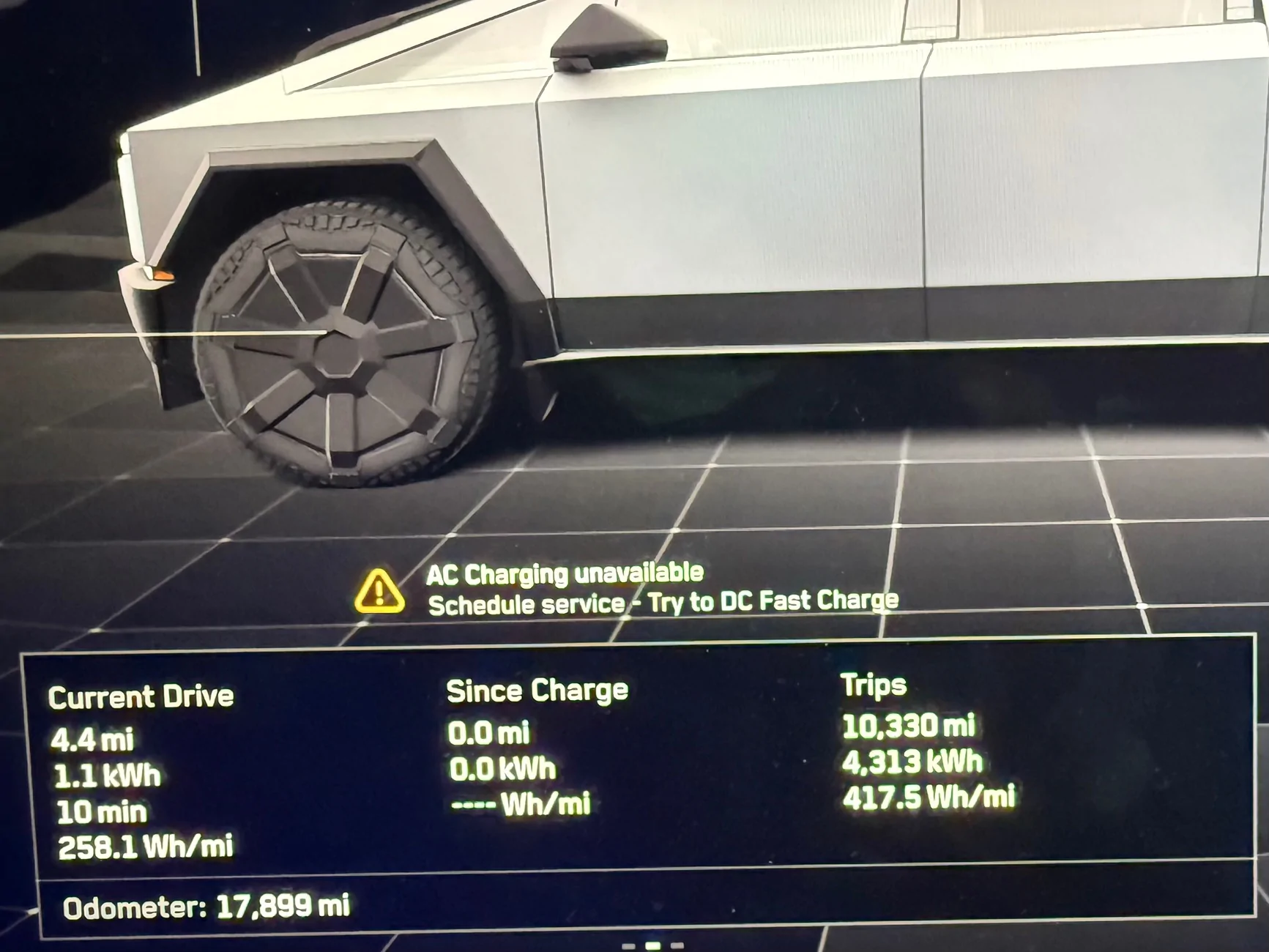

2024 Foundation Series here.. 17k miles, mostly home charging. Failed Tuesday, parts not available until late June. Supercharging is working but very inconvenient. This sucks,

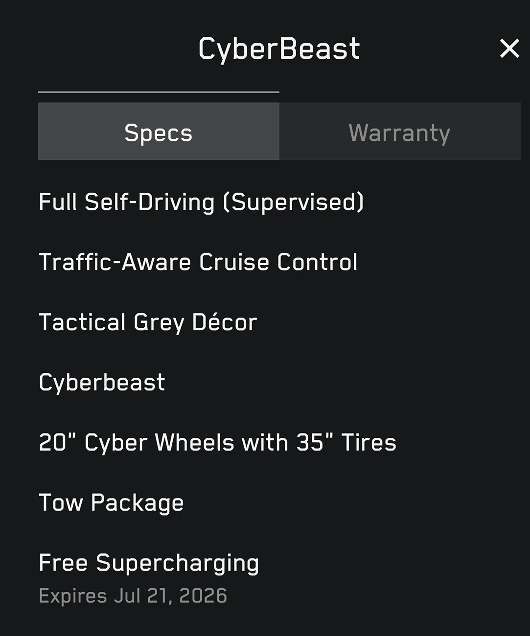

Yes! Just showed up today on my app under specs -90 days free supercharging from the date that I got the notice “AC Charging unavailable” on my CB display.
Did you specifically have to ask for this and if so, who should I talk to? Thanks!
