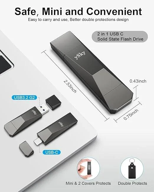

I found and tested what I think may be a perfect USB drive for the Cybertruck. I also have some tips below for people who may be confused about how to use USB for both Sentry/Dashcam and music/media.
The USB drive I'm referring to can be found on Amazon here: https://www.amazon.com/dp/B0CRRF6J9Z
Even the shape is perfect, check it out:
Tesla Cybertruck Perfect USB drive for the Cybertruck (plus tips for media files) 1728820722061-16
  • The drive is 1TB, so plenty of room for sentry mode recordings and media
  • It has both USB-A (to fit in the glovebox) and USB-C (for computer/laptop)
  • It's small, so no problem fitting in the glovebox without an extension
  • It looks like a freaking Cybertruck

I got the ySky USB stick, in part due to the dual-USB; it can be plugged into my phone to add/retrieve files.
In use, it got VERY hot, like painful to touch. It burned out in a month.
I thought the high-capacity was too taxing, so I dropped to the 500G unit. It too lasted only a month. I’ve gone back to the Tesla-supplied stick for now.
