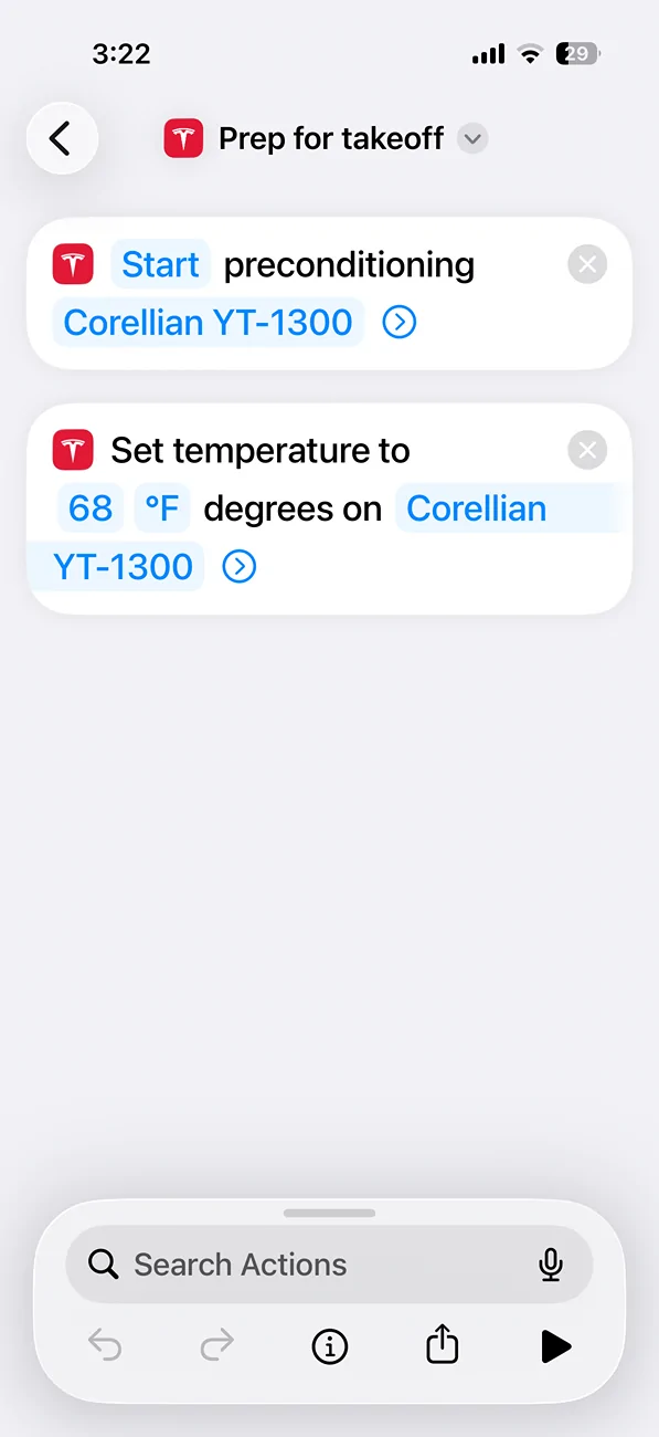

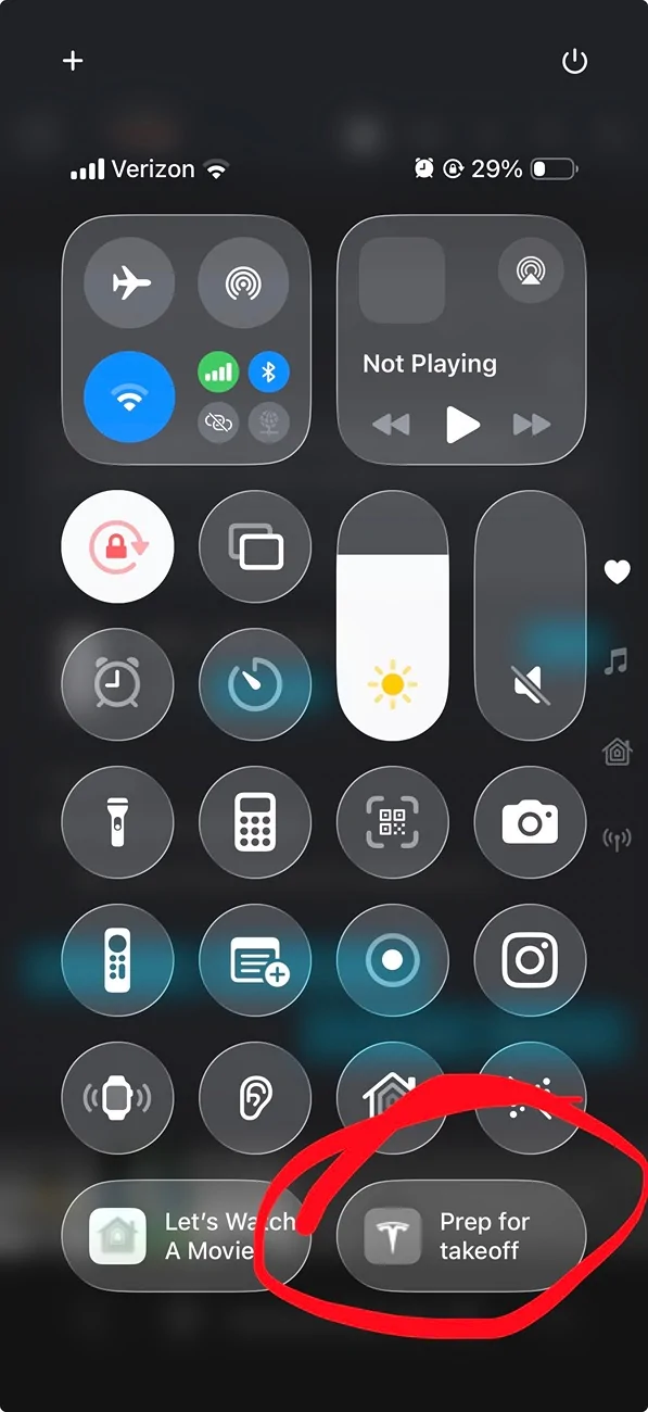

ive made this voice activated (and button activated from control center) automation in ios:
Tesla Cybertruck Precondition battery in app IMG_1451
Tesla Cybertruck Precondition battery in app IMG_1452
so I can start preconditioning/warming up as I leave work and walk to the parking garage.

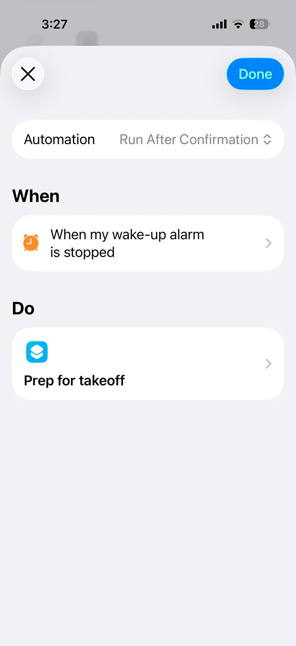

its also invoked when i turn my alarm off, as long as I tell it to after asked:
