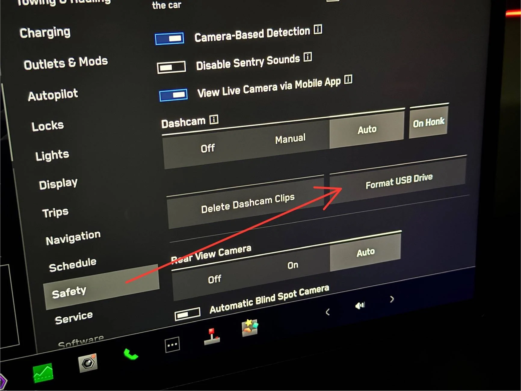

Well, it worked after erasing the thumbnail drive, and reforming it to fat32 but now the dash cam and security files don’t know where to go. I think if I make some directory files for them, that will fix it. I was not able to partition the Tesla thumbnail drive. I don’t know why, but it will not allow it. If anyone knows of a good workaround, please let me know.
Here the deal, if you reformat the USB on your computer then you have to manually add the Sentry and dashcam folders in. Otherwise they don't know where to save. Check the manual for naming conventions. There's a section telling you exactly how to do it.
If you use the truck to format it then it should automatically add the proper folders.
Be sure to select the correct switches in Boombox.
