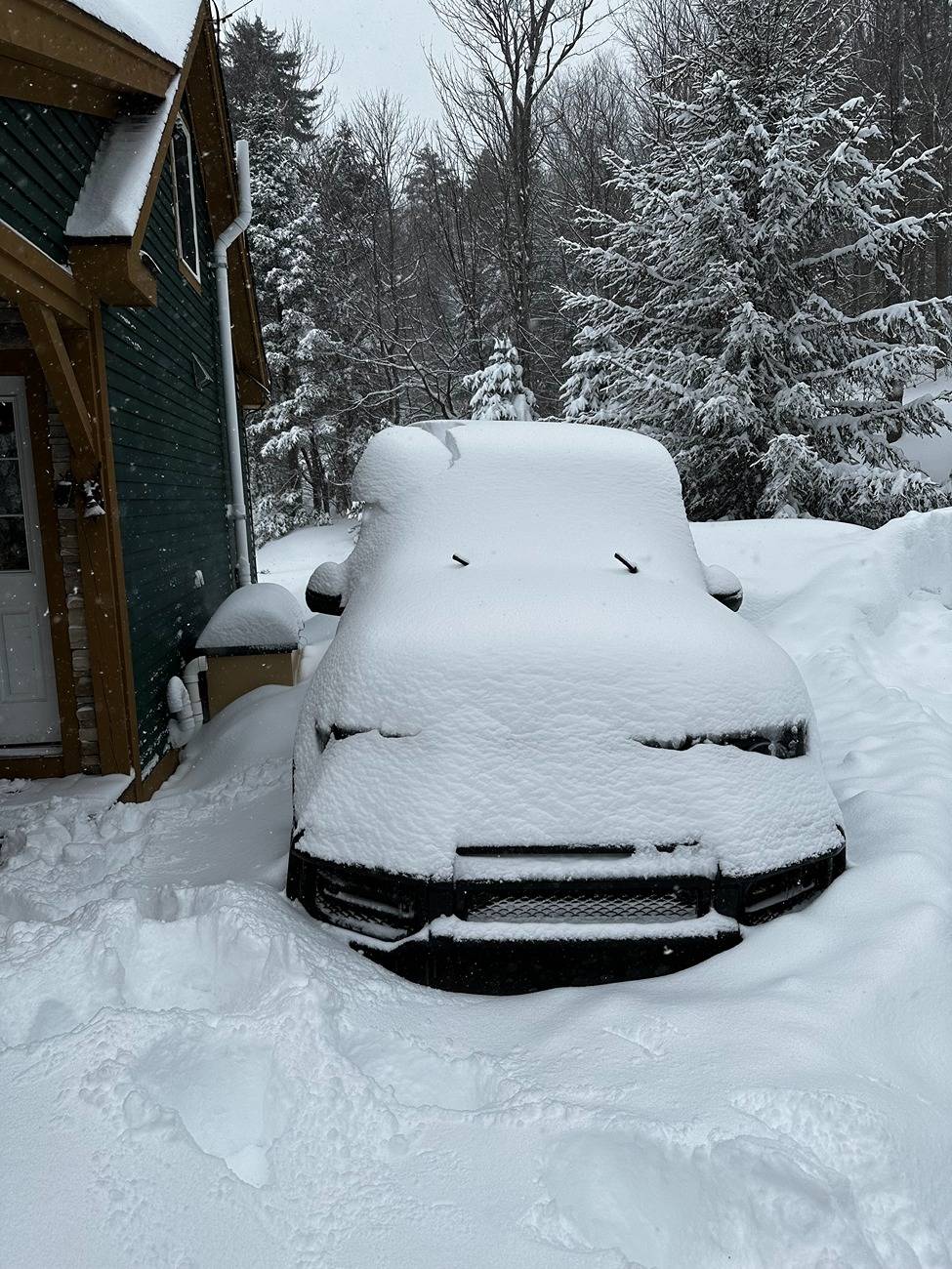

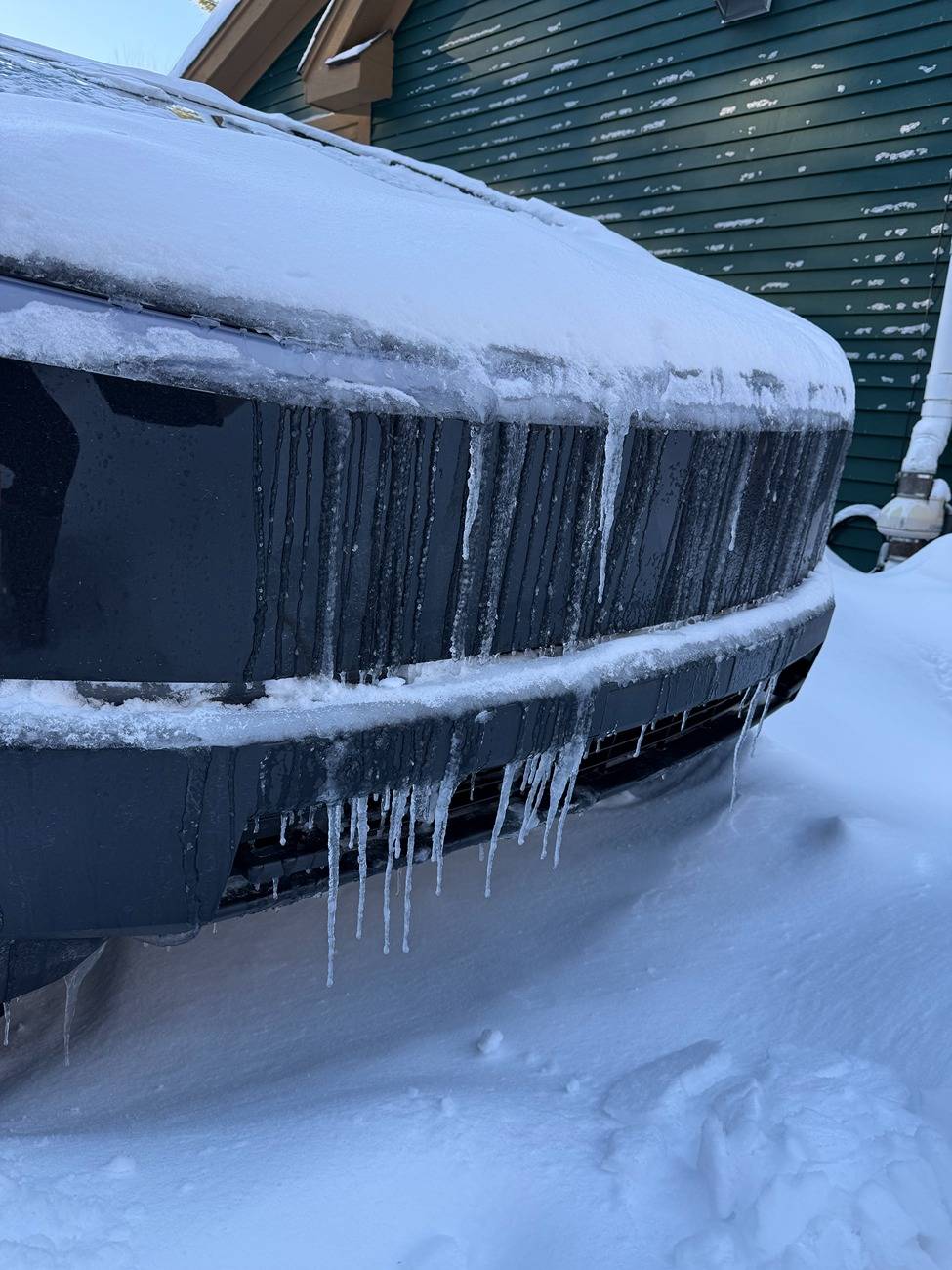

(Video + photo). Welp, I love my CT for 97% of the time. But I have all but given up on it as a winter vehicle. For the last week, my tailgate, tonneau and my frunk are all frozen shut. I tried a hammer and chisel but I its just too risky if I missed and hit the lights or scratch my 3m wrap
The worst part is the ice on the lights. I can not drive at night way too often. When snow melts, it accumulates on the lights. Or I defrost my truck, the streams melt down to the bumper and build an ice dam. The other evening I had some one signal my lights aren't on :-( (they were, just covered in ice)
I'm taking unusual steps to keep my lights clear - but a short drive to the market in 10degrees (f) and Im just an eager beaver creating a ice dam.
I love how the truck drives, FSD is so good. My truck bricked once and stranded me, it makes so many squeaks etc, but Im good with it. But I am really bummed out about the lights being covered in snow and ice all the time.
(here come the fair weather folks to tell me to just "wipe it off " :whistle:")

are you sure the heated wire isn’t contributing to this issue?
I don’t get how you have so much melting and refreezing like this as the frunk is not heated.
We are peak winter here in the north east. We just had 14” of snow in my area and my vehicle is parked outside, and I have nothing like what you show on your CT, and I barely brush off my CT.

are you sure the heated wire isn’t the cause of this issue?
Hi Mark - Glad you are having better luck in CT (the state, not the truck :). I know they got the storm Sunday this week, alot of east coast hit hard. (great for the ski mountains!!). In Vermont, we are getting snow every other day it seems which might be the difference from an occasional storm.
I take the truck to the ski resort and park it all day. It snows an inch or two often. Sometimes the sun melts the snow on the windshield, sometimes when I preheat the interior, the snow on the windshield slides down onto the hood. It keeps the windshield totally free of snow and ice - but that snow and ice trickles down over my hood and down the face and build up on the little ledge. I think I am experiencing that problem. Almost as if I need to avoid thawing the windshield, which is heated up from the interior to avoid the melt quick freezing on the no-heated ledge. The defrost is amazing btw!
But, I get it - I might be the edgecase living in a cold snowy state. But that edge design is a major and dangerous design flaw. Eager to find a fix of some sort.

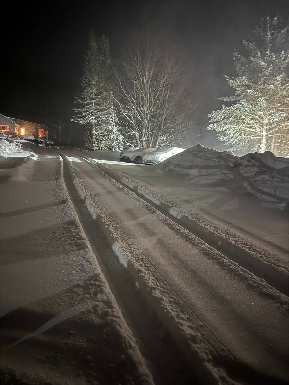

Here's my G covered and part of the road to my house!

When I saw your pics and read your earlier post, this was exactly what I was wondering: defrosting the vehicle and the melted snow is dripping down over the head lights. Still, not a good situation / design but maybe there's a way to reduce the amount of ice by not defrosting for as long.
When it's cold and the snow is fluffy it brushes off easily so if there was no ice when you parked it avoiding using defrost and brushing it off first is probably the answer. Also when driving turn off defrost a bit before reaching your destination so the windshield is cold when you park and new snow won't melt and freeze on it.
