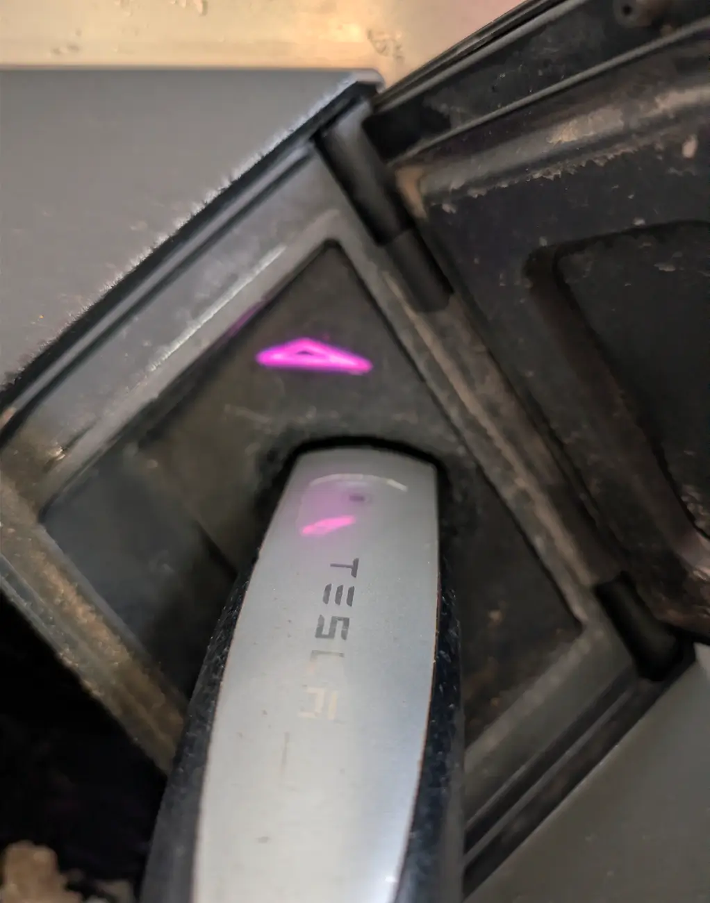

Purple light when charge bay door opened but unplugged?
Jabman
Dec 3, 2023
621
1,076
New Jersey
Tesla Model S, Ram 1500

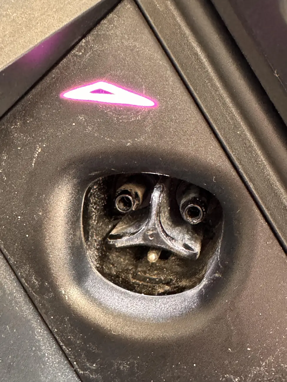

Looks like your charge port needs cleaning.
Not likely. I stated before that I had this issue in December and took it in for service in January. They checked it out. Said nothing is wrong with the port and the lights were likely due to cold temps

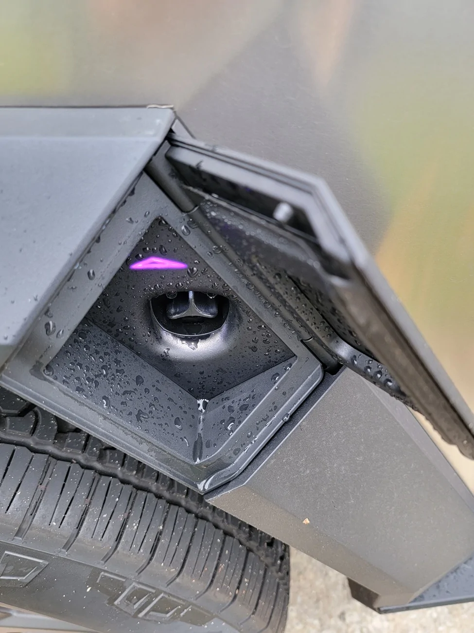

Purple is the new green.
Had this happen in both my trucks. Both had the charge port ECU replaced.

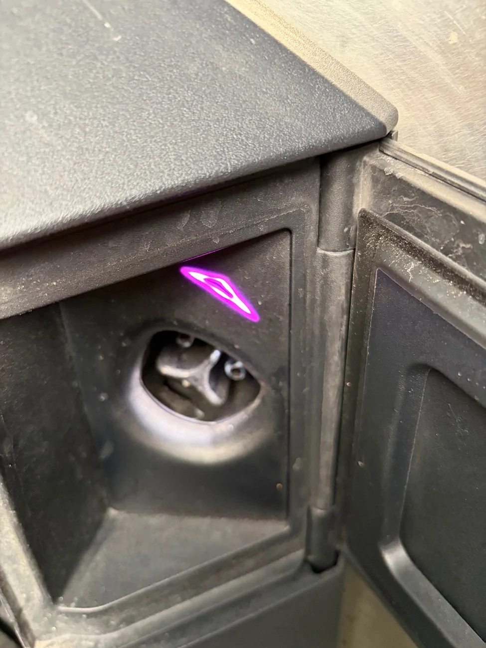

oh man, so it didn't "go away on its own" for you?
looks like I'll submit that service ticket then

They need to replace the charge port door and/or charge port ECU.
When you go to a supercharger it turns red sometimes.
