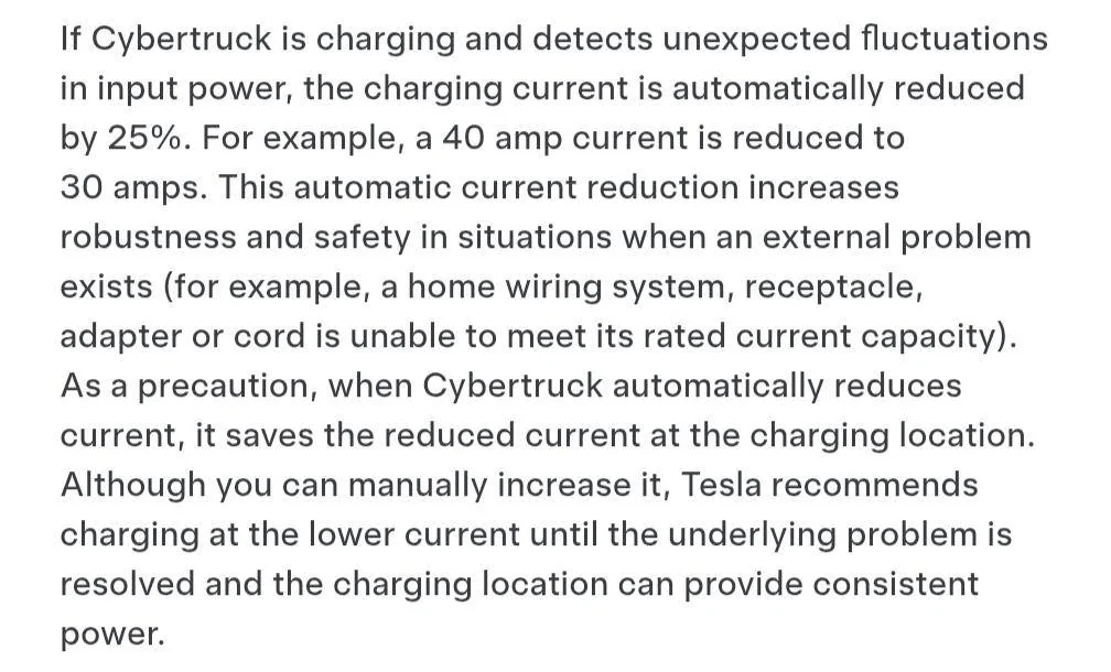

Tesla Cybertruck Charge port blinking amber; but app and truck says I'm charging at 240v, 48a 1000001936
Did you guys catch this part? Check to see if your house is under an increased load and inducing arch flashes and other noise. It's winter, so you could be running more electrically dirty appliances than other seasons.

Did you guys catch this part? Check to see if your house is under an increased load and inducing arch flashes and other noise. It's winter, so you could be running more electrically dirty appliances.
Thanks for this. I did not read that, however, the amps of my charging session still say 48a! Both in the app and the truck so I’m not sure if this applies to my case?
