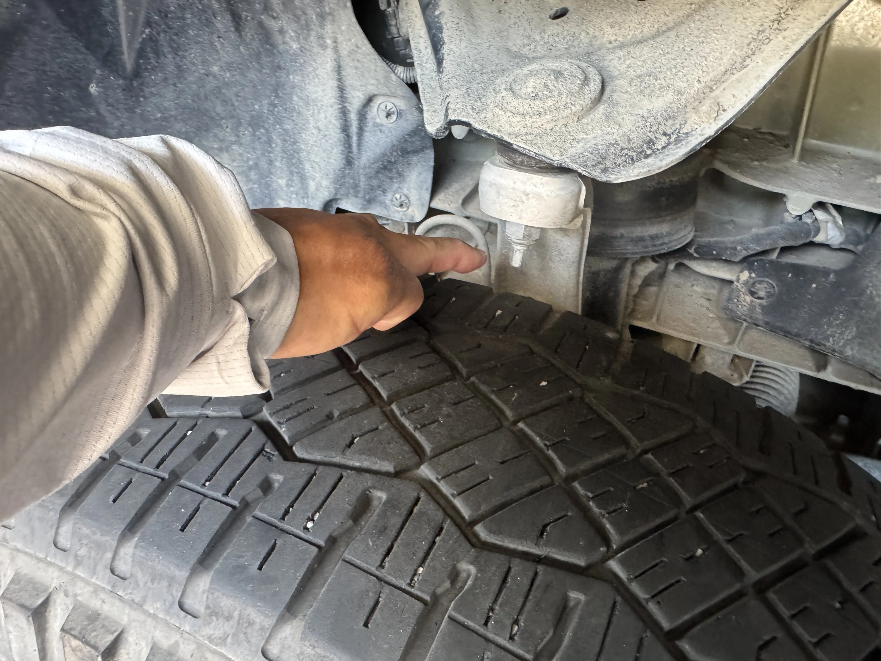

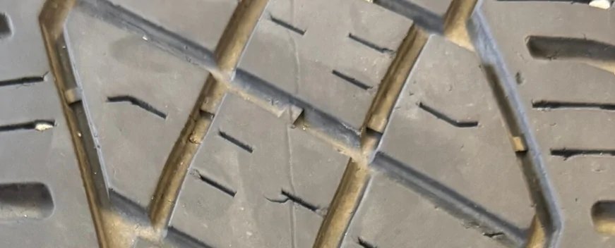

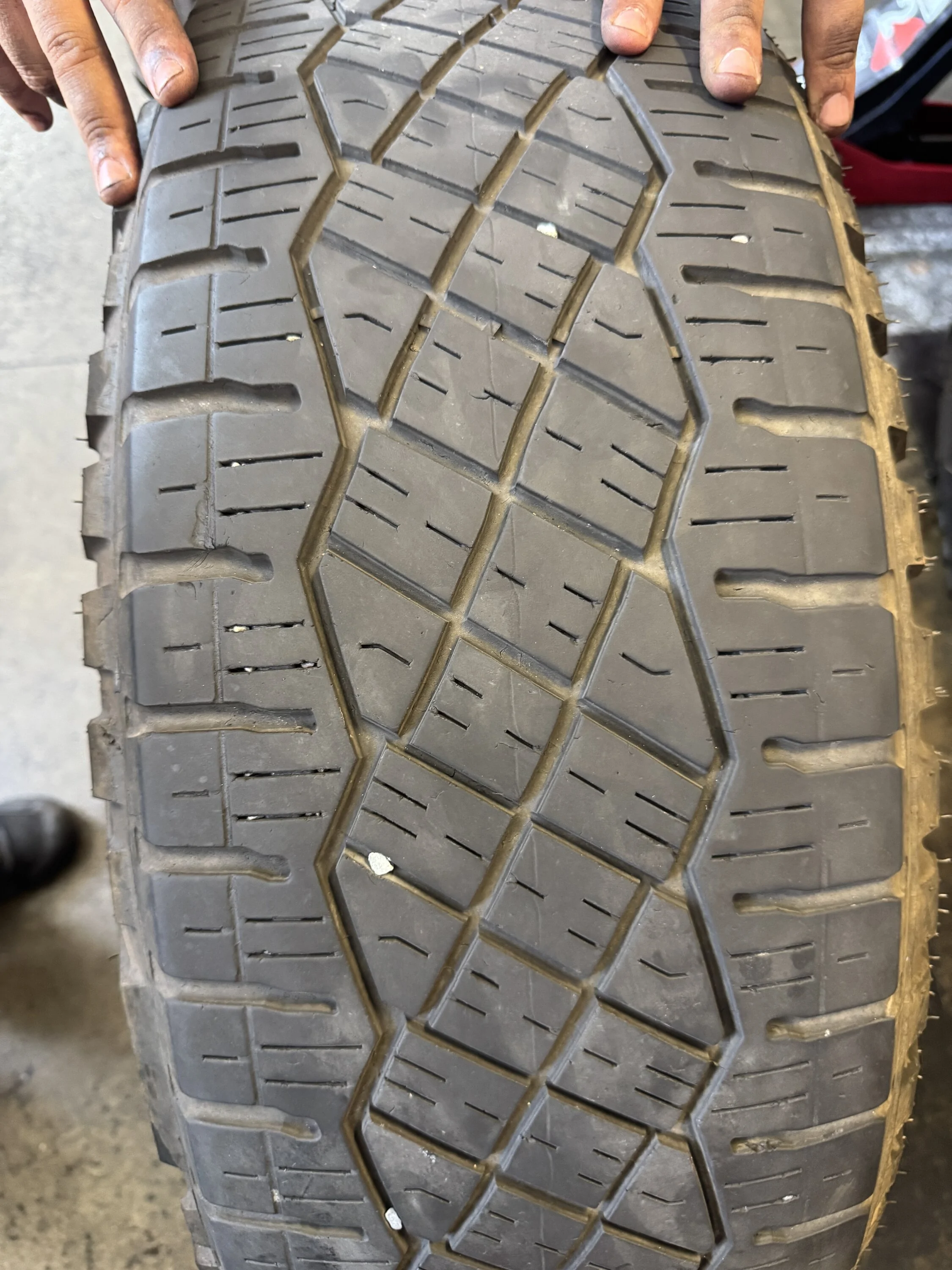

Recently, I noticed my Cybertruck starts to shake when driving over 75 mph. I initially thought it was a tire balance issue.
My current odometer reading is 21,600 miles, and the last tire rotation was done at around 7,000 miles. So I stopped by America’s Tire to get a tire rotation and balance.
However, when they removed the tires, they noticed significant uneven wear on both the inner and outer edges of all four tires. Due to liability concerns, they refused to rotate the tires.
Is this kind of wear normal for Cybertruck OEM tires?
Should I consider replacing them now?

The negative camber on the CT is pretty significant at low suspension height, im sure that contributes, you can try to talk to your SC and see if they will warranty them, but they explicitly say that tired are not covered under basic vehicle warranty.

Not sure what second photo is showing. The upper control arm bolt cannot contact a properly inflated tire. They are rigidly mounted to the same knuckle/ hub structure.
If all four inners are worn more than the outers, rotation won't help. Would need to dismount and flip the tires on the rims.
Wear bars show tread is still above minimum all the way across.
I wouldn't go back to this shop. sounds to me like they are trying to scare you into buying new tires. Tire shops are generally scumbags whose primary business model is to lie to their customers.
If you are experiencing shaking at higher speeds, then the NVH foam in one of your tires is likely to be delaminated. Someone will need to take the tire off the rim and inspect; I would take it to Tesla and have them do it so they can take that data point. Decent chance they can replace the tire under warranty (technically they don't have to, but it has happened to quite a few people).
Otherwise, you will need to get in contact with Goodyear. They have definitely sent out a few of these tires from the factory with inadequate glue.

Agree about the shaking / balance. I'm betting a piece of foam dislodged from the tire.
This happened to my wife's Model 3. Tesla glued the piece of foam back onto the tire.
