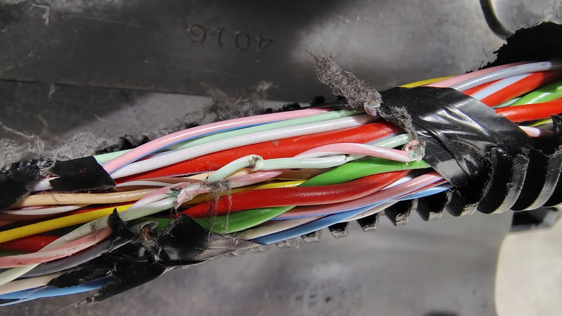

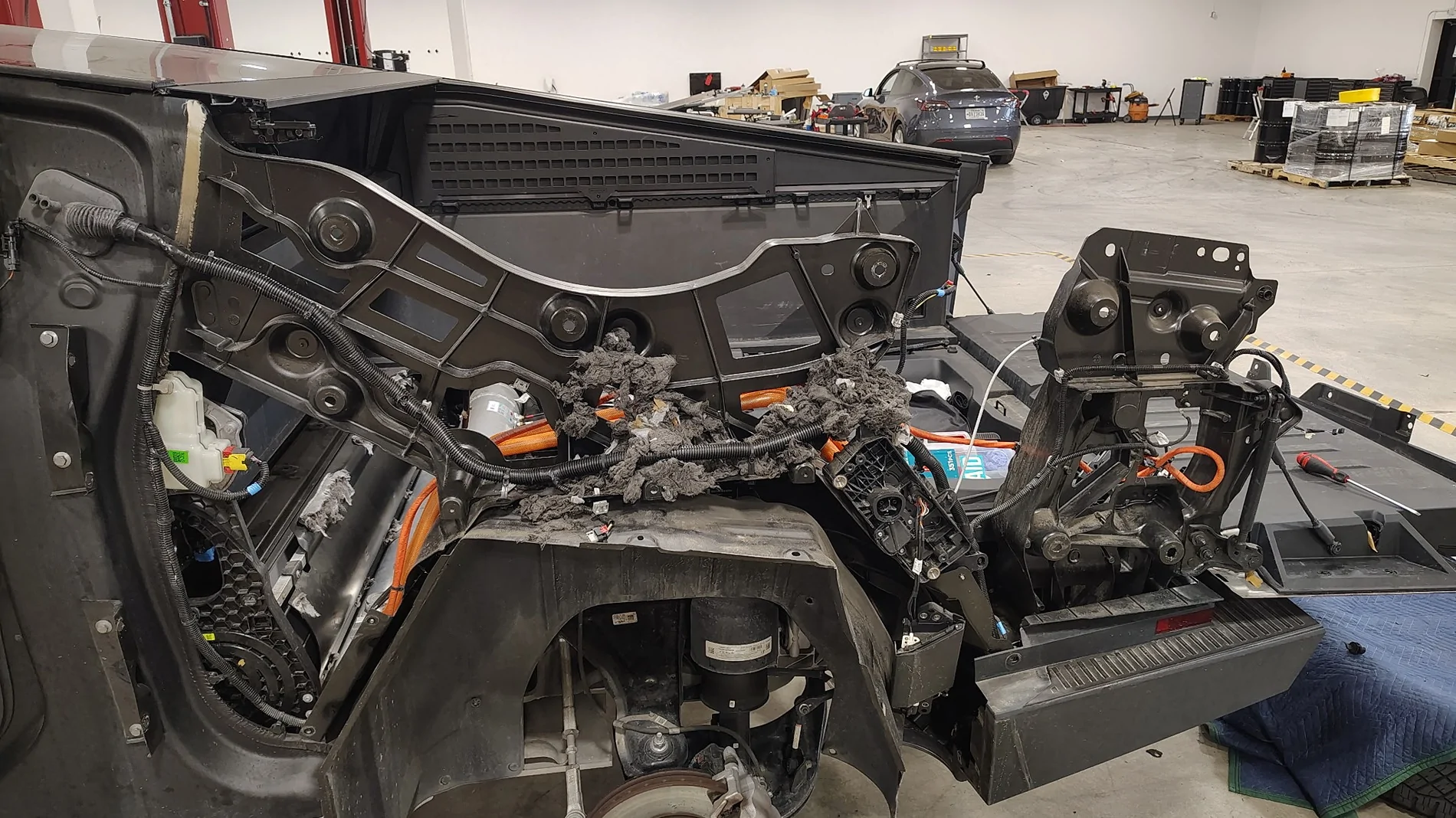

After a series of electrical alerts and errors popped up on the main screen, I took Blitzen to our local Tesla Service Center. Their findings made my stomach turn:
Rodent damage. Yep. RATS.
Now, we live out in the country—woods, pastures, horses, barn… the whole setup. But Blitzen sleeps inside a clean, enclosed garage alongside a Porsche, a Corvette, and a Grand Cherokee. None of them were bothered. Only the Cyberbeast.
My working theory? While the ICE vehicles are cold and uninviting at night, Blitzen is quietly charging with that warm hum—like a five-star rodent spa. And if the rumors about tasty wiring insulation are true… well… it’s an all-you-can-eat buffet for tiny vandals with big appetites.
The Tesla team didn’t just replace a chewed wiring harness and send me on my merry way. They went above and beyond—disassembling the entire rear section, cleaning everything out, tracking down the culprits, and making sure no additional damage was lurking out of sight. When they showed me the photos, I had no idea how extensive the tear-down was or how much effort they put into getting Blitzen back to 100%.

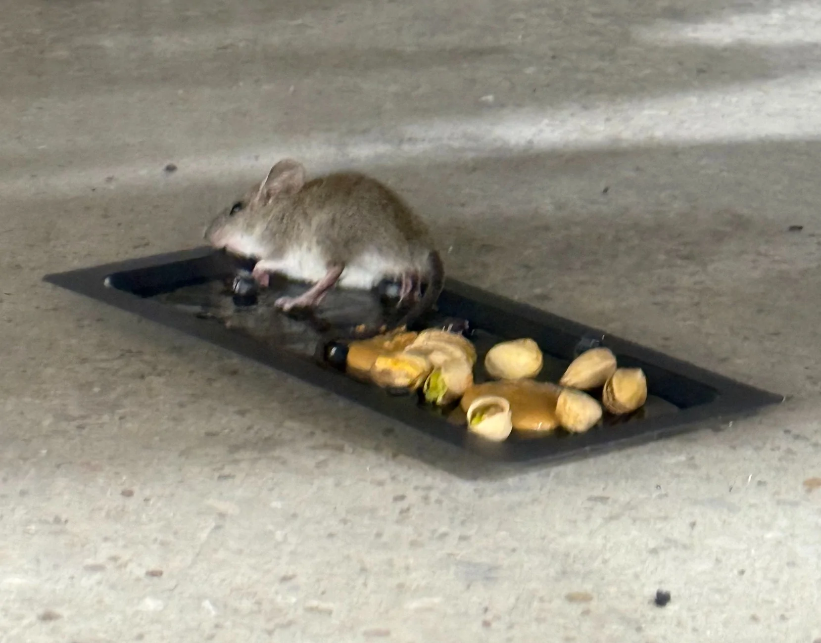

Thats a little field mouse…rats are big
rtfitch
rtfitch
Santa R.T.
Jan 17, 2020
548
1,060
www.rtfitchauthor.com
Blitzen the Beast, Sleigh
Gift Giver
Sorry, that is NOT a field mouse, it is a tree rat, common to this part of Texas and they caught not one, not two, but three...Santa has summered here for 20 years and witnessed many. One was a juvenile but it ain't no mouse.
