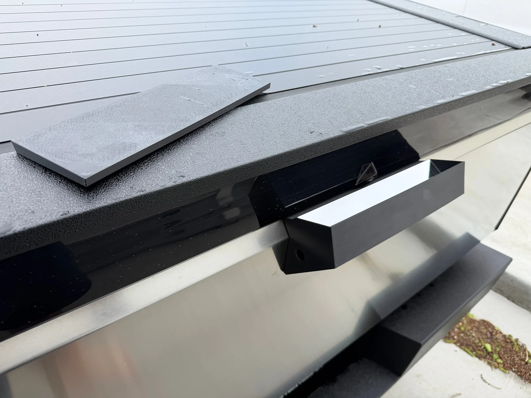

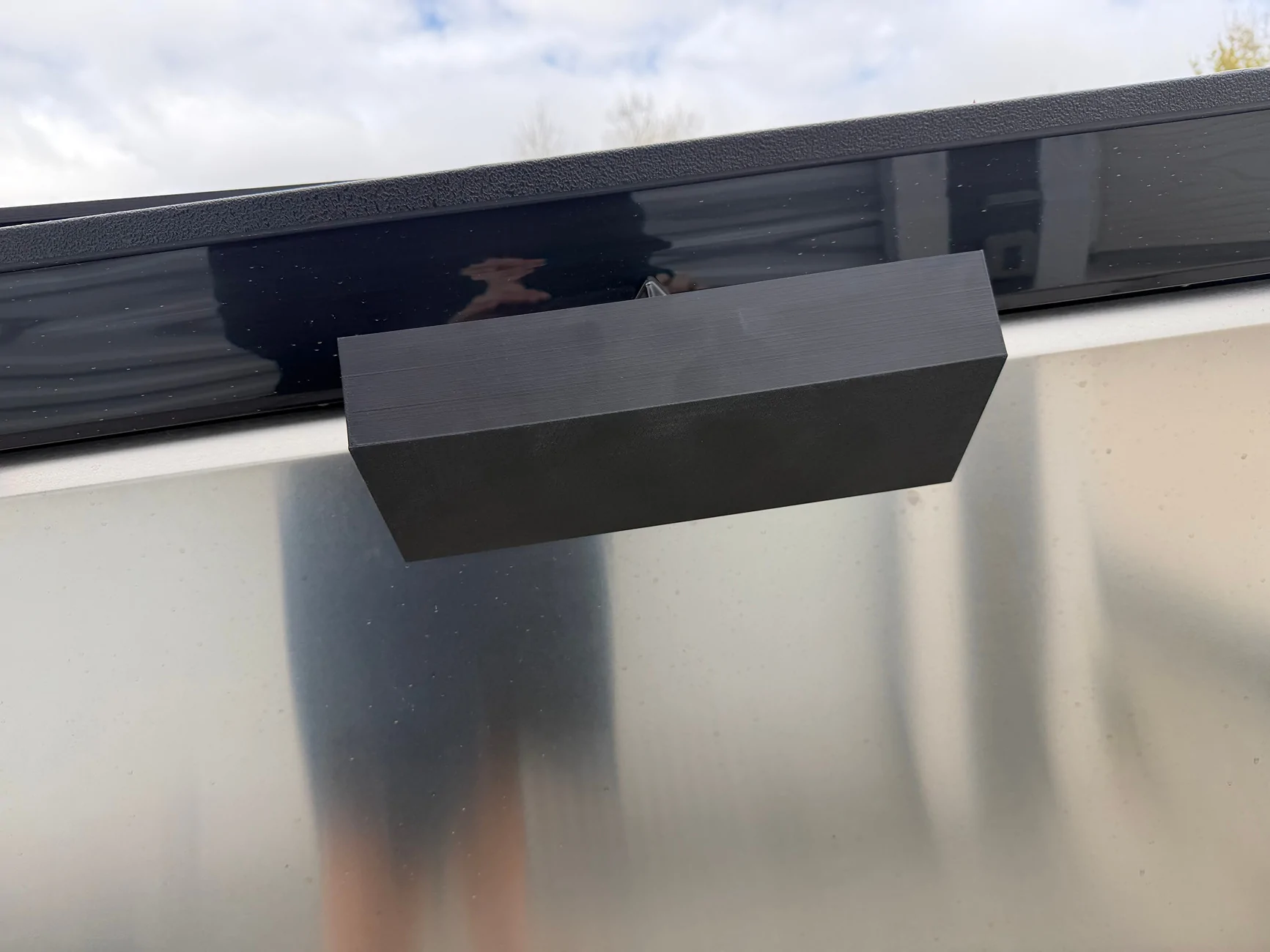

Mine came out great, ASA for UV and heat. I added washers under the magnets to move them toward the truck a bit so they hold better. Just need to gorilla tape the magnets to prevent scratching.

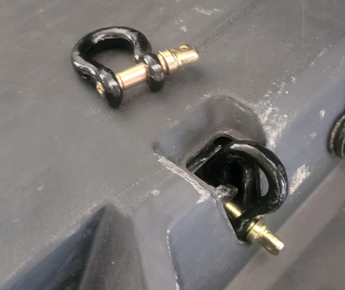

Also, I thought I'd share this. I use these 3/8" clevis pin shackles I got from the local hardware store. This is what enables me to use FSD (truck thinks the tailgate is up) but it also provides a convenient connection point for bungees, etc.

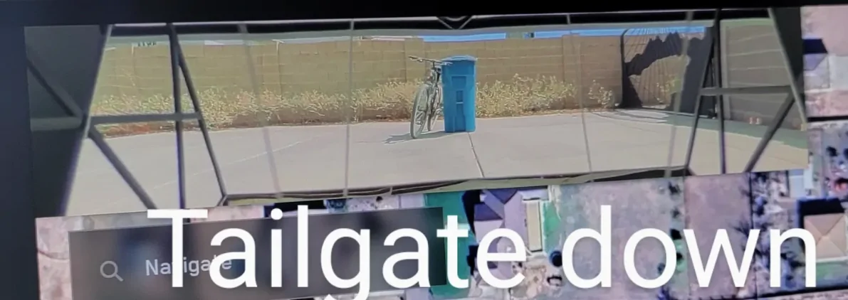

Yeah. It'll work "fine" :) You will definitely see the line between mirrors but it still a decent image. See image below of the previous model that used three 4"x4" mirrors.
