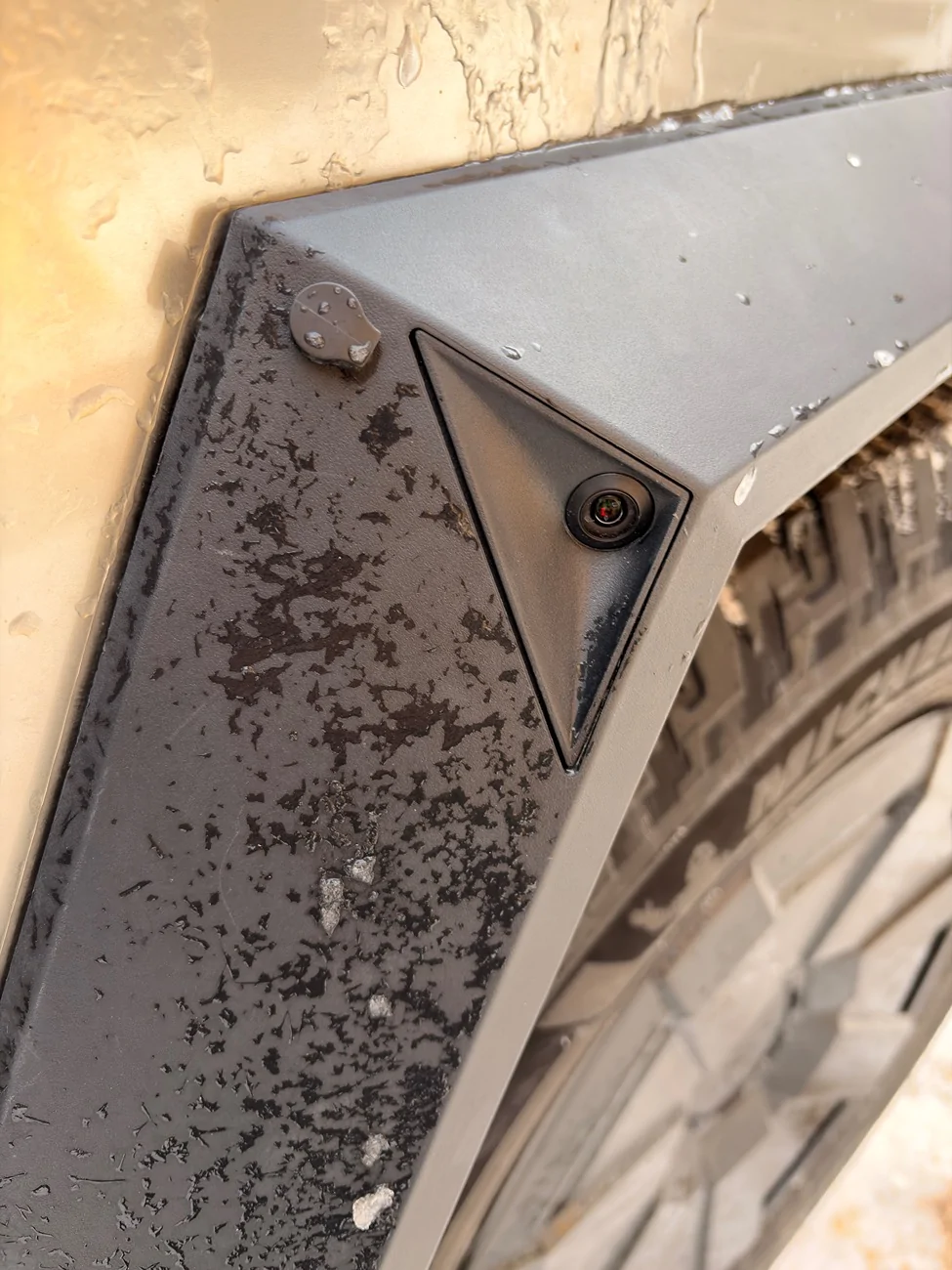

Installing the side washers is super easy, any DIYer can do it. You just make a small hole in the plastic wheel fenders. Works, extremely well.
Tesla Cybertruck (Cleavu Side Camera Sprayers) - What do think about this product? IMG_2282
While disengaging FSD is annoying, it's also understandable. For me, in winter, I often get sidecams blocked by road dirt or snow, with alerts. Cleaning is now a quick and easy fix.
The rear cam is only essential when backing up; though annoying if you can't see out. If drilling the rear hole was easy, I'd have done it already; but, I have a rattling rear panel, so I am getting that fixed first.

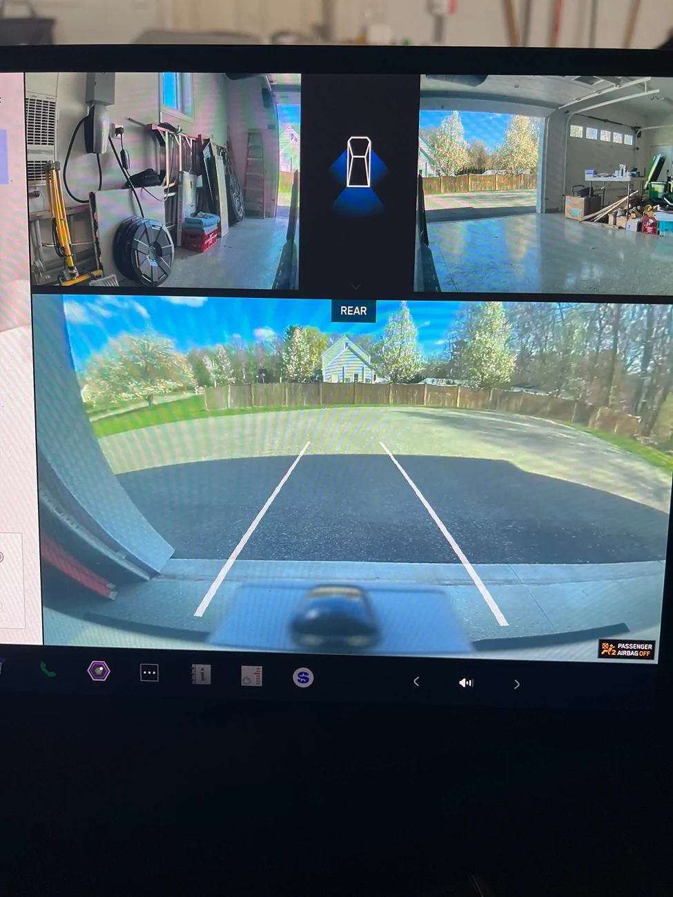

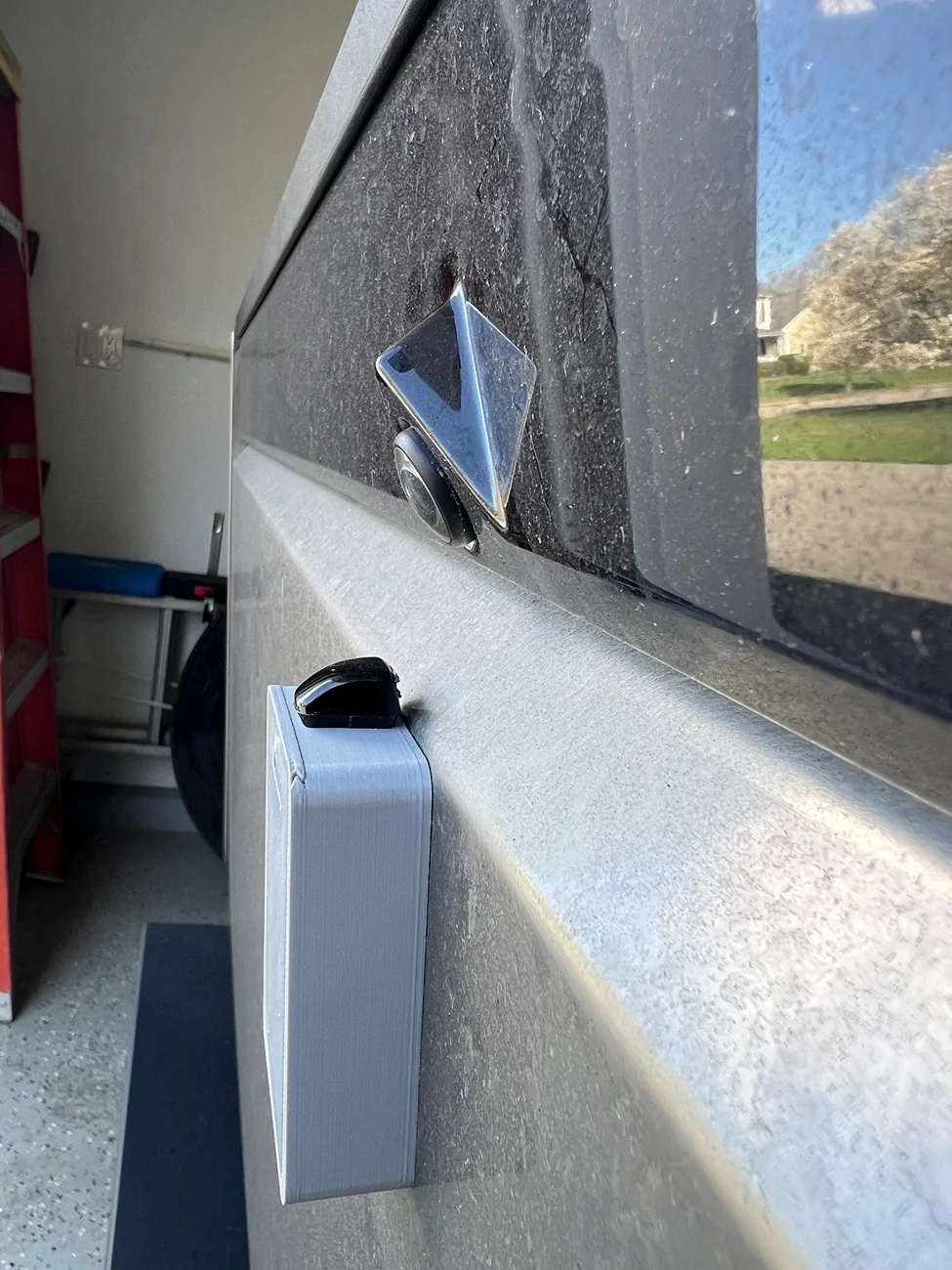

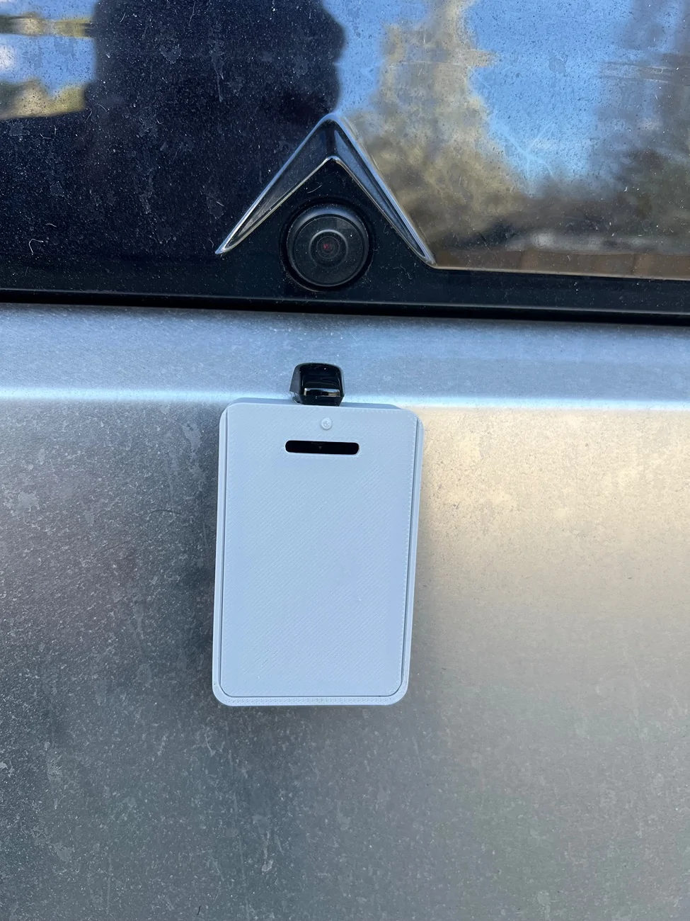

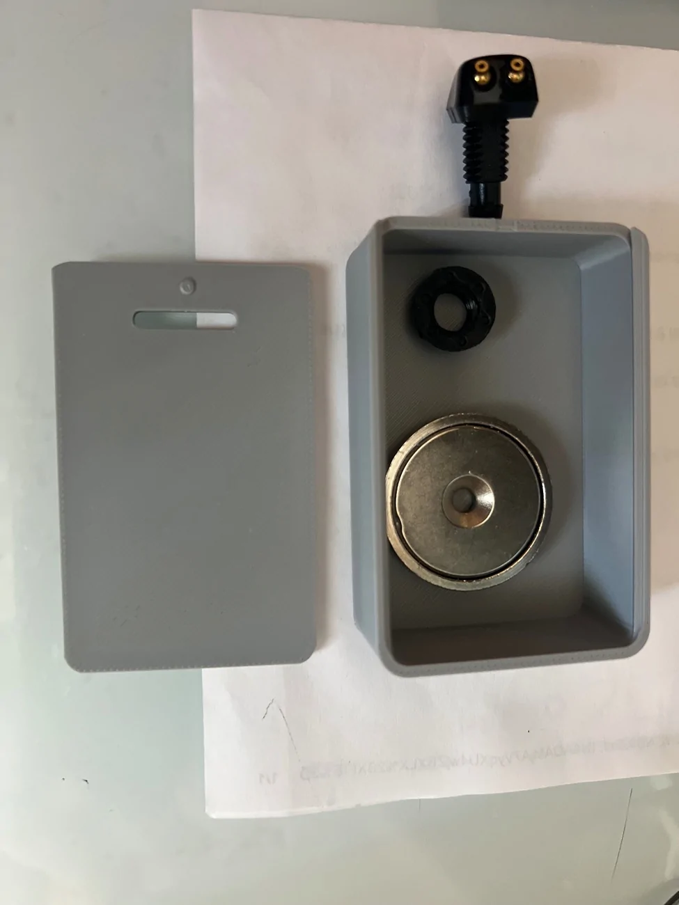

Failed experiment, 3D printed a small box, used a leftover Neodynium magnet, and positioned as close as possible under the rear camera.. even with maxium adjustment on the washer nozzles, it looks like it misses the lens, and it is visible in the rear view camera as well. Trying to see if a non-drill solution is possible..
if this would have worked, the hose could be routed through the plastic trim piece above the camera and connected to the washer, that piece is replaceable, and not nearly as hard to drill through as the tailgate steel.

Lens Lizard can't be positioned close enough to the rear view camera, because of the tailgate, and there are too many turbulents back their to get it aimed correctly. fail, unfortunatley.

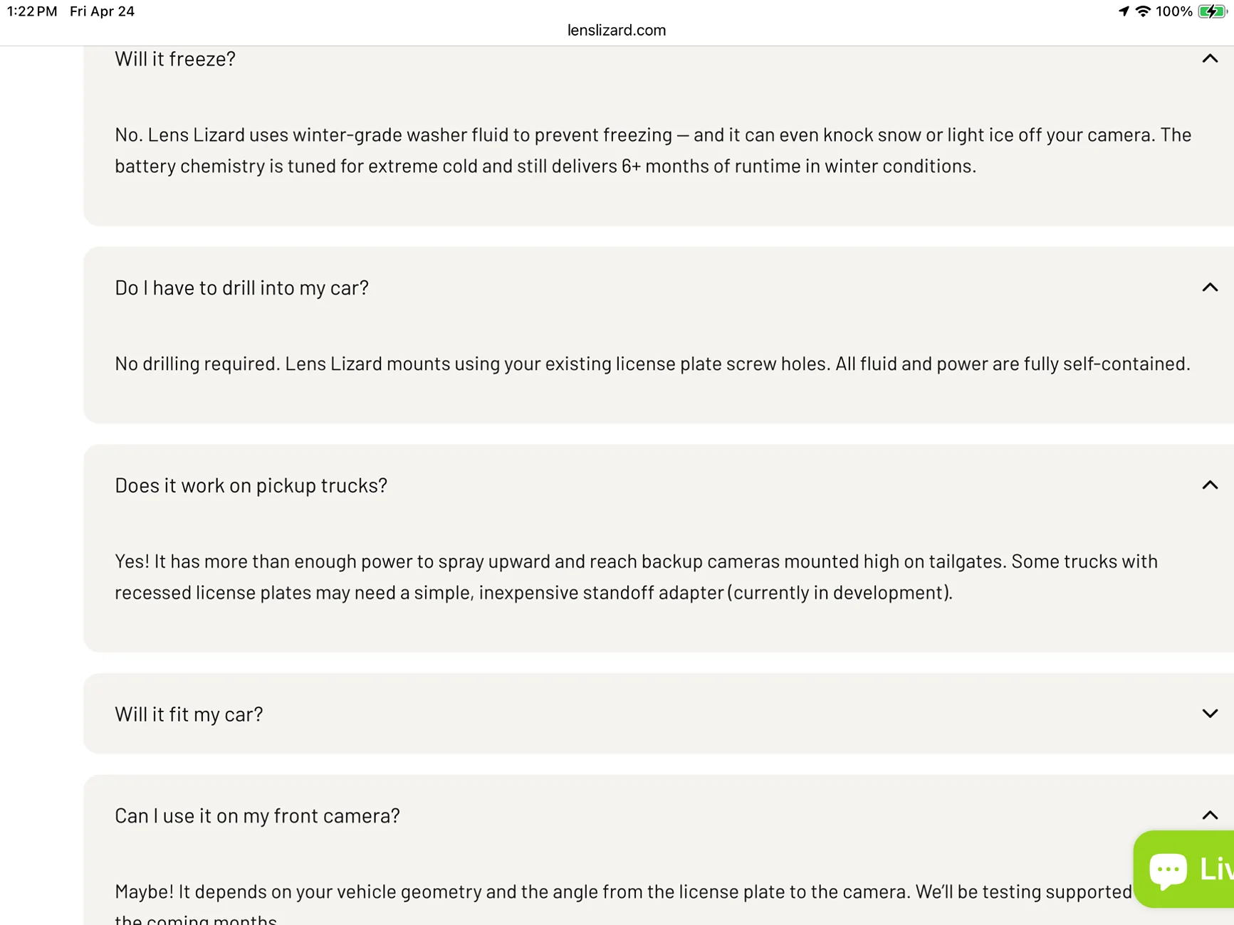

I don’t think they are on the market yet. When I traded emails with the inventor, he mentioned they had developed a mount for the CT to address it. He drives one and said it worked well. I'll follow up when I get mine in the fall to confirm.

I emailed back & forth with him. Because the license plate is is extremly recessed, it has to be extended a LOT, which makes the whole thing look goofy.. its a kickstarter, videos here:
