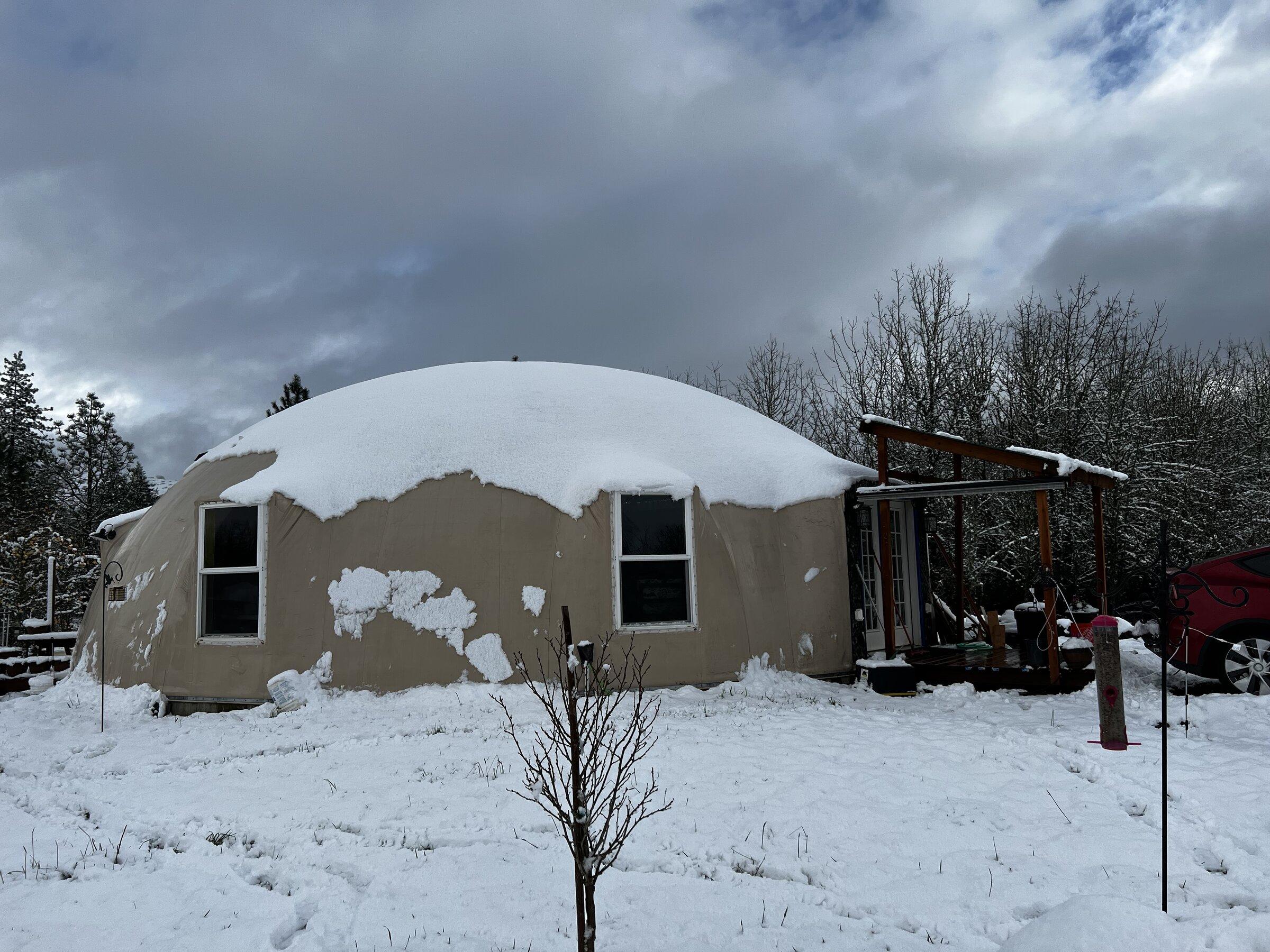

Pessimistic… I’m converting to solar/ off grid capable, live in a bunker-like concrete dome, and drive a truck I can self fuel and drive anywhere.

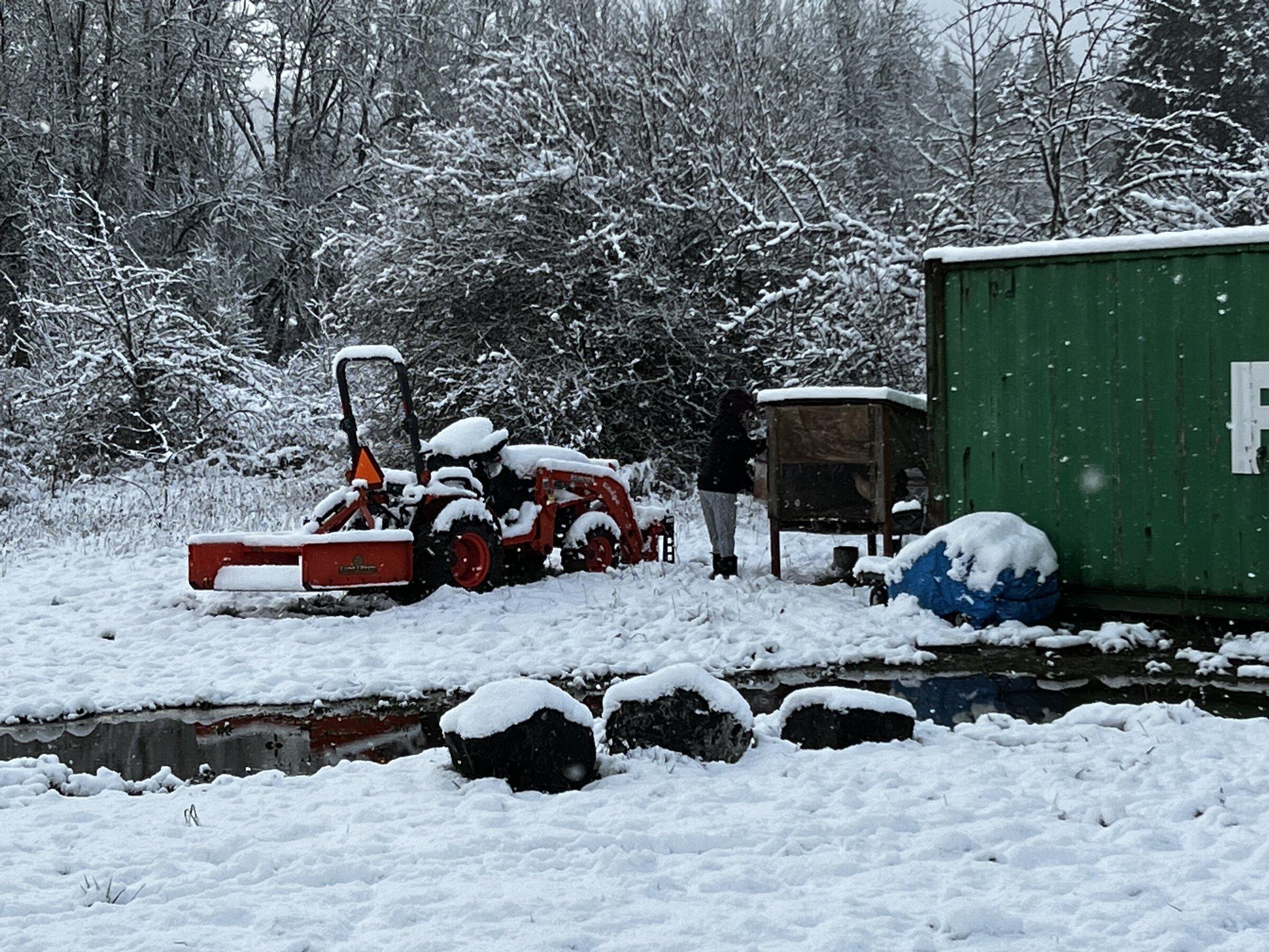

Either plan, I’ll still want our Kubota capable of diggin in the dirt.

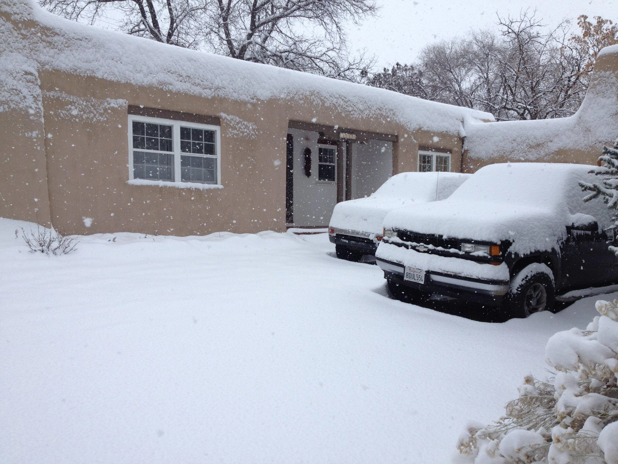

Looks like the Tesuque NM place we had. 14” thick adobe walls would cycle ~8hrs holding temps comfortable @7000 feet elev.
A concrete dome; ceiling fan & a pellet stove would do .v. central air which ate propane $108/mo. in winter. Love the Kubota plan to dig your way out of jeopardy. Pack rats killed our back-to-Nature greenhouse. Man we dumped the bucks on nice plants for those rats!

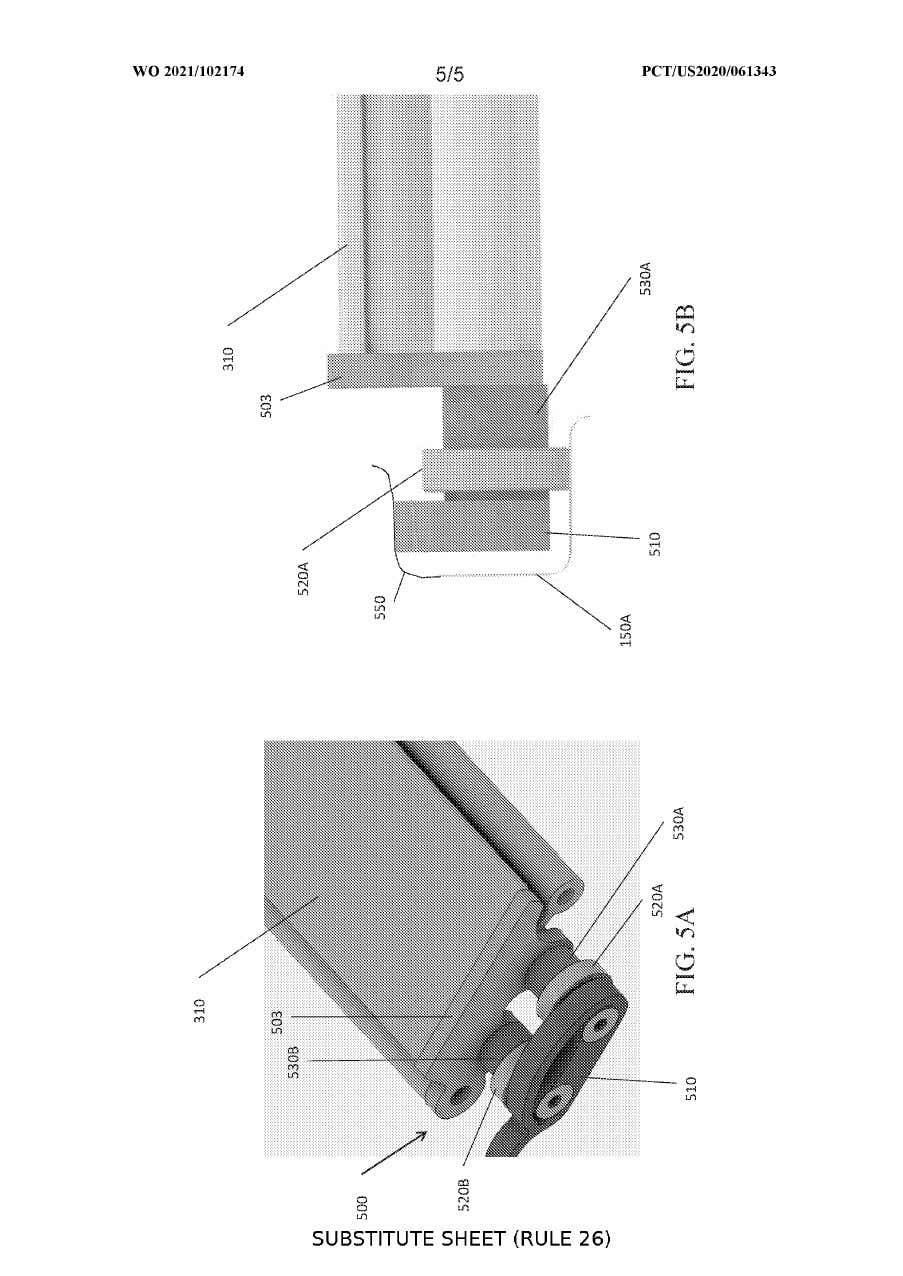

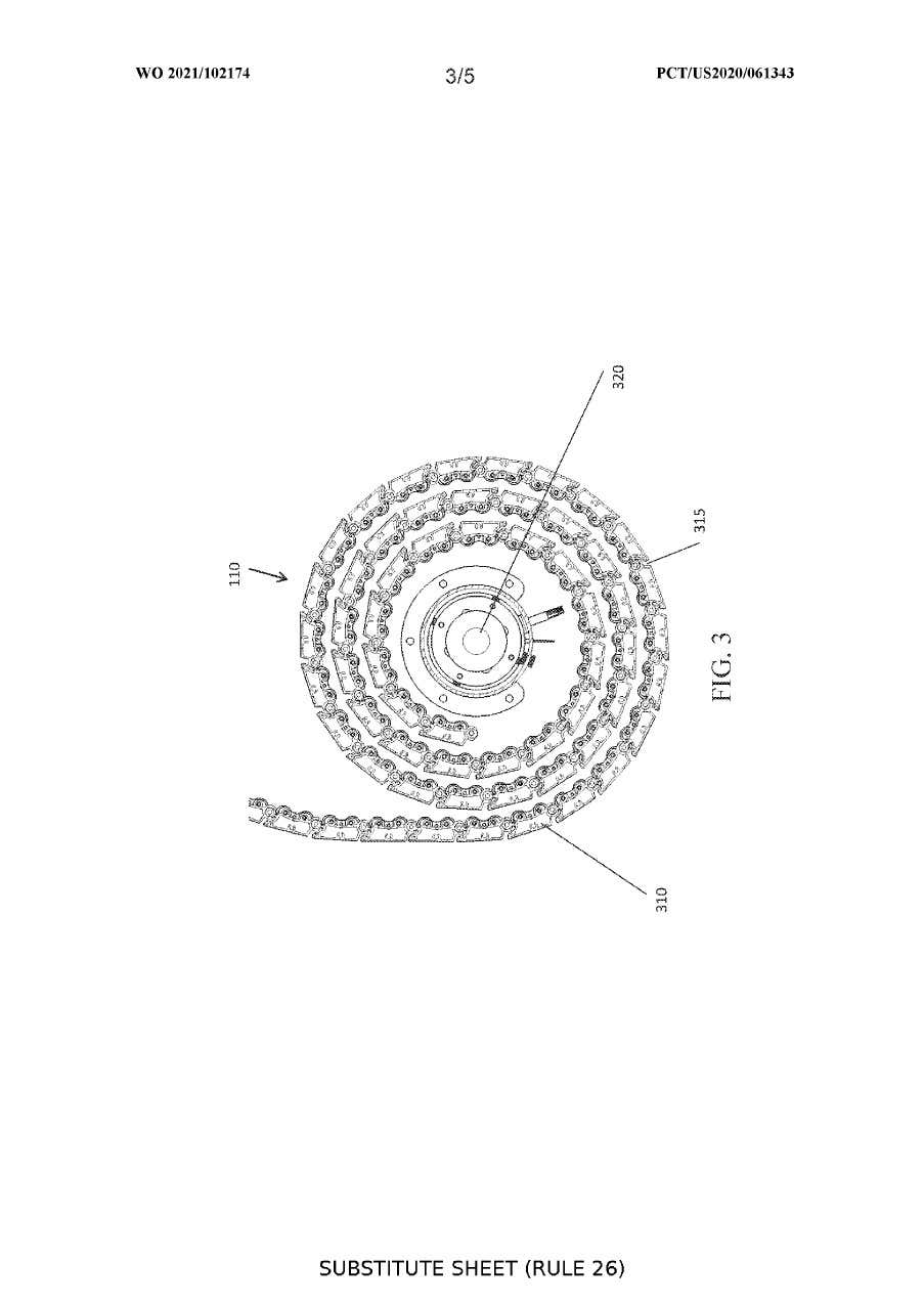

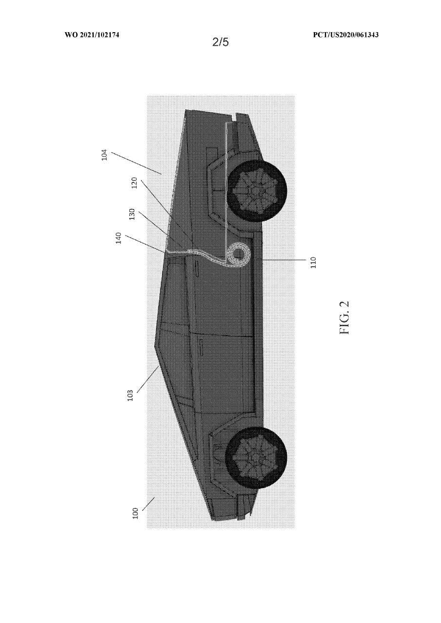

As to over-lapping edges correctly, that's true. But I'm not sure why you think the Tesla tonneau will not have proper overlaps. You may be a retired general contractor, builder, and professional roofer, but I bet you have never engineered a roll-top tonneau cover! Because you can't tell how much overlap was used by looking at photos. The overlap is often placed out of sight and the water is designed to run in channels just under the top surface where it can exit through front/rear drains that exit under the vehicle.
For example, look at the rain seals where your side windows enter the metal part of the door. There is a rain seal there but it doesn't overlap and water can leak right past it into the inside of the door. The point is, the water is managed and drained out the rear of the door without getting your stuff wet.
