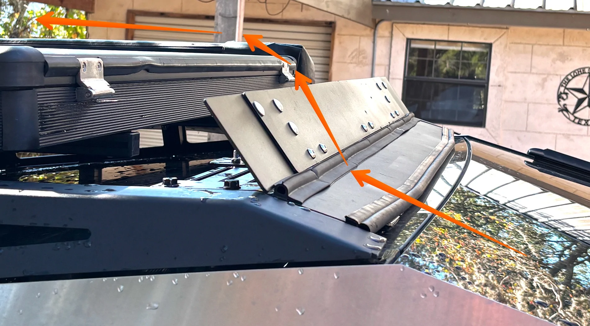

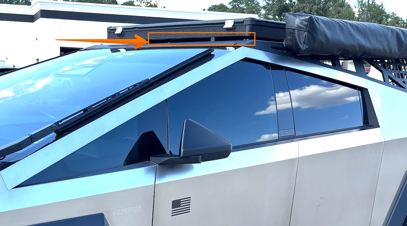

Do you know if the wind noise is more pronounce when the tent is up close to the fairing?
I didn't test it without the Victory 4x4 fairing and the tent moved back. I only tested it with the two setups pictured below.
I believe that most of the wind noise was happening from wind going under the RTT:
Tesla Cybertruck Roof Rack, Tent, Awning, and Wind Fairing setup on my Cybertruck under
The Victory 4x4 wind/tent fairing + the Mars Wind Deflector was the magic bullet that took literally all wind noise away. There's no place for the wind to go other than up and over the truck/tent! 😊
