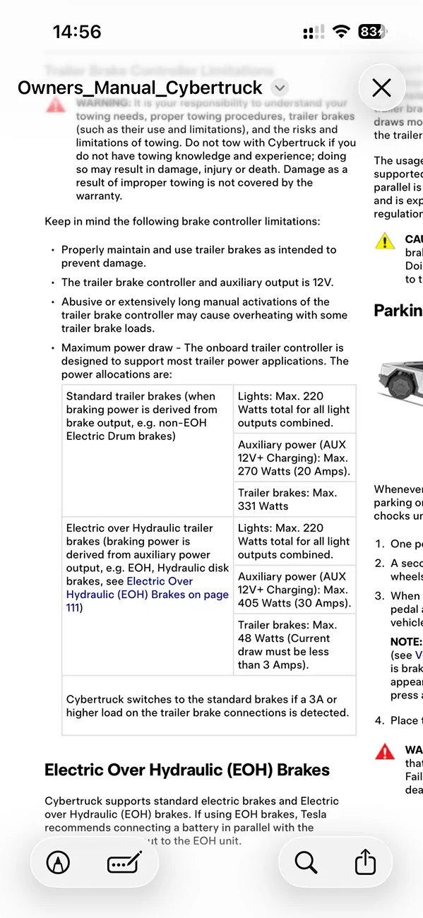

I have a 12v VIAIR compressor from my jeep days that I'd like to use with my CT. Seems like the best 12v source for this would be the auxiliary power pin in the round trailer connector. Has anyone bought an adapter for the trailer connector to use this 12 volts? Anyone know the current limit? Is the 12v aux power always on or does the CT somehow see the trailer connected before turning it on?

I'd be worried about the amperage. It depends on your 12v compressor, but some are 30+ amps. The trailer 12v source doesn't have wiring that can support 30 amps... or really even 20. The USB ports don't come close that wattage. You'd be best off getting a 120v AC to 12v DC convertor and running off that.

Care to back that up? Here is a screenshot from the owners manual
The owners manual would have that correct, and I stand corrected. More than that would not be advised. So would then depend on the compressor and amperage draw it has.
